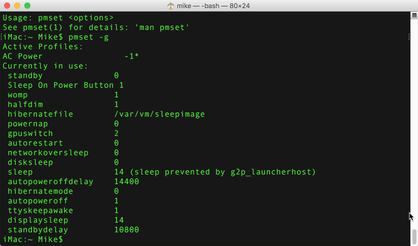

OP, here's what I have and as you can see standbydelay is not 4200, I'd recommend you do change that. Clearly the 4200 is having an effect and I have a fairly clean install. I did a clean install of OS X a month or so back and have not upgraded to Sierra. While you may not want to change that value, I believe its that cause and the solution is at hand
Please note that you have standby value set to 0 therefore standbydelay doesn't apply, does it? So in theory your system should behave exactly the same as mine and enter hibernation=0 mode when you put it to sleep, right? And from manual pages:
I haven't messed with any of the settings, and I have no problems with the computer waking up. My point is that you may need to adjust some of the settings to get the results that you want. I think there's no other explanation other then the pmset values are set in such a way that its giving you this issue
I changed standby value to 0 and that seems to fixed my problem. Although I still don't know why it was happening. But I'm not gonna spend more time trying to figure it out. I can now focus on issues "introduced" in the latest versions of macOS and iOS...

Crap! Now I found that my iMac wakes up automatically after every 4 hours (if there's no external drive connected), which is exactly what is set in autopoweroffdelay. Ok, I'm turning off autopoweroff "feature".
