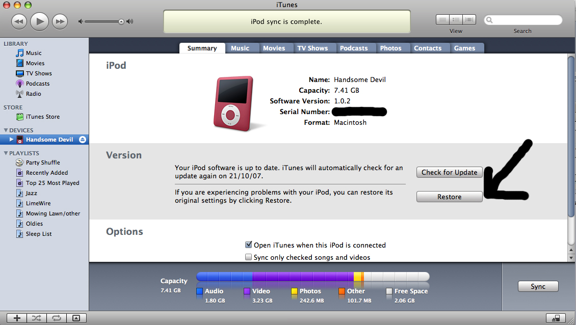

If you can get iTunes to respond to it. Try pressing the button 'Restore'
If that doesn't work then I'de say your best bet is to send it back to Apple. (Keep in mind I am no iPod/Mac/Apple genius)

Well, when i plug it into my mac, the iPod gives me the Do Not Disconnect screen like it should, but its not being recognized by iTunes.
I just plugged it in again and itunes recognized it saying it was corrupt so im restoring it now. Hopefully it works.
Edit: In the middle of restoring it said "Could not restore because the iPod appears to be busy." The hard drive is wheezing when its plugged in.

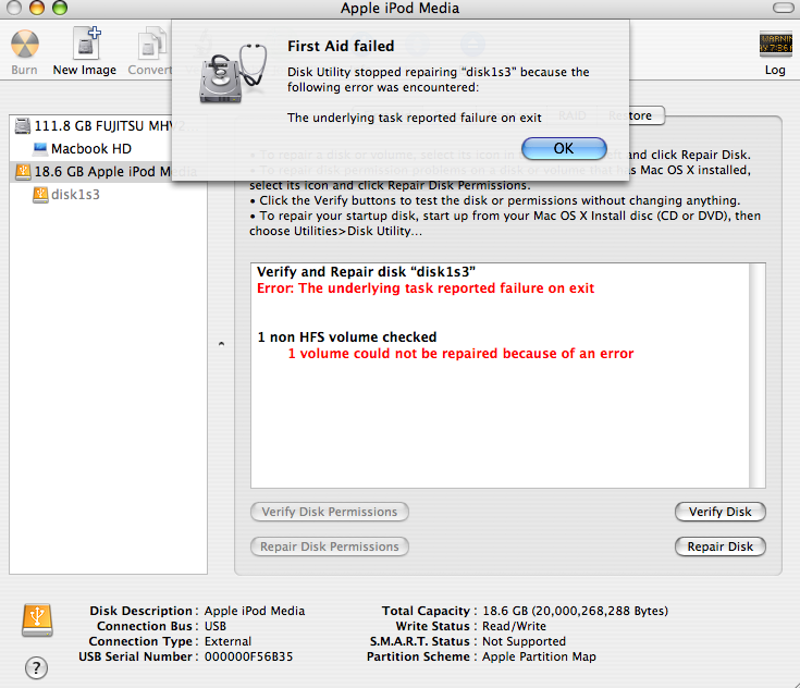

On your mac, Go To The Applications Folder, Then go to Utilities, then double click Disk Utilitie. Click on your iPod, and click repair disk. This could help. Then try to restore it using iTunes. Do this while your iPod is in disk mode.
i had the same thing happen to my 4th gen ipod and all I did was open it up and disconnect the hard drive for about 10 min or so (really can't remember exactly how long), then reconnect it and restore and it works fine now.
just something to try, unless you're scared of opening it up. I was before I tried it, but i fugured i had nothing to loose- it's not going to be any use if disk utility won't even fix it.
