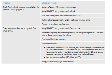

Here's what the CD that came with my LaCie suggests for problems.

Gary - I appreciate all of your help! Ok, so - I was able to get my back up drive up and running and recognized (which makes Time Machine happy). But my drive that I used for all photos/video, etc. is still not showing. However, I went ahead and connected it up via USB....it shows fine. But, when I daisy chain it back up....she doesn't show again. So - good news and bad news. And hey - at least Disk Warrior optimized both my drives 🙂
