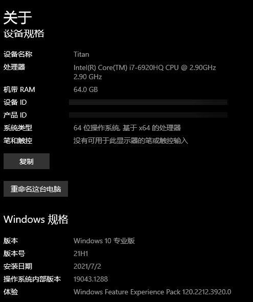

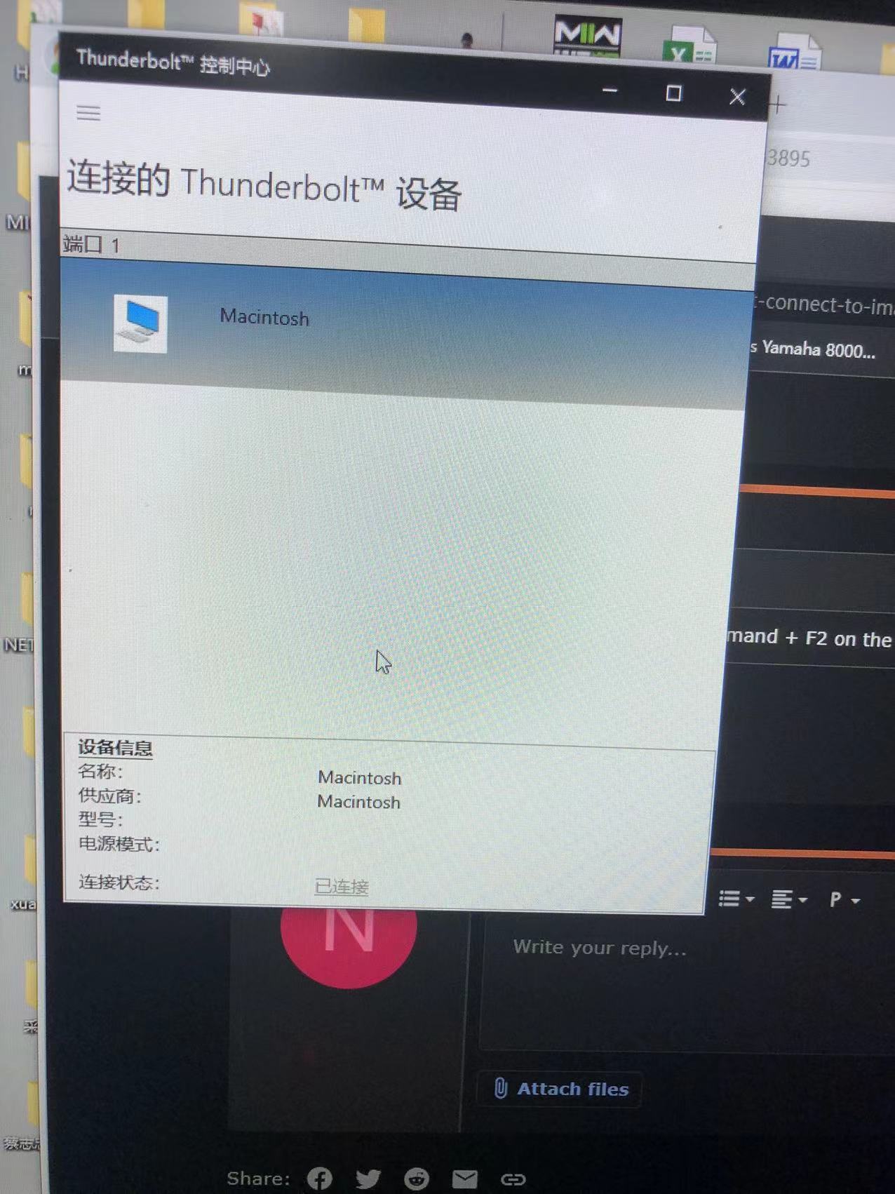

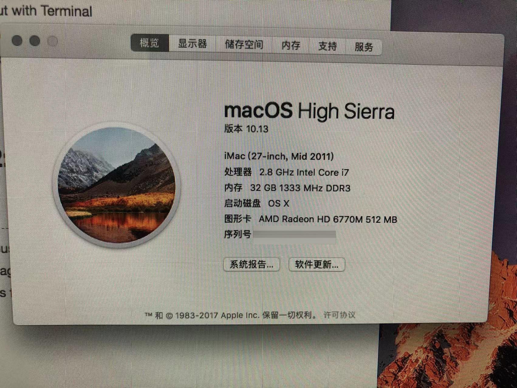

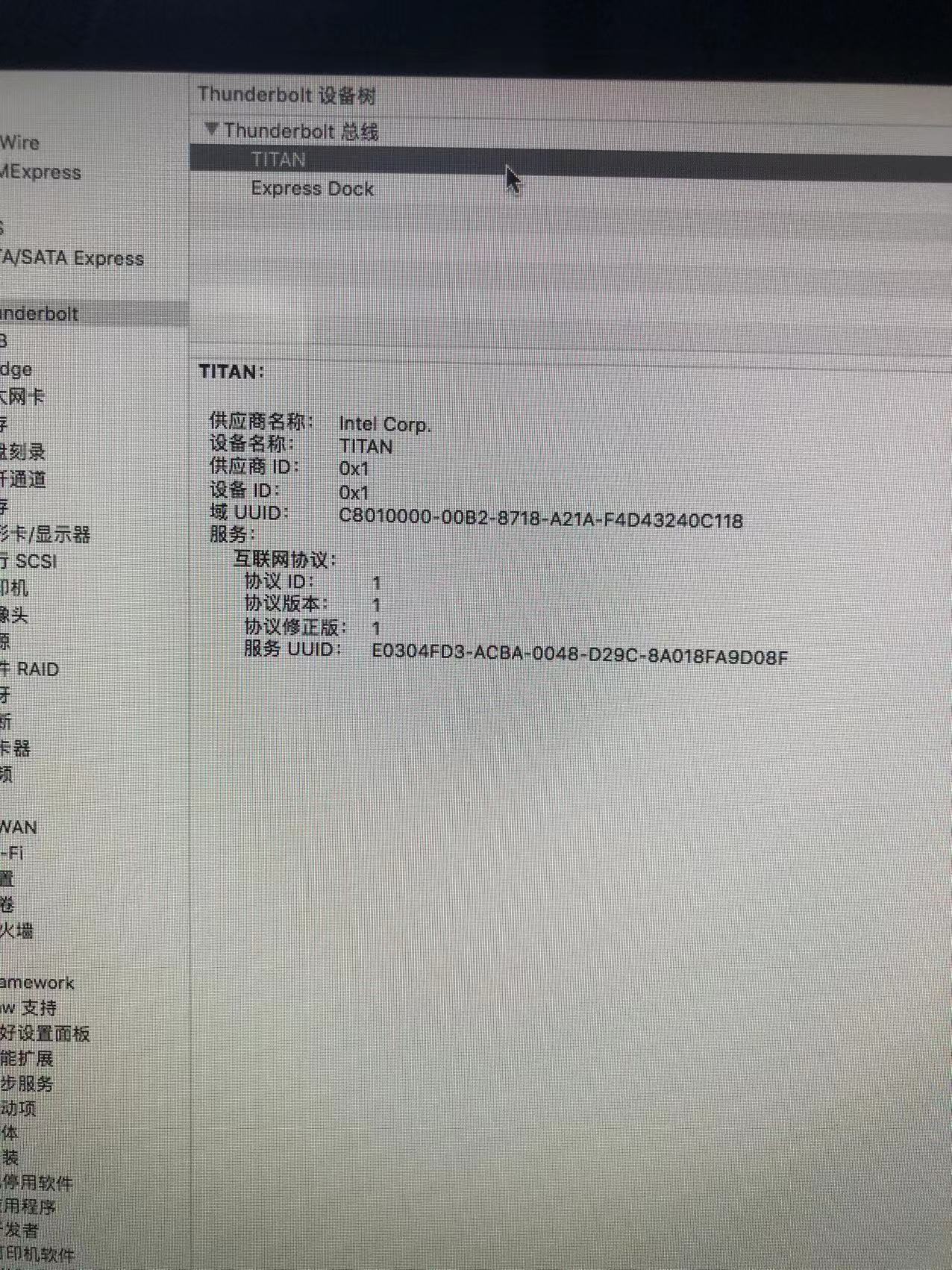

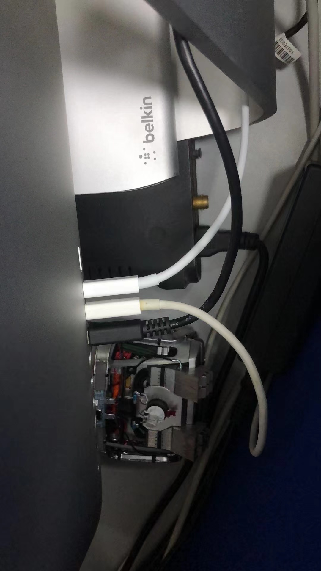

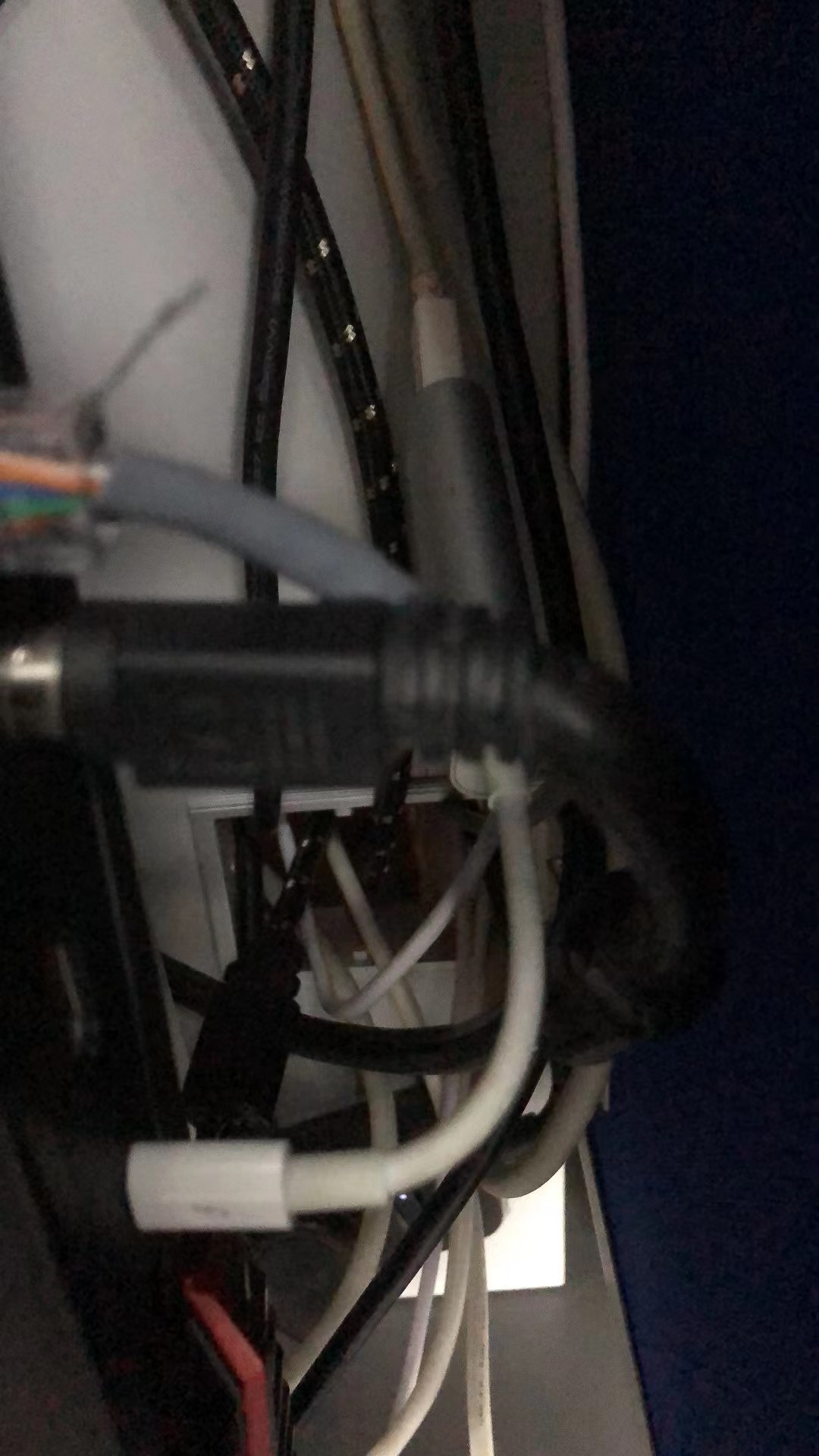

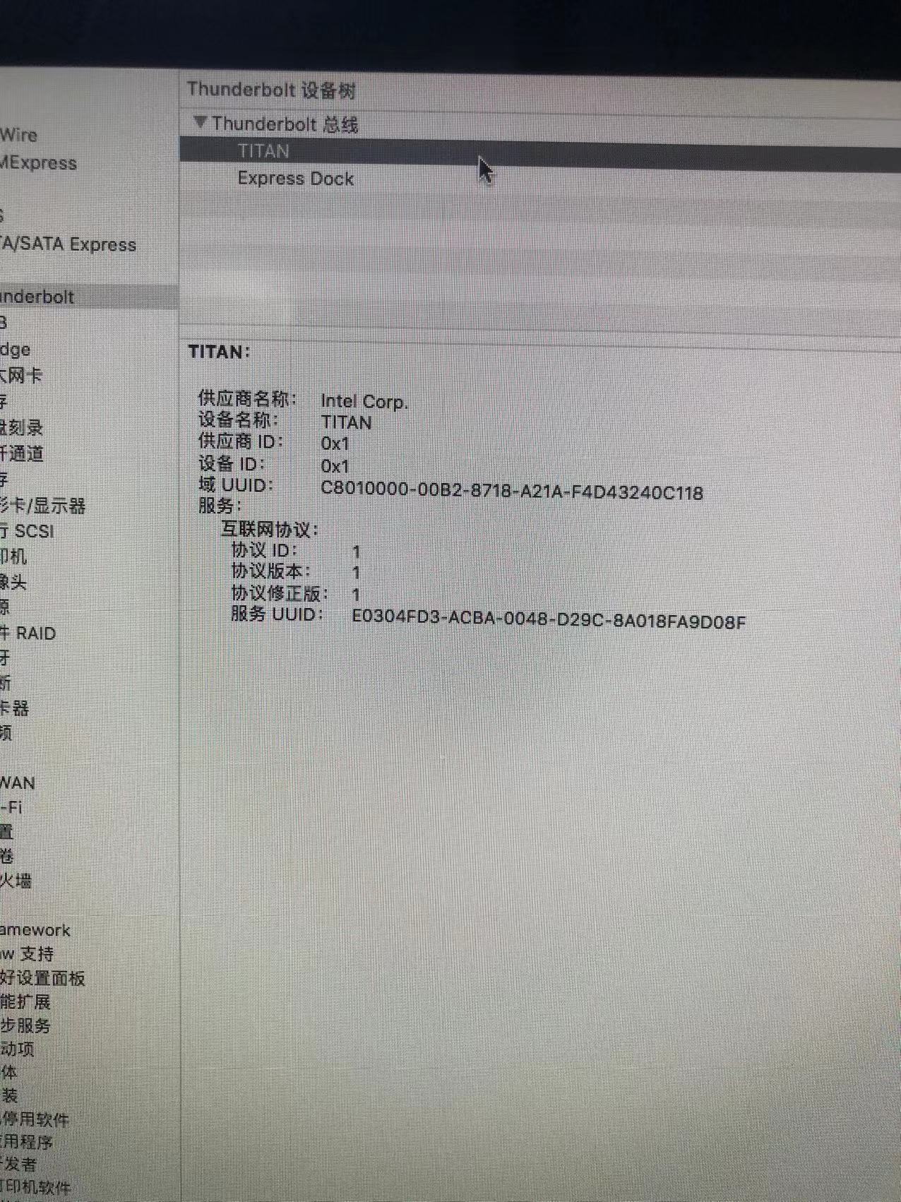

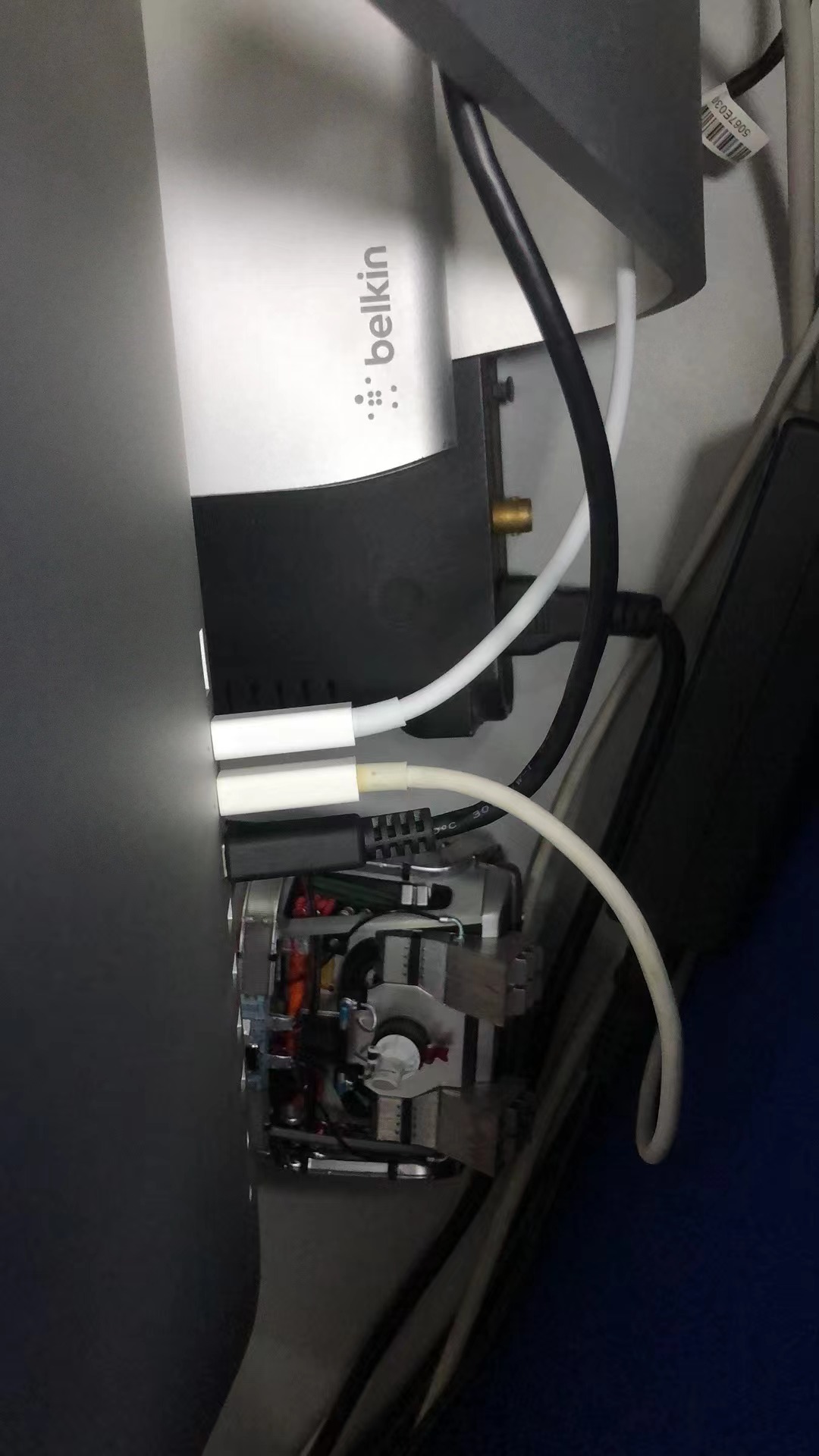

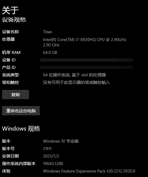

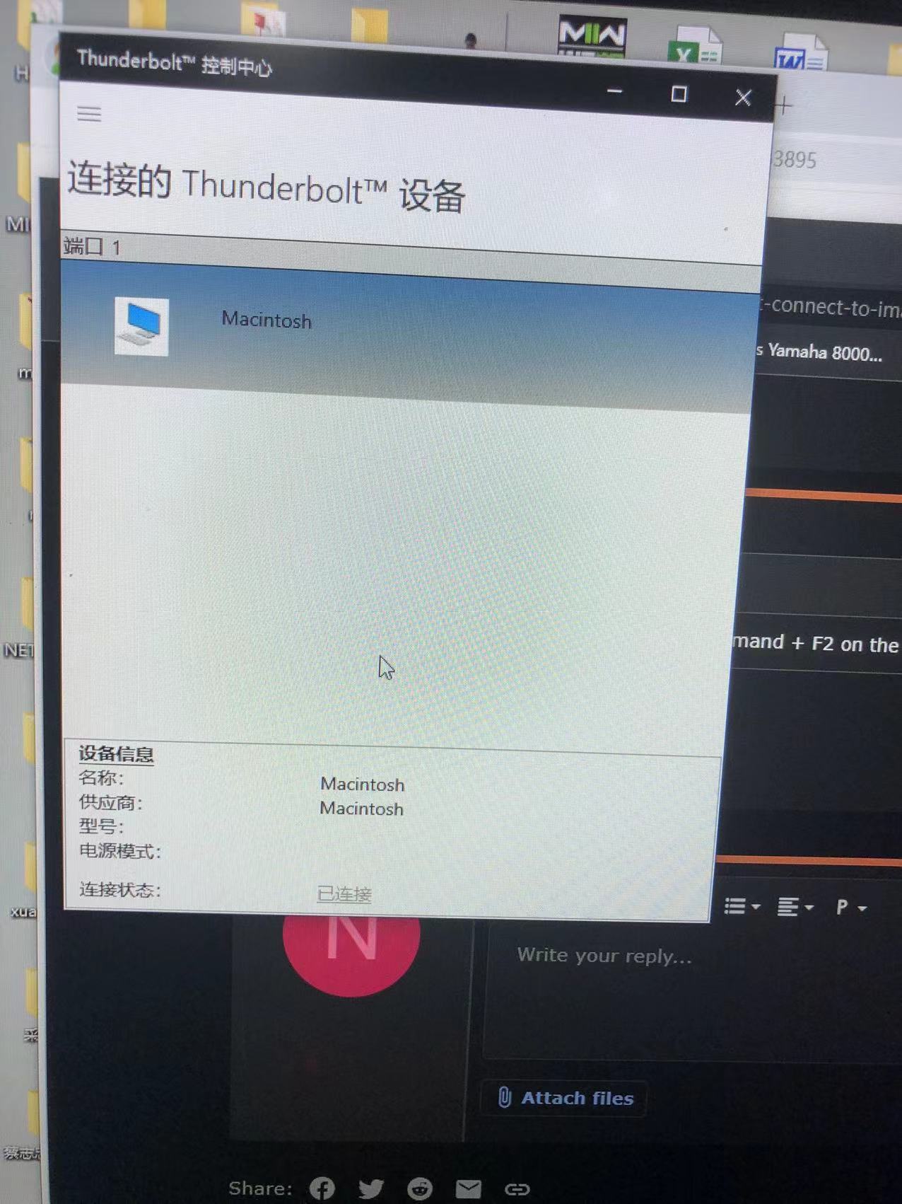

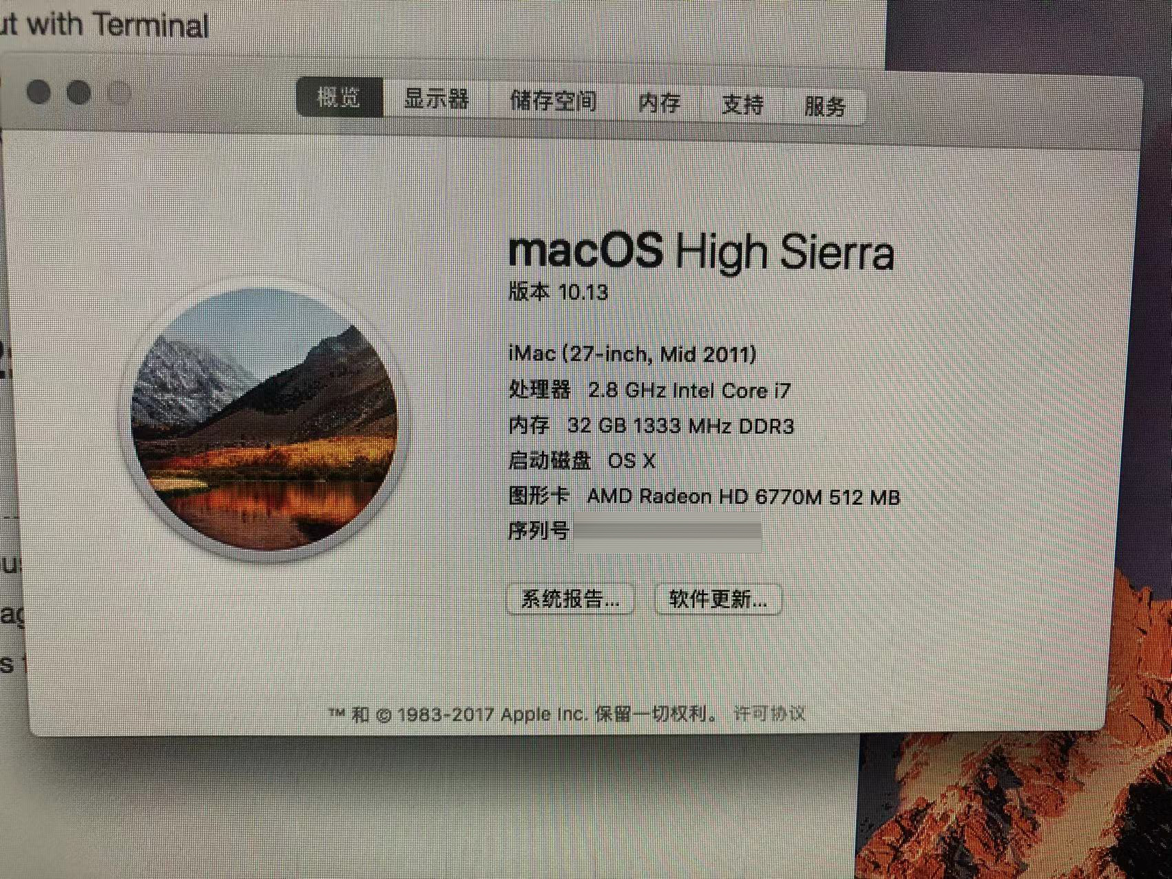

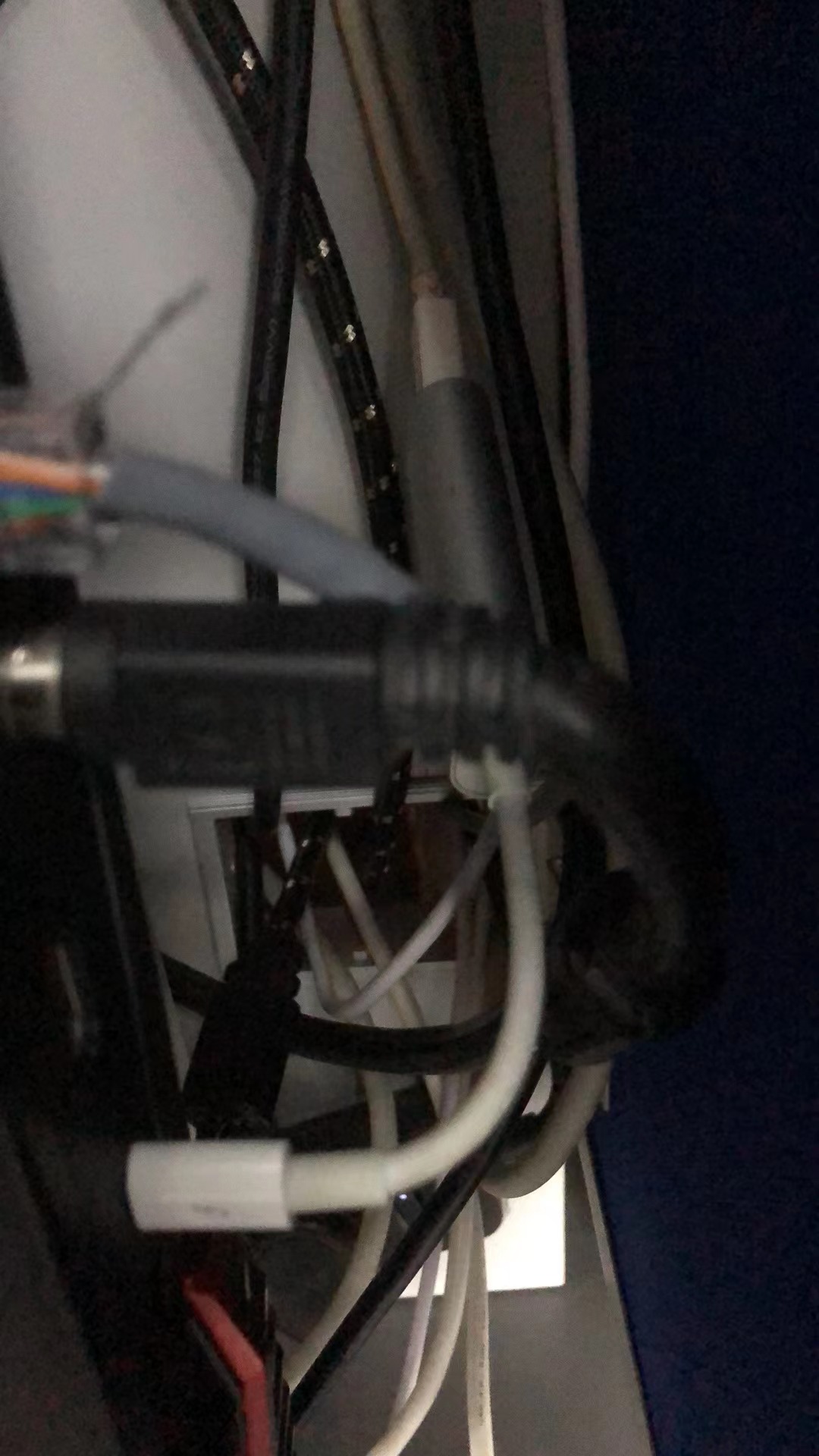

Hello, everyone, I have a MSI GT83 6RE laptop and an IMAC 2011 A1312. I connected the two devices with Thunderbolt cable. Now I can see that IMAC has been connected in GT83, but I can't start the target display mode on IMAC. Does anyone know how to solve this problem?
