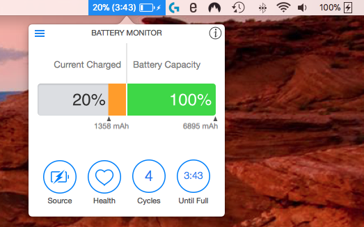

The dock has 85w which is enough to keep it charged. On the phone with the support for the dock and they said shouldn't do that. Even with hammering it. Whats odd is the O/S is showing 100% but the App I downloaded shows it accurately at 13% now.

Per Elgato, it is not normal behavior. Especially when it's idle. I saw it charge, then it stopped charging, charge, then stopped. The built in battery meter to High Sierra still shows 100% which is false. No idea why it's showing that when the dock is connected. See screen shot.
Have you tried an SMC reset? I would trust the High Sierra indicator personally.
The high sierra indicator is wrong. Like I said, if I unplug the dock, it goes to whatever the other meter shows as %. If I plug it back it in goes to 100% and starts draining even though it shows 100%.
Before you login it shows the correct % of battery life. Only in the top bar after you login it's not. Makes no sense or is a bug.

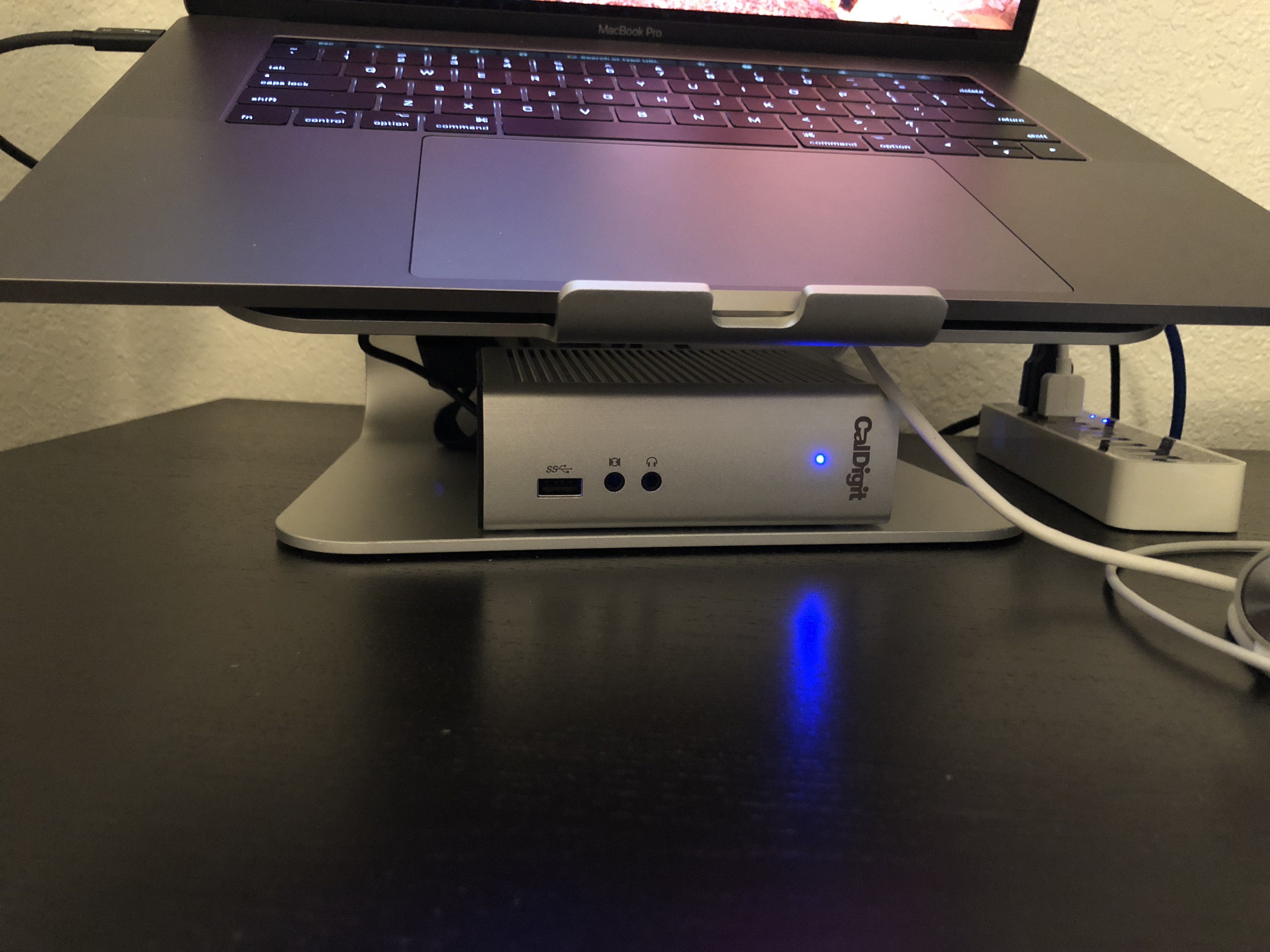

Got my Caldigit TS3 in today, and all is well now. It keeps it charged at 100%, the O/S reads the correct reading now. The Elgato either had an issue, or the cable wasn't good/correct that came with it.
I returned it to the owner on Ebay and getting my money back. Wasn't impressed with it though compared to the Caldigit which to me is better built.
Here is a picture. 🙂
