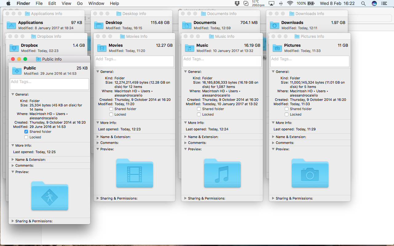

I've been trying to free up some space on my laptop, a MacBook Pro 13" from 2012, at the moment when I go on Disk Utility I see that I'm using 217,13GB on a total of 498,89GB available space, even if I already transferred so much files on my external HDD, the thing is that I have no idea where all this occupied space come from, because what I can see is this:
Applications: 9,73GB
Desktop: 115,49GB
Documents: 711,2MB
Downloads: 1,97GB
Music: 16,19GB
Pictures: 11,4GB
Movies: 12,28GB

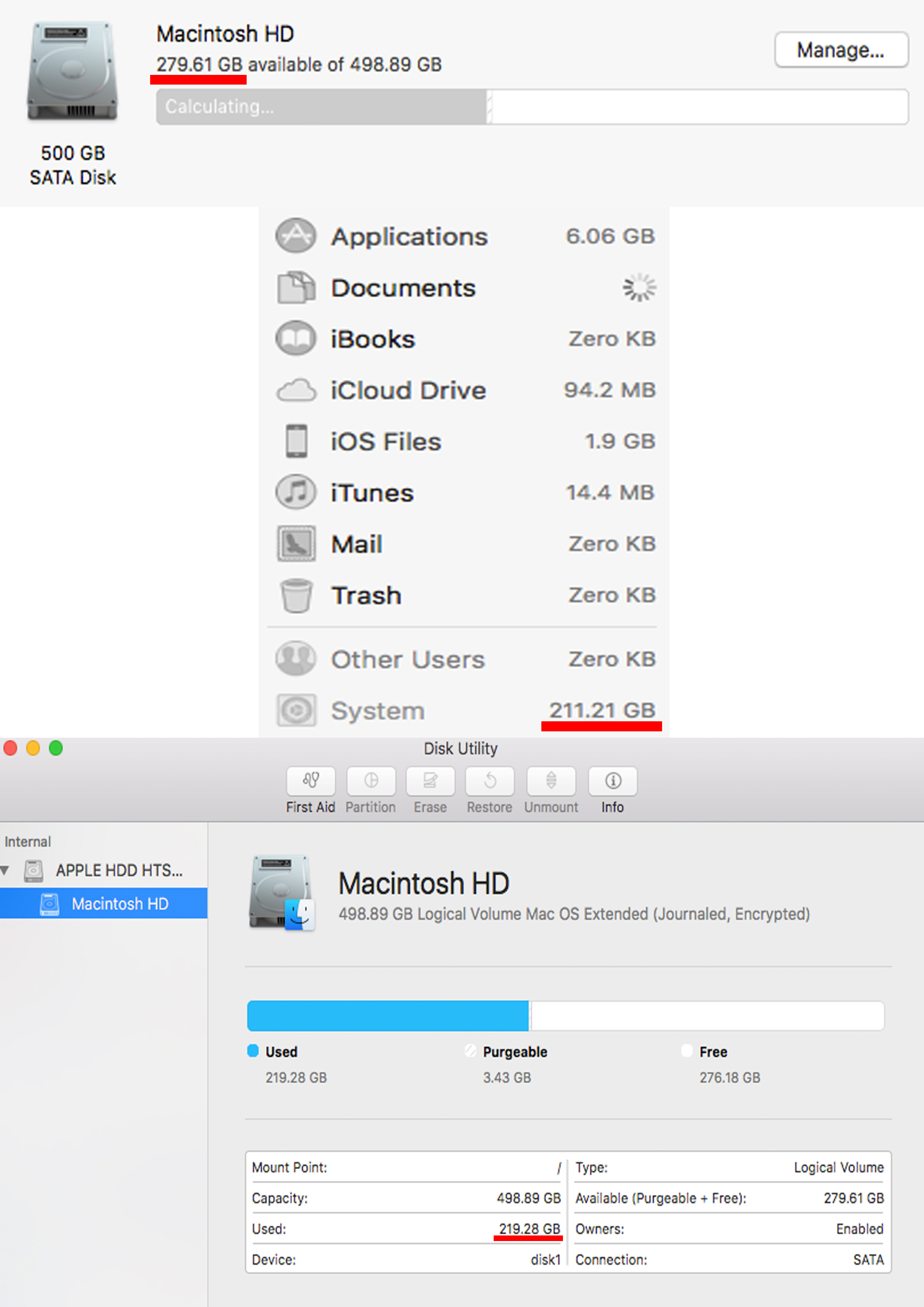

Which is a total of more or less 167GB that I'm using... but when I go on About this Mac -> Storage -> Manage I see this:
System 215,12GB
Can please someone help me out with this issue?

My problem is that on Disk Utility it shows that I have much less space than I actually think to have...
Because after checking all the folders and after I transferred files on my external HDD I should have much more space...
Look the picture:

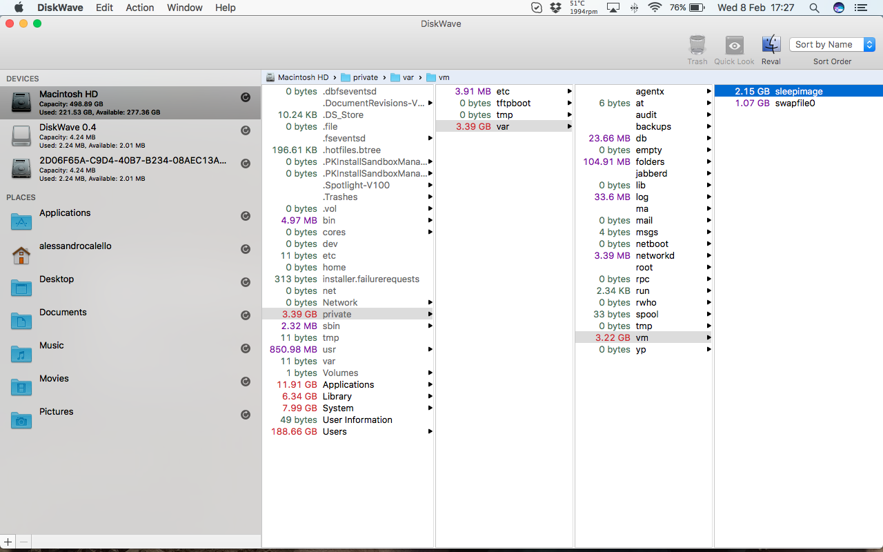

Thanks man, this app, is great... but there are some things which I'm not sure I can delete...
Regarding the images posted above.
The 2.15gb "sleepimage" file DOES NOT have to be there. It exists to support the "hibernation" feature that preserves what's running on the desktop (from loss if the battery runs out).
If you're not concerned about this, here's how to correct it with terminal:
First, disable hibernation mode :
sudo pmset -a hibernatemode 0
delete /private/var/vm/sleepimage :
sudo rm /private/var/vm/sleepimage
create an empty file and name it 'sleepimage' :
sudo touch /private/var/vm/sleepimage
change his flag to immuable :
sudo chflags uchg /private/var/vm/sleepimage
Now, OS X won't be able to rebuilt over your sleepimage file since it is locked.

Second image:
Looks like "Steam" is using up A LOT of space -- almost 18gb in that folder alone.

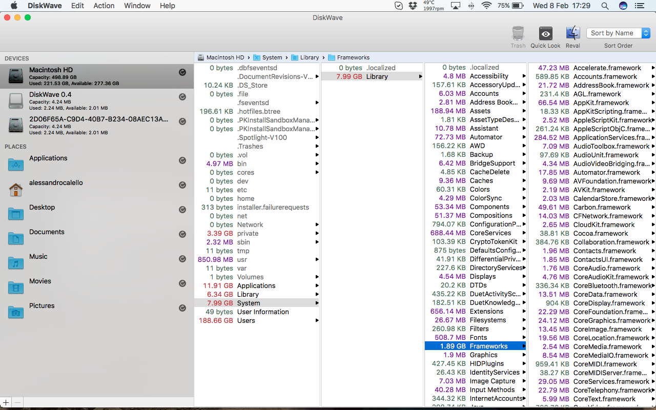

Third image:
The "Frameworks" folder doesn't look particularly out-of-line.
Your biggest problem is in your "users" folder.
188gb being used !!!
For what ???
