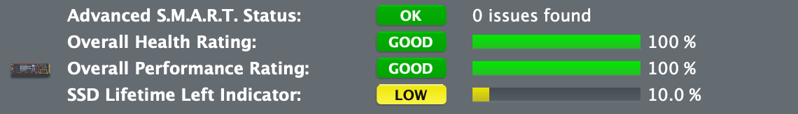

My FD was on the verge of dying earlier this year -- specifically the SSD portion which was seeing massive, massive amounts of wear. Turns out the way a Fusion Drive works just hammers the SSD with reads and writes. When you think about it, this makes sense: the OS is continually migrating whatever files are seeing more or less use back and forth between the SSD and the HDD. And the SSDs in Fusion Drives are typically quite small, which makes them much more susceptible to wear, there being way fewer memory cells to do all the lifting. It's a shame, because theoretically the Fusion Drive buys you the cheap capacity of an HDD and much of the speed of an SSD -- but in practice longevity seems to be the price you pay.
Here's what mine looked like when I decomissioned it: 10% lifetime left according to DriveDx. Another utility I tried showed similar results. I didn't wait for it to finish dying.
I opened the machine up, pulled out the SATA HDD -- which was still going strong -- and replaced it with a SATA SSD. It's possible to replace the blade SSD, but it's much more involved (there's a great thread here on these forums all about it) and frankly SATA was fast enough for me.
Opening up the iMac 5K is no joke, but the kit and documentation from iFixit helped a ton. I pulled it off in maybe 2 hours, going really slowly and carefully. Total cost was maybe $250 including the SSD and the repair kit.
