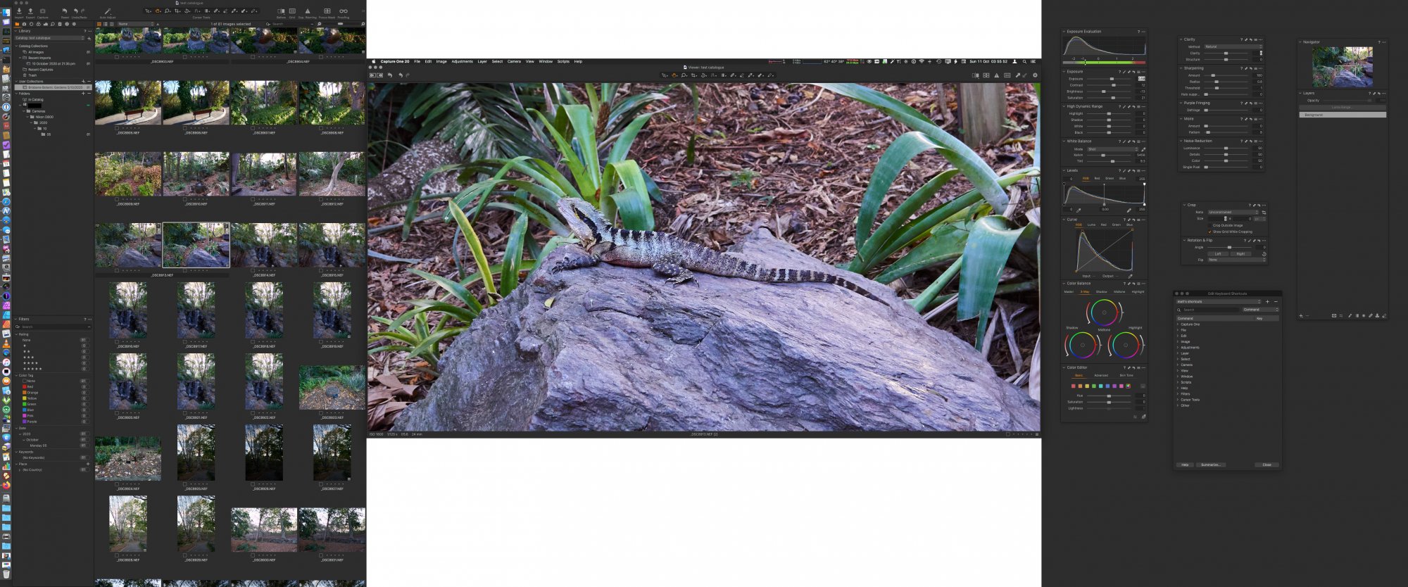

Hello friends. I recently added my old 23" Cinema Display to my Trashcan in addition to the main 27" Eizo. I'm using the apple DisplayPort adapter. I got it set up just fine and mounted vertically on a nice new dual monitor stand. Suddenly after a few reboots (latest Mojave) my arrangement gets forgotten and it thinks the Cinema Display is my main screen. I have to re-do my screen arrangement and drag the task bar back over. I reset p-ram and nvram and PMC. Sometimes it remembers and I think it is cured and then on the next restart it forgets again!!
Has anyone had any similar issues? Thanks for your time.
