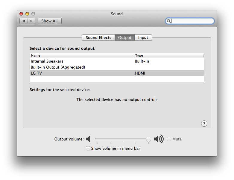

Open System Preferences>Sound>Input, are there any output devices there.
Example below in screenshot.

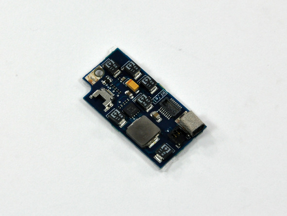

I post this just to show you the air has a separate sound board, if later on we come to the conclusion that the soundboard or Audio cable is broken you could look here how to fix this.
MacBook Air Models A1237 and A1304 Audio Board Replacement
The above is for the Audio board, below is the repair page for the whole machine:
MacBook Air 13" Models A1237 and A1304 Installation Guides
But, don't know if this board also provides audio out to the headphone jacks, you can look and see for yourself.

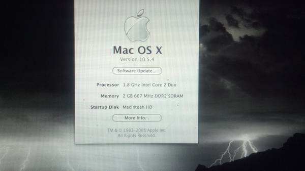

Problem. Im on the Mac now and I click < System Preferences > and nothing opens up. It goes from < Safari > to < System Preferences > up at the top left, but no windows or anything open. So I click on View then click on Sound but nothing opens. When I go back to View, Sound is ' check marked '. Im pretty sure Im the administrator or what ever, so idk whats up??
:::::EDIT::::::
I need to do a software update - Front Row Update Version 2.1.7 (13.8MB) Mac OS X Update Combined 10.5.8 (768MB)
I have tried installing the updates 3x's now and it always pauses/stops at some point during the update. I went to bed and when I woke up it hadnt moved at all. It stops at different points of the update I noticed. Maybe I have a bigger problem than my sound not working...?
