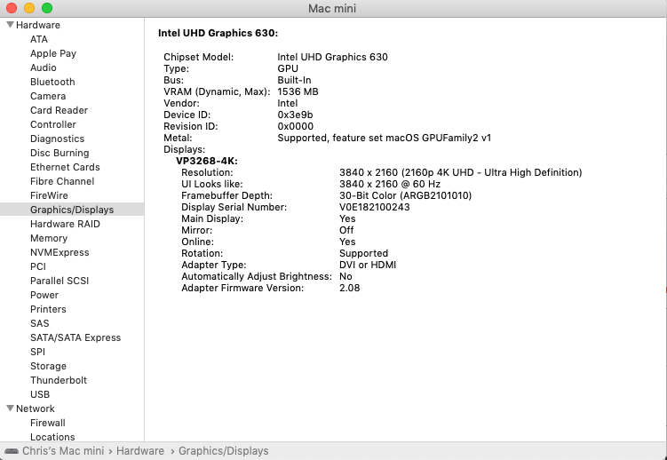

I have a new 32" VP3268-4K Display by ViewSonic hooked up to my new Mini.
It's a little squinty at some points, but I can manage with increasing font sizes where I can.
I tried the other scaled resolutions and didn't care for them at all.

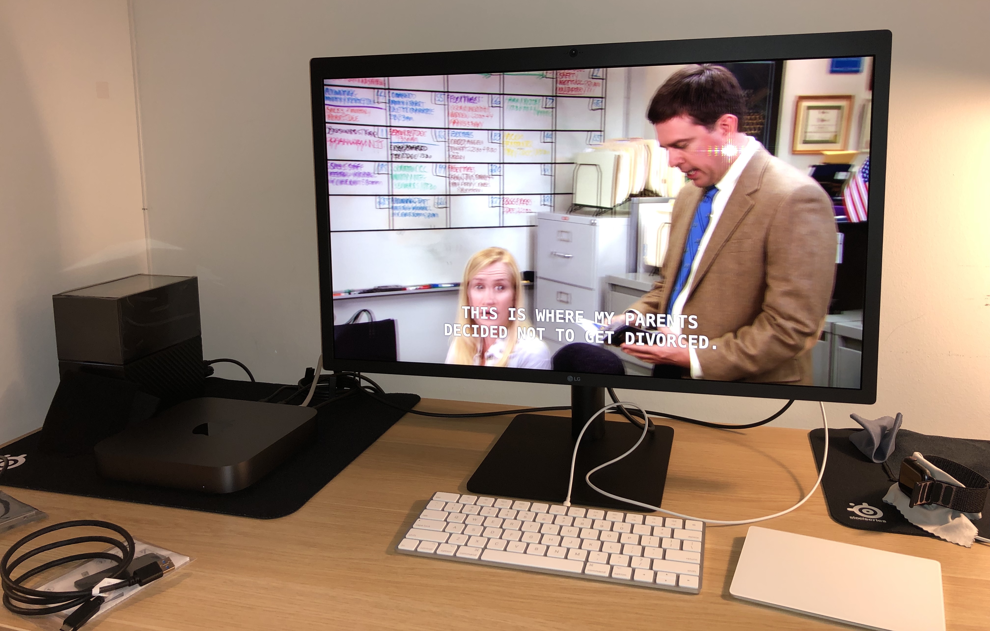

Connected my LG UltaFine 5k to the Mac Mini today. Black screen - backlight is on, but nothing is showing. Tried on my MacBook Pro, but that didn't work either. Not a great first experience. Returning everything and reordering. Will report back on this if it works! 🙂

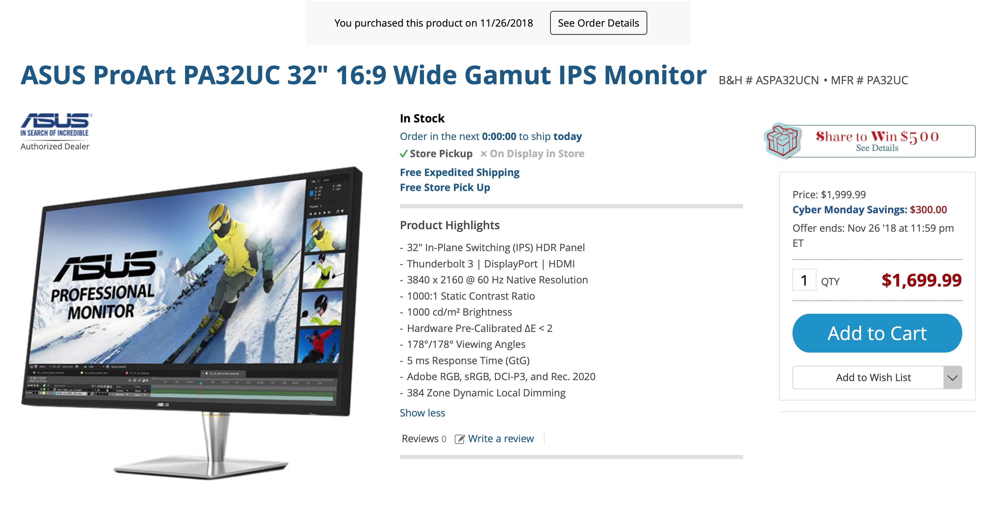

My monitor hunt is finally over. This evening, I settled on Asus's PA32UC, a fairly new 32", 3840x2160 monitor that covers Adobe RGB, Adobe sRGB, Rec. 709, HDR and Rec. 2020. It’s helpful that it also supports Adaptive Sync/FreeSync.
B&H has a Cyber Monday price on it until midnight that provided just enough of a break 🙂 I'll pick it up in the morning.

Made an account to say that Im currenty running two Asus PA27AC which is the 27 inch counterpart.
The monitor is a great choice! Running two thunderbolt daisy chain and experience has been really smooth.the back buttons kinda feel cheap for the price but the panel is awesome with the blue light settings. 1440 looks perfect on this.
