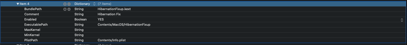

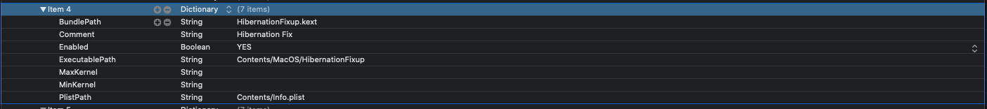

I am using OC so it works well there, but I also had issues using native OSX.
It seems like bugs in Catalina, as a lot of people are complaining about it. It has to do with the weekly logs from screen time. I've been wanting to try OC but I'm a little nervous with trying for my first time on my main machine.
I just “took the plunge.”
This is the first time I’ve had a boot screen on my RX 580 so that’s neat.
Edit: And I got night shift back! It’s been gone for a few updates now.
