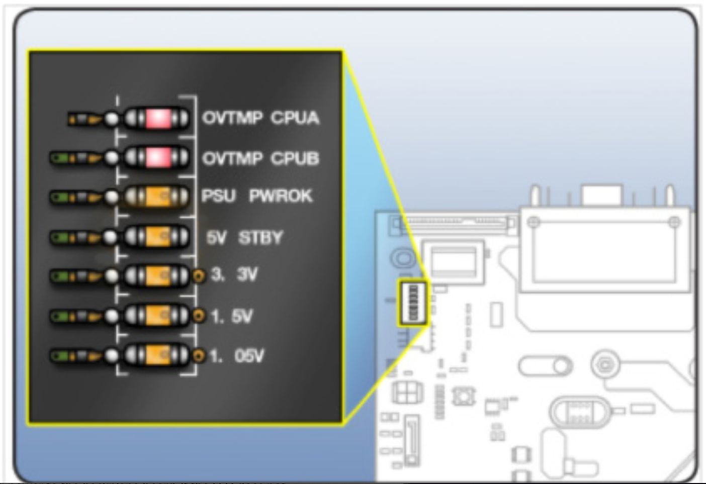

With the Mac Pro connected to the mains power, check the diagnostic LEDs and see where the failure is. Could be a dead PSU or even a bricked BootROM, DIAG LEDs will help you narrow it.
Start with page 28 of Apple Technician Guide for early-2009 Mac Pro.
