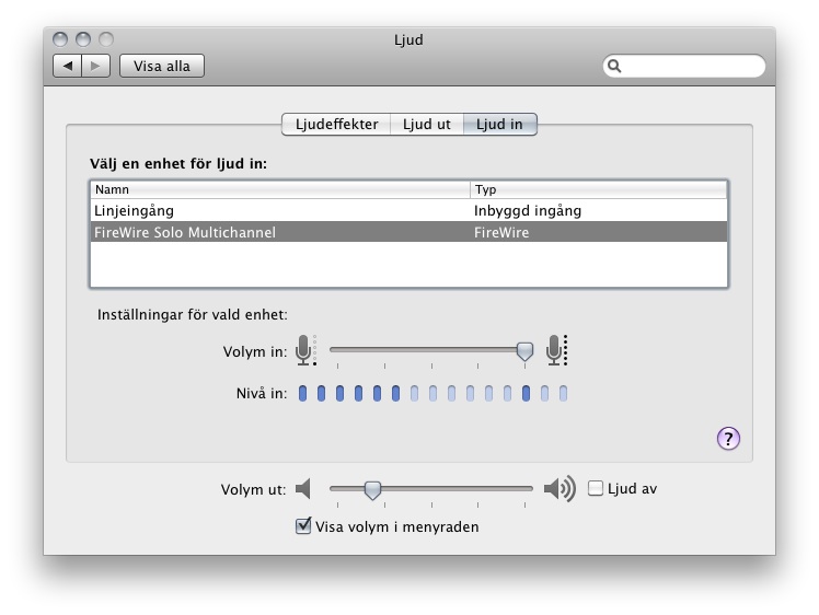

In the sound preferences on audio in, does it have an audio gauge so you can check if it's reacting to input?
Here is my audio prefs with a Firewire interface, when I send it signal from my keyboard you can see it reacting, showing blue.

No, the audio gauge isn't showing anything, it just says that the device has no input controls. (The volume control gauge doesn't even come up)
