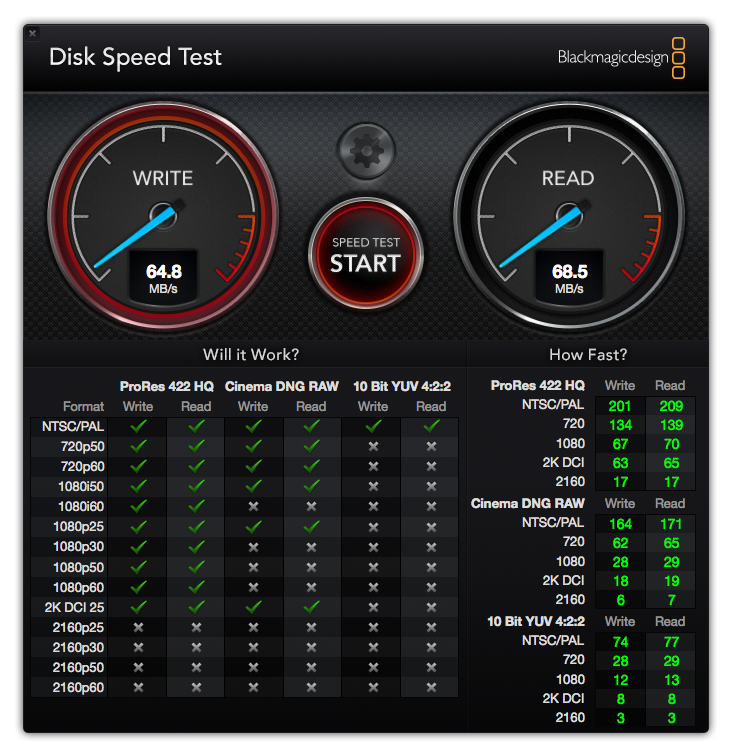

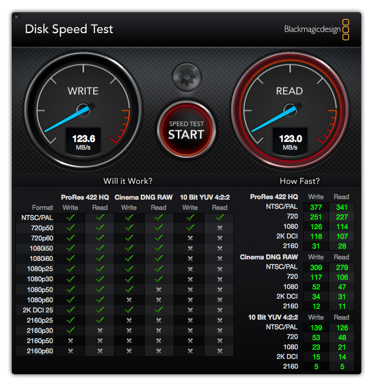

If it helps, here are drive benchmarks of our Mac Mini 2011. Upgraded internal vs Firewire 800.
Internal drive: WD Black 500GB (7200RPM, 32MB cache). SATA link speed 6Gb FWIW.
External: Seagate Momentus 5400.6 500GB (5400RPM, 8MB cache) in a Firewire 800 case.
(For reference, the original Apple (Toshiba) 500GB drive used to benchmark close to this.)

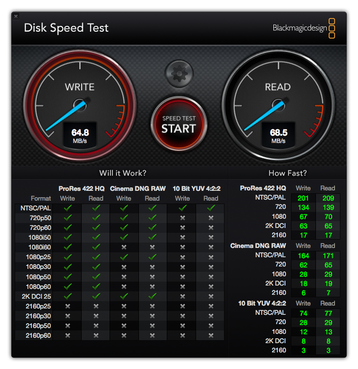

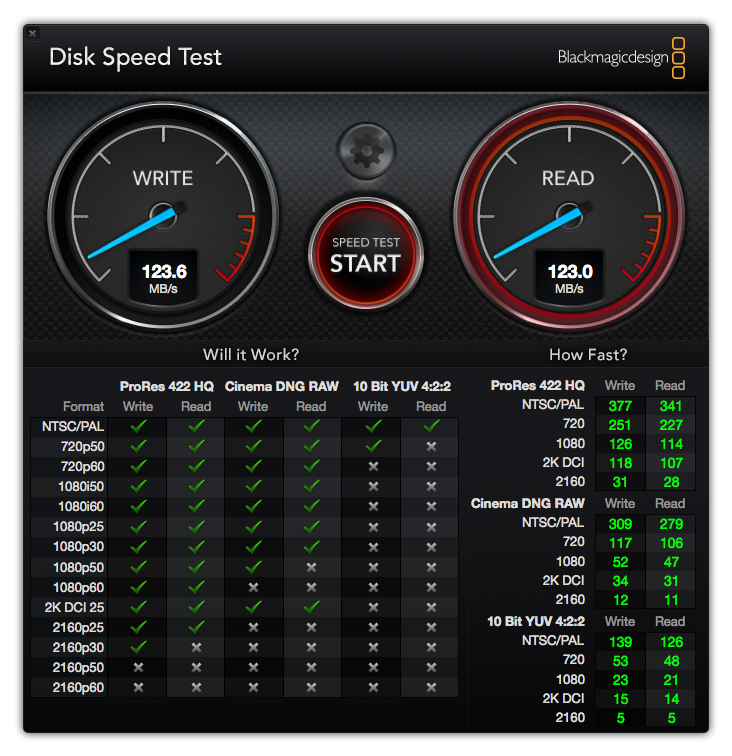

Wow so the internal HDD is twice as fast as the external firewire 800 drive?
