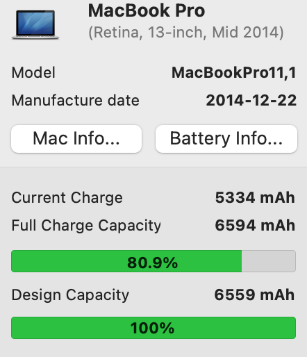

What is the full-charge capacity of the battery?
Was the Air ever dropped or exposed to liquid?
The Full Charge Capacity shows:
Current Charge: 238 mAh
Full Charge capacity 6422 mAh
3.7%
I fully drained the battery as im trying to cycle the battery again, maybe thats why its showing these numbers.
It has a small dent at the top left part of the laptop, where the charger goes. But i already replaced the IO board of the laptop.
