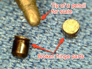

    Thats exactly what I was thinking. This is the part that broke, very small and doesn't look like it can take too much pressure before breaking off and letting the screen open flat:

  4. uberamd thread starter macrumors 68030
    uberamd
    Joined:
    May 26, 2009
    Location:
    Minnesota
    #4
    Just thought I would update: 23 hours later my on campus Apple Authorized Service Center replaced the display assembly, free of charge. Now that's service.

    I had the same thing happen I guess about a month ago. Apple just replaced the hinges which I though was odd. Nice and tight now with no more max tilt.

    Are people getting new screens or just repaired hinge?
  10. xparaparafreakx macrumors 65816
    Joined:
    Jul 29, 2005
    #10
    Getting a new screen. Apple Service Manual list the screen, housing, hinge and iSight as one part. No way to get hinges alone.
