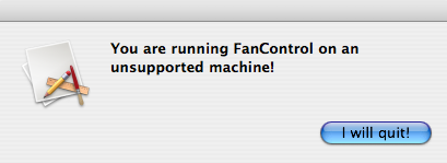

I deleted tht app and now my fans never stop.......... HELP ME! Please
NO NO NO NO NO NO NO!!!!!

Reinstall the app...... Or shut the computer off. Then turn it back on as it resets the SMC data the program changes.
