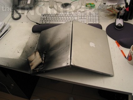

As in, not safe enough to carry on an airplane? I do kind of have to take it back to get it replaced though.... and they don't have recyclers here. 🙂
Damaged Lithium Ion Batteries are not supposed to be loaded onto an airplane, cargo or passenger.
The chance of a problem are slim, but then again I wouldn't risk it.

I took it on the plane anyway. Good thing it didn't explode. I'll be going into the Apple Store later this week. I'll let you all know what happens.
lol.. I think people really need to think before they come up with theories. Such as using your phone on a plane...
but ya.. keep us updated!
Has using a phone in flight ever caused any problem with anything? Probably not.
Has a damaged LithiumIon Battery ever exploded? Yes. Is the chance of a problem very slim? Absolutely.
