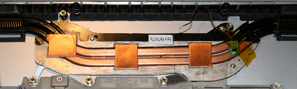

Heat may rise , but the major heat generating components (Chipset, CPU and GPU) are situated at the top "bar" and extend a bit in between that and the qwerty row keys with a very extensive cooling infrastructure to take care of it.
Heatsinks + heatpipes are placed on top of the components and routed to the ends of the back vent to 2 heatsinks and cooled off by two independantly rotating fans...
And yes, if you put a pillow right between the display and the bottom chassis you might be able to get away with the heat being pushed out towards the user but I would estimate impending doom.
Now, being aluminum and such, keyboard warmth might be a by product by assosiation, especially being situated between the hard drive and these components, but I doubt apple designed them as Macbook Pro w/ hand warmers.

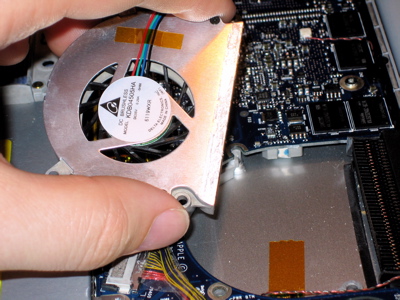

i kust replaced my thermal pasting...
i was soo fkcing scared no joke.
i broke my laptop on the way (sueprdrive tray or w/e)
it's all good tho i don't care about superdrive since it still works, it's just that that metal thing around it is broken/stripped out
but yea, my temp now is 44 C at 1999 RPM fan speed
... the major heat generating components (Chipset, CPU and GPU) are situated at the top "bar" and extend a bit in between that and the qwerty row keys with a very extensive cooling infrastructure to take care of it....
The Chipset, CPU and GPU are located approximately under the 3-4 keys, the 5-6 keys and the 8-9 keys, not at the top bar. While by design, heat is vented through cooling pipes to the fans and out the back, heat does dissipate through the keyboard. It doesn't take a rocket scientist to figure this out... just hold your hand over the upper half of the keyboard and you can feel the heat. And the only reference to a pillow was placing the MBP ON a pillow, so the pillow or books or table or lap would only be in contact with the bottom enclosure, where there are no vents.
