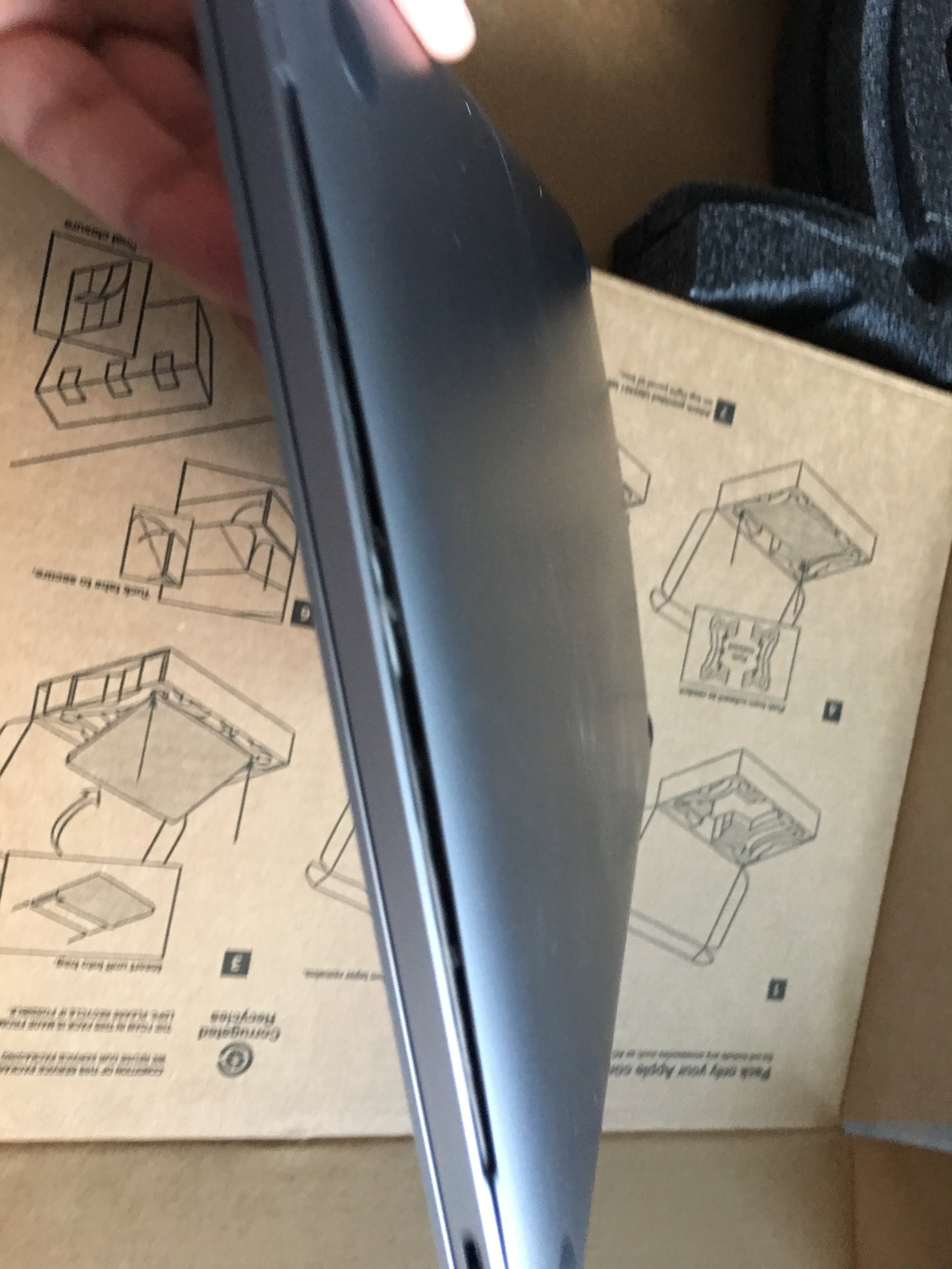

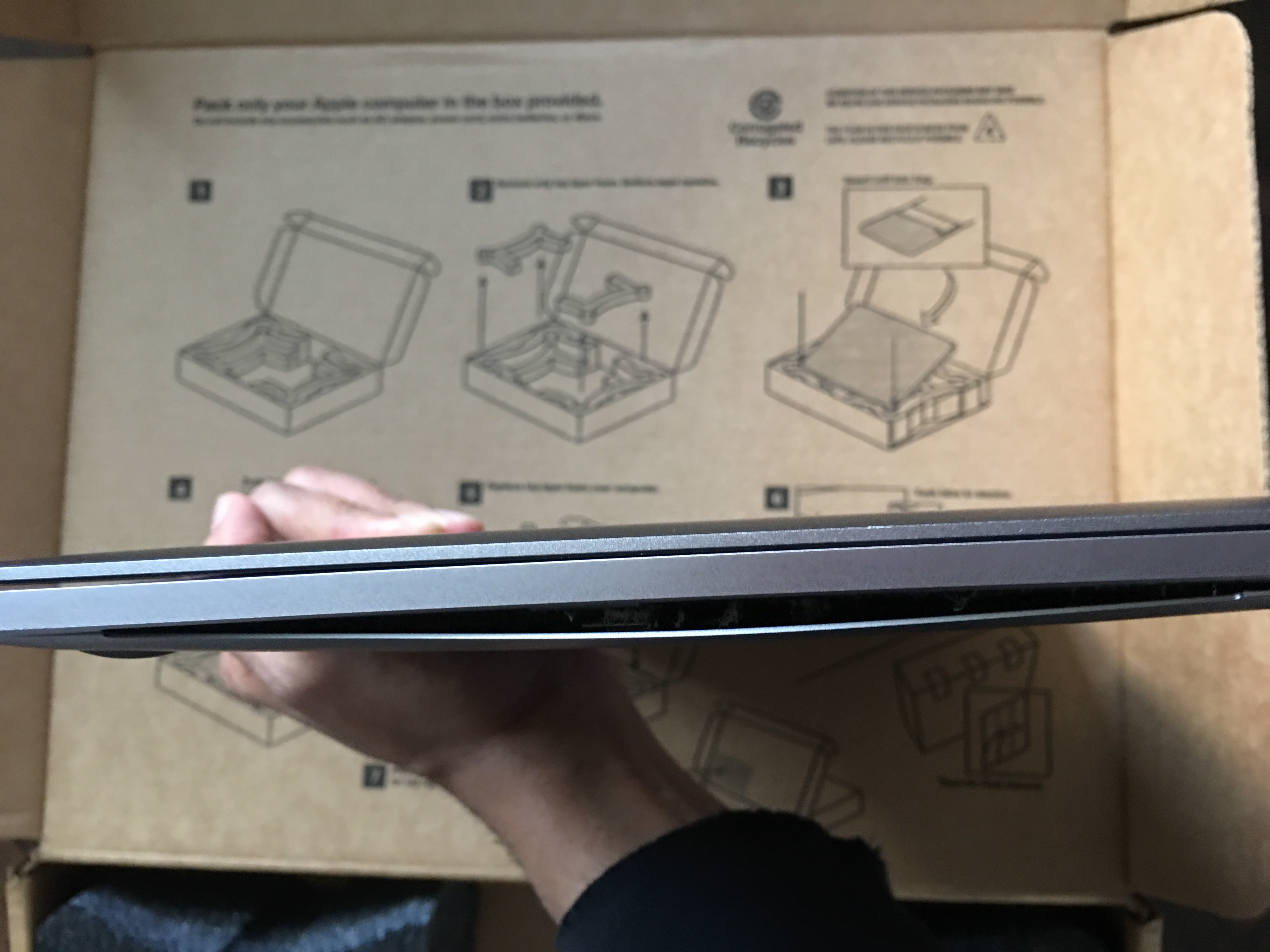

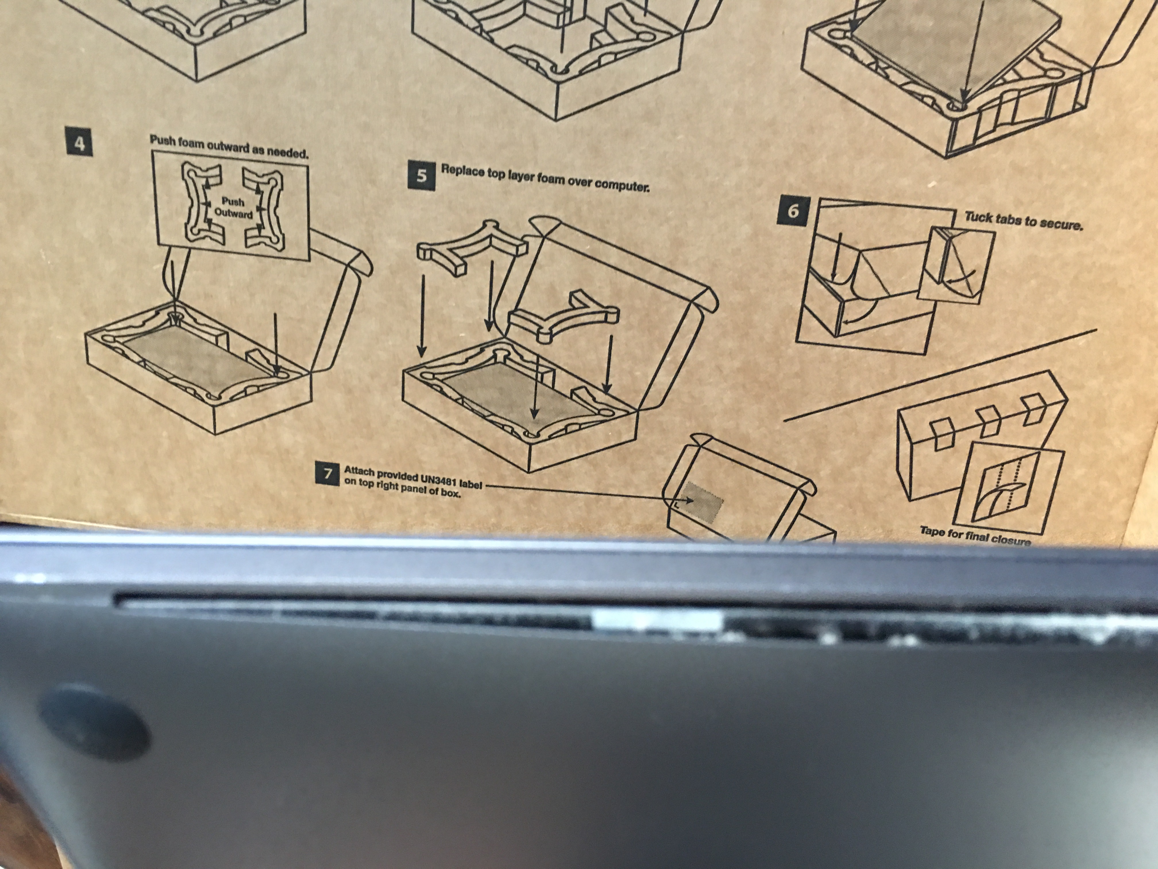

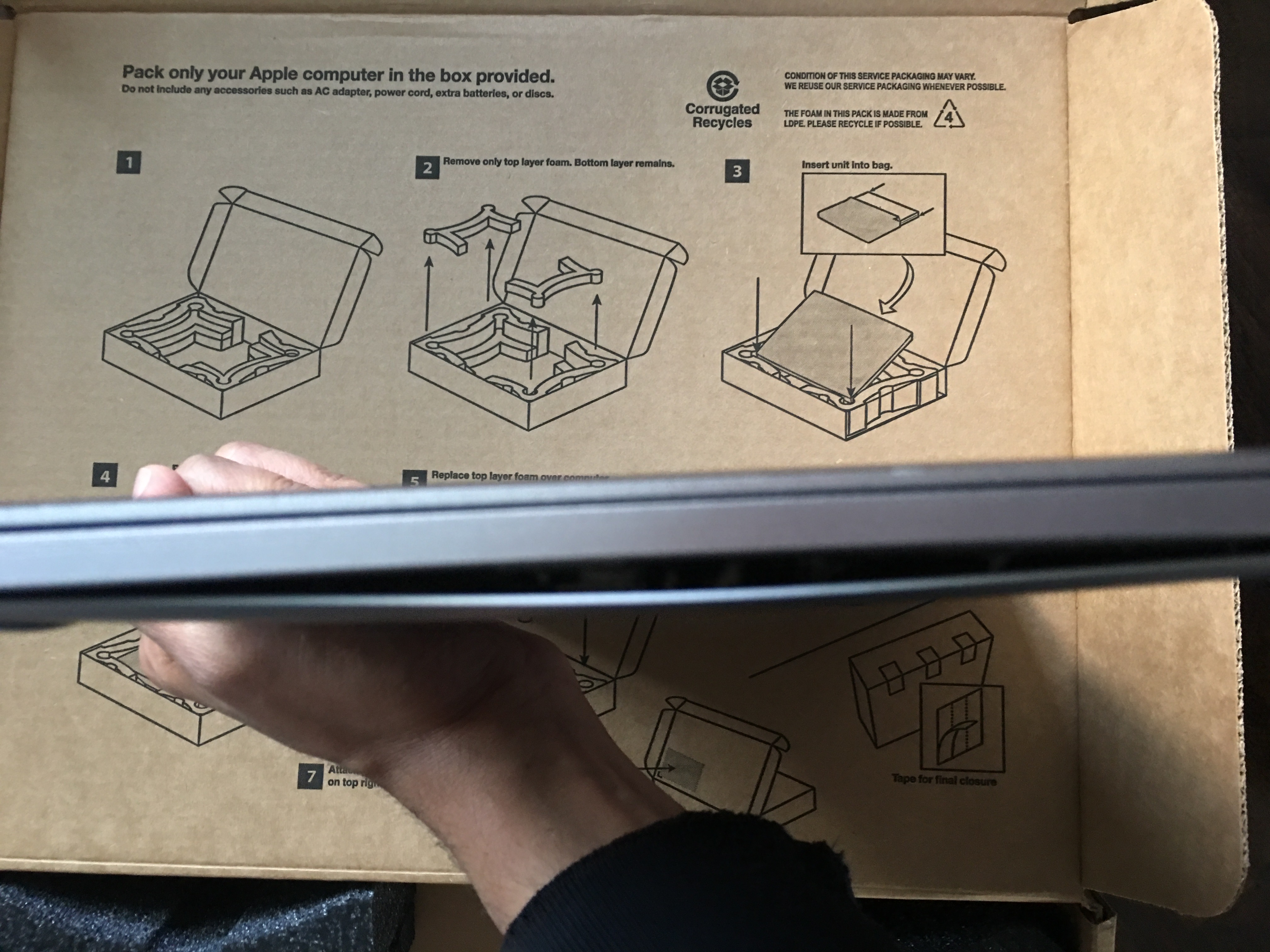

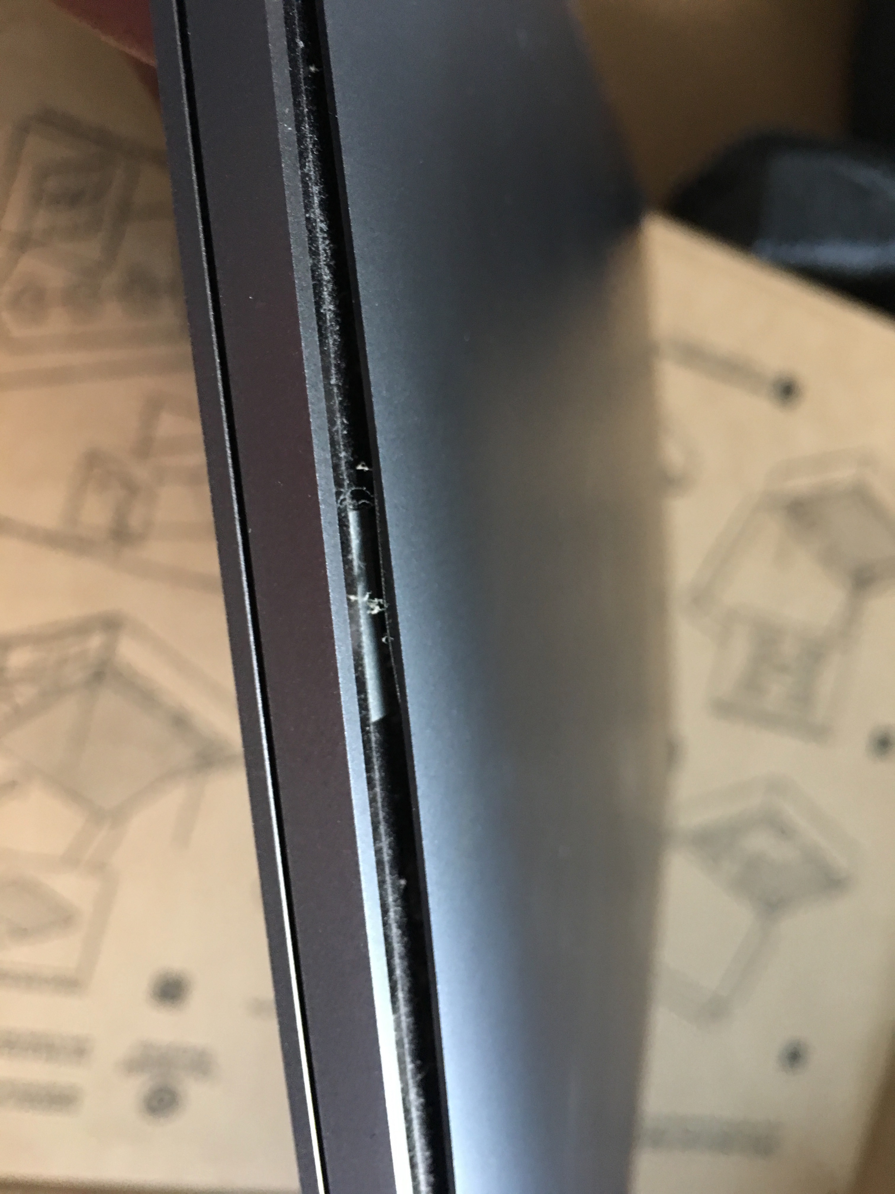

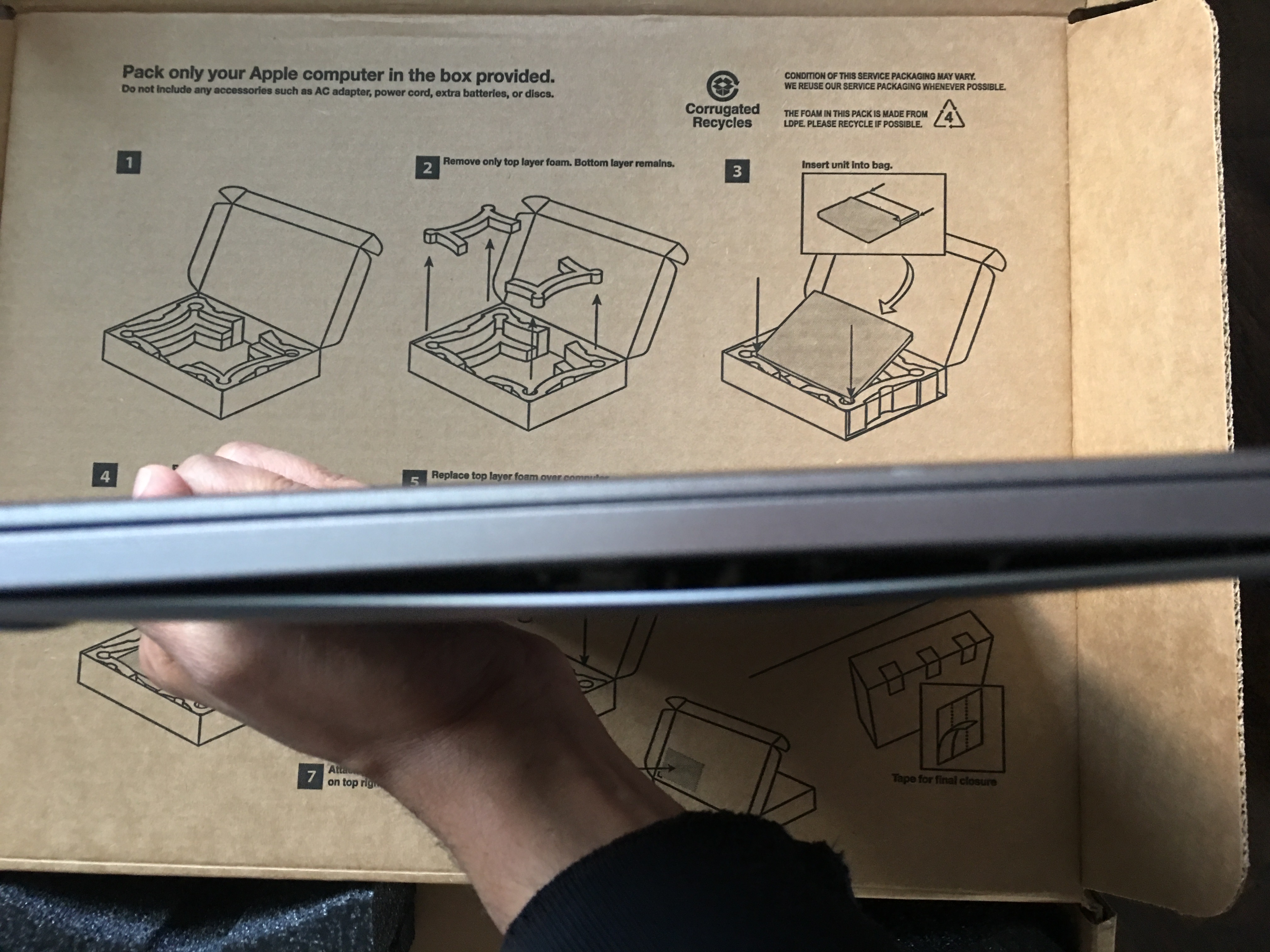

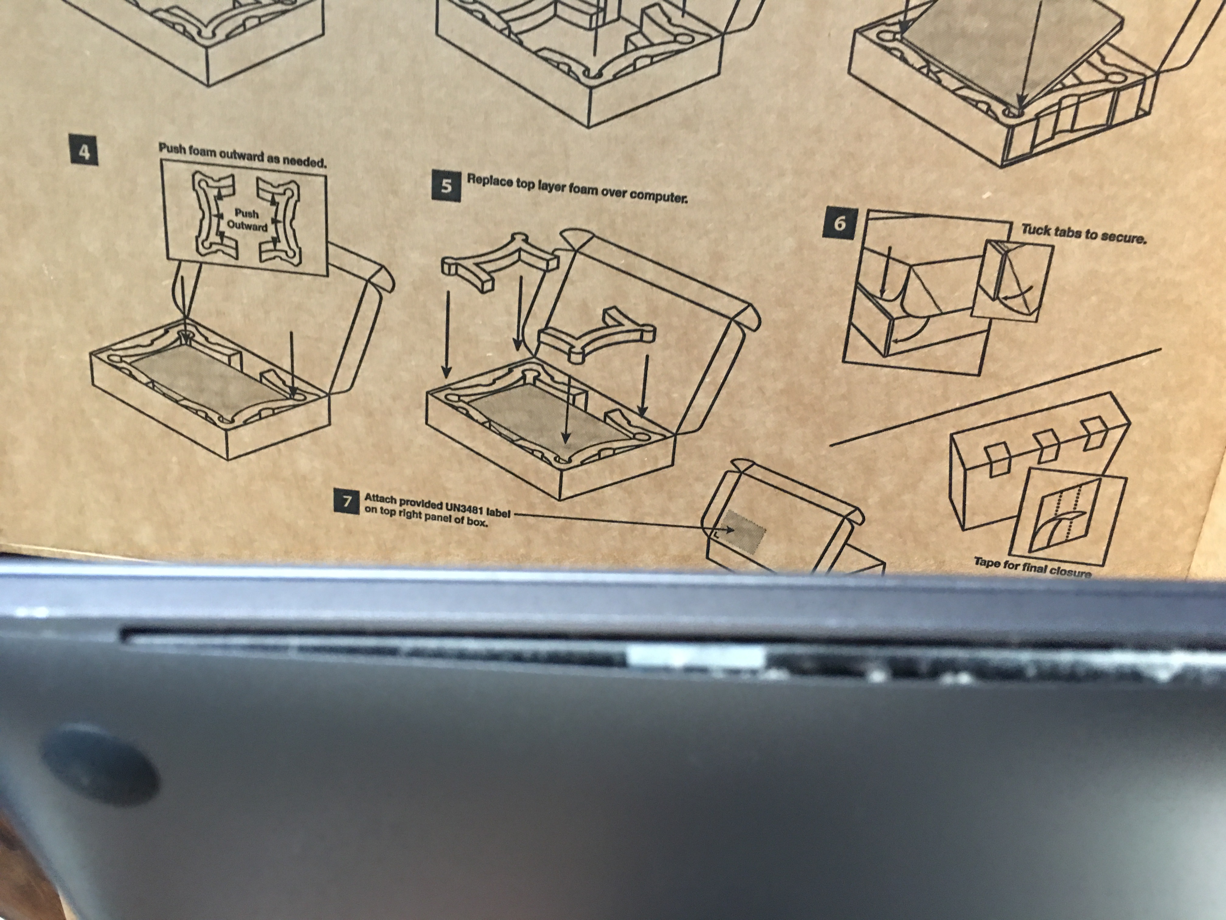

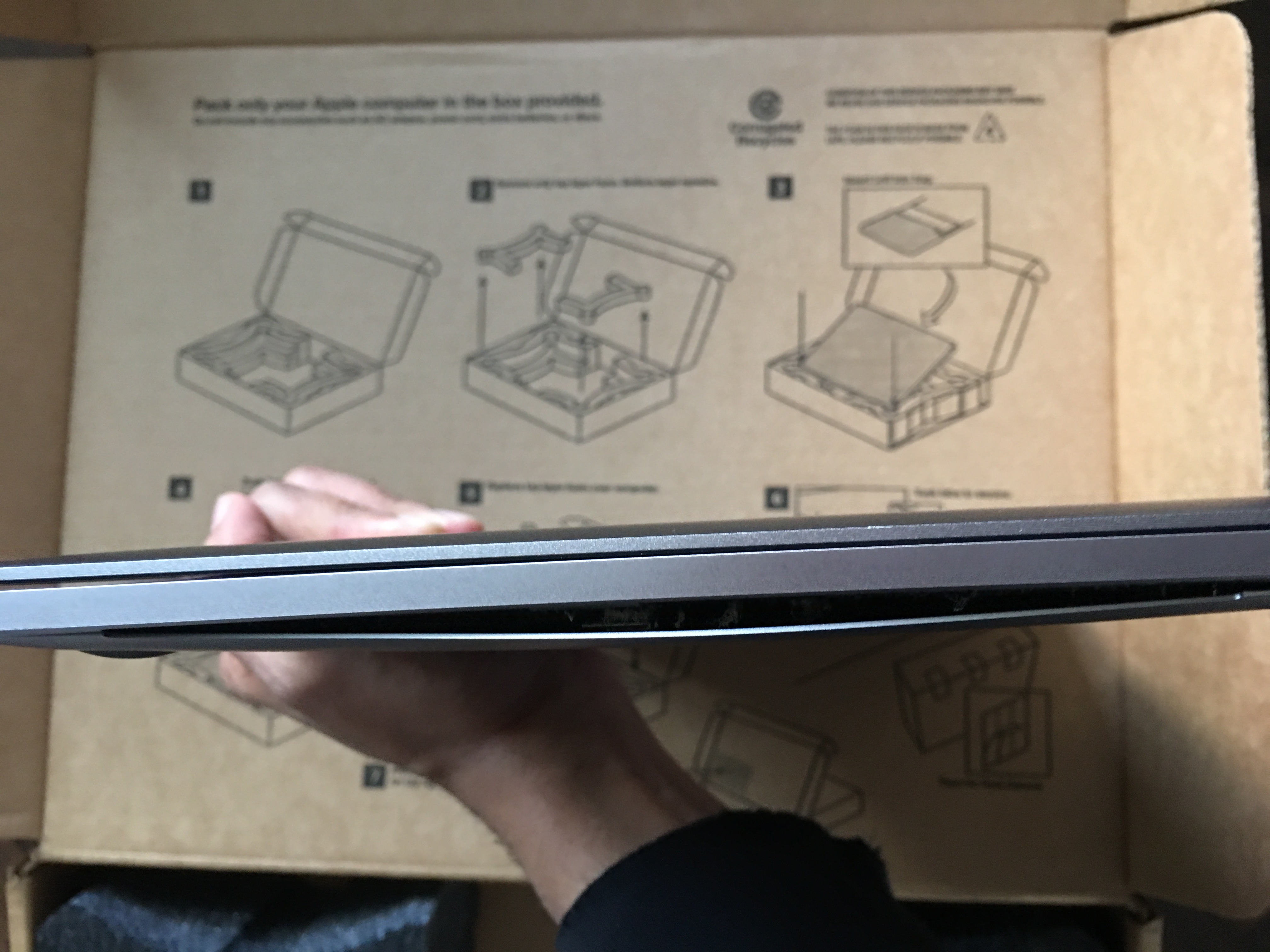

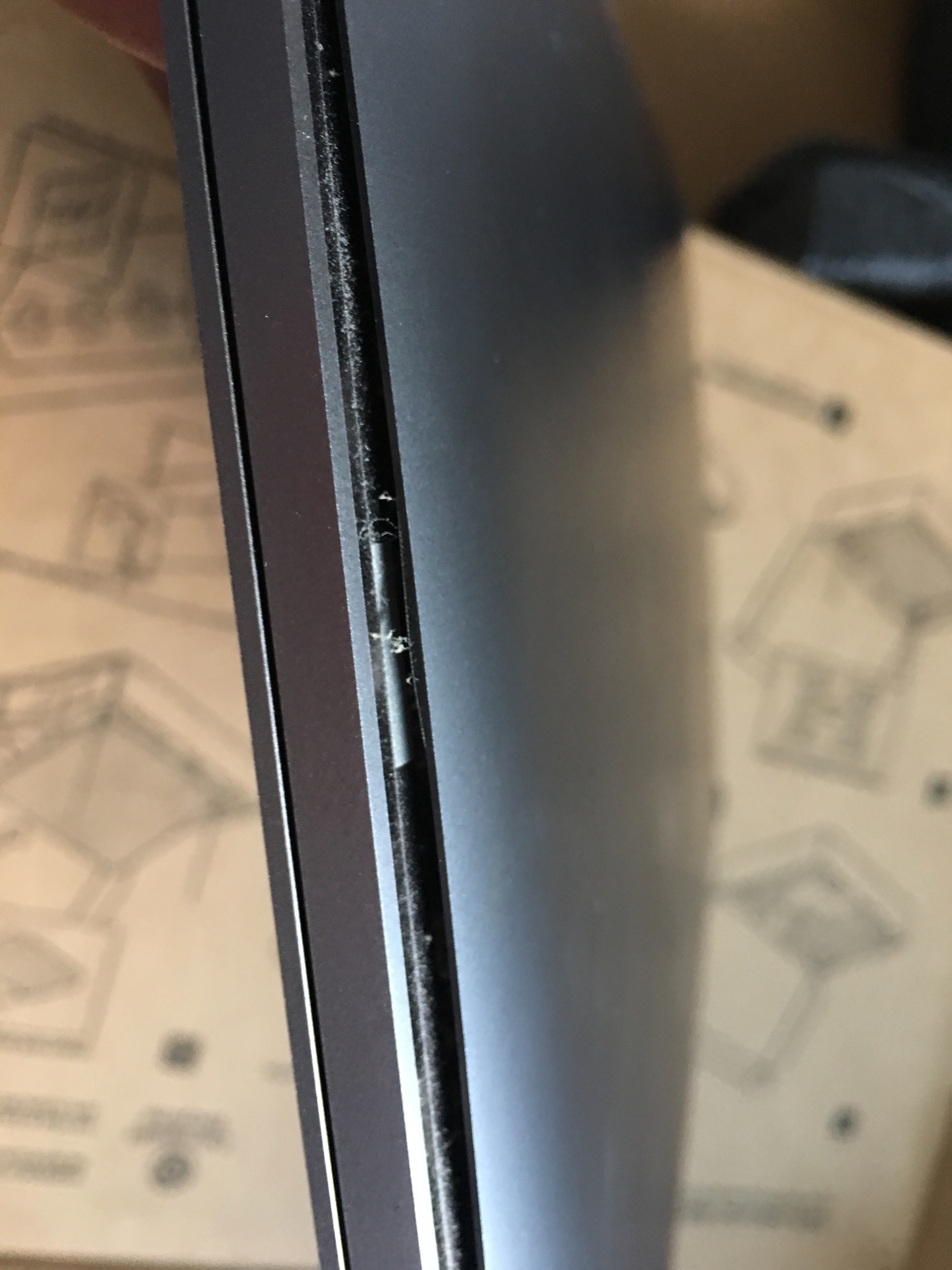

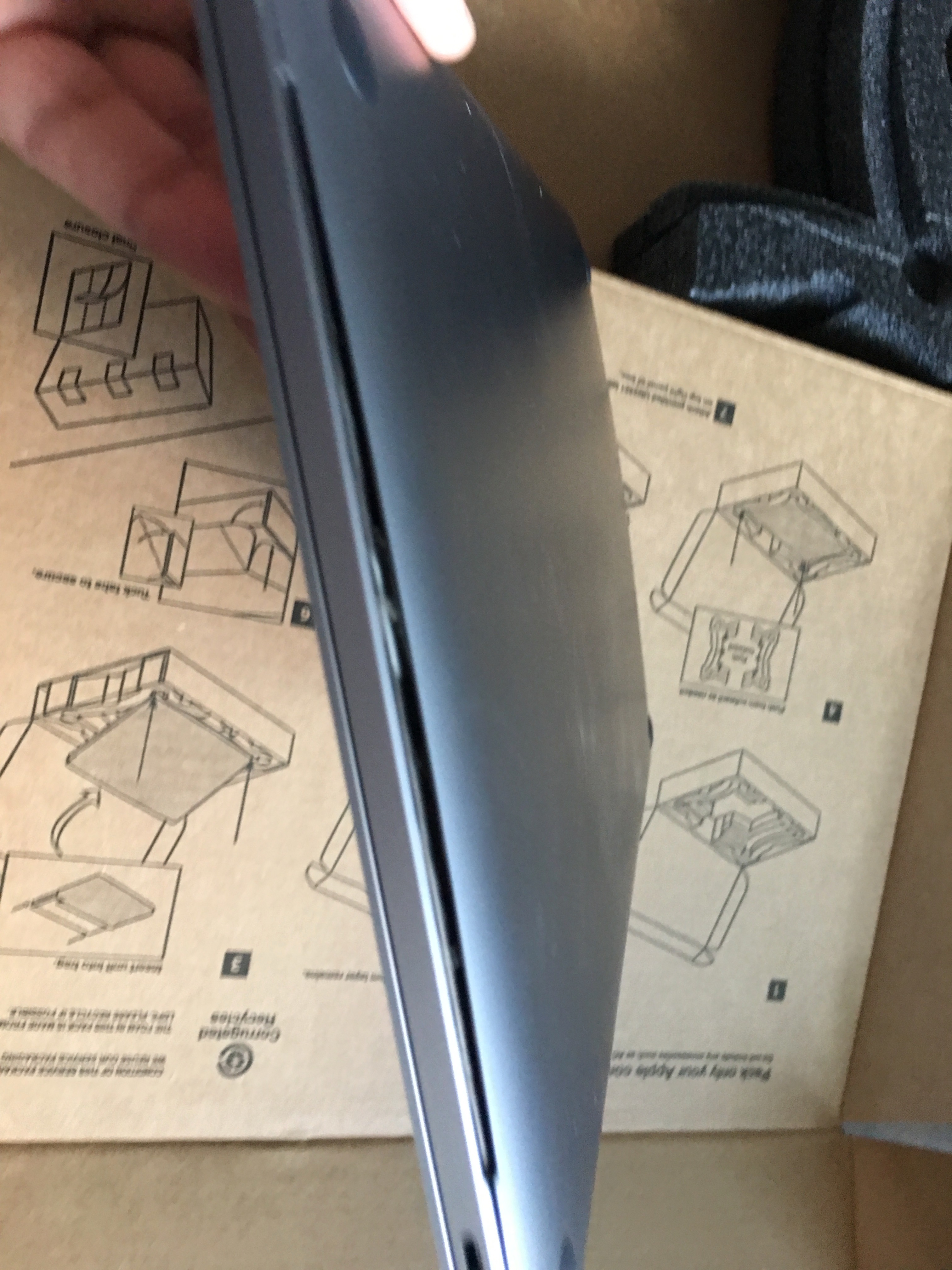

I too have a swollen battery on my 2017 MBP. Have sent it to Apple and they said they will replace or take care of it. I do have AppleCare+. Pictures attached

Likely swollen battery. I diagnosed one of these for a co-worker a few weeks ago. He got a replacement machine (not new though).
Yes they said likely a replacement of the battery assuming nothing else is damaged.
