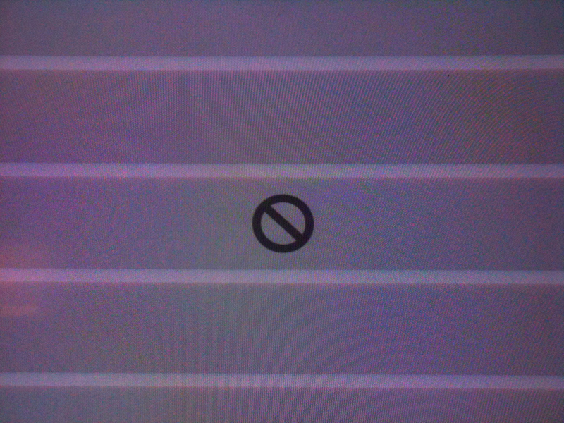

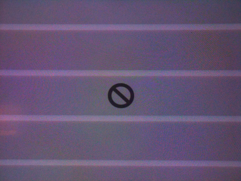

You think you have issues, this is what my old G3 iMac is giving me.
