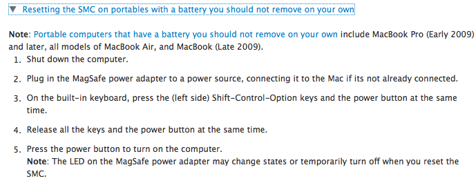

Should I attempt the SMC thing, because if I can't turn it on at all, can I still do it?

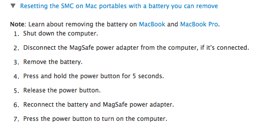

Is this a Macbook Pro that has a removable battery? Or a newer one with the built in battery?
If you can take the battery out from the bottom. Do that first, then plug in the mag safe, you can use the one from your newer Mac Book pro ( just in case the old one suddenly stopped working somehow). Then see if it powers on normally.

Go to the link I put in my previous post and follow the directions to reset the SMC for your type of MacBook Pro. Or look at the two image attachments in this post and choose the one that applies to your model.
