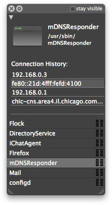

mDNSresponder is, essentially, "Bonjour" which is used by devices on the same network to talk to each other by name. This includes your router, laptop, and anything else including non-computer internet devices.

Gotta question tho,
What does this IP address starting w/ fe80: mean?
The other 192.168.0.1 is Comcast (I guess, since it's always there at all time) and 192.168.0.3 is my iMac. But that "fe80.." IP address kept popping up like it was actively using my network and never seen that before
BTW, the last "chic-cns" is Comcast (Pretty sure of that one)
But I'm too confused about that "fe80:" what does that IP address mean? Only two of my computers are connected(Macbook Pro & iMac) and both have a 192.168... IP address
