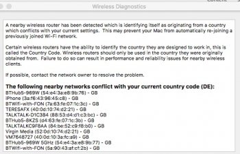

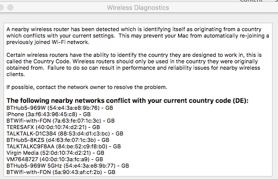

My work MacBook has an absolute nightmare with my home WiFi – I get about a minute's internet and then it's out for a few minutes. Rinse and repeat. This is constant, I've had the machine since April and whenever I bring it home this happens.
I ran Wireless Diagnostics and it says there are conflicting country codes between my machine and routers. The problem is, it's my Mac which has the wrong country code (DE), and the routers have the correct (GB) one.
Will this affect my WiFi performance? All other devices connect without problems. Can I change my country code on my Mac?

That’s not what the image shows. It just lists the networks that are now incompatible. There may be a device somewhere that broadcasts a German country code. You need to find this device, or make sure that your Mac is booted where only these routers with British country codes are.
I agree with KALLT. The screenshot of the diagnostic you posted only shows the routers that are incompatible with your Mac's DE country code. It will not show any that ARE compatible with the DE country code and it will be one of those that is causing the problem. What you need to do is to follow the instructions in the article I linked to which reads as follows:
To determine whether there are conflicting country codes in an area on your Mac, hold the Option key, click the Wi-Fi icon on the top bar, and select “Open Wireless Diagnostics.” Go through the wizard, which will scan your area and alert you to things you can do to improve your Wi-Fi.
At the end of the process, you’ll see “Conflicting Country Codes” in the summary. This indicates there are wireless routers with two different country codes nearby. Either there’s a misconfigured router, or you’re almost exactly on the border between two different countries!​
