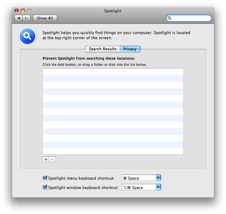

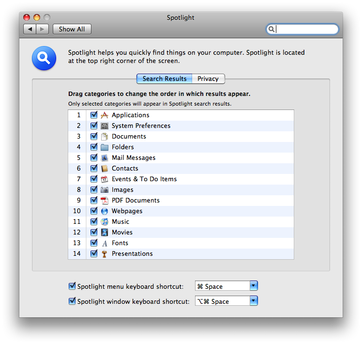

My MBP 17 (2.6 GHz, model 4.1) with  128 SSD isn't finding files which are definitely on my drive. Seem to only find files on the desktop, but not in sub folders for some reason. Any ideas why? Is it the SSD thats not indexing properly?
How can I reset or fix this. Its becoming annoying
snap shots of my spotlight panels..

That is very odd... I have no clue why Spotlight does that... Open a new Finder window, and then try to use the little search icon thingy in the corner. See if that works.
Yes, really Odd. I think its the SSD causing this. I will try resetting this from advice from  discussion forums
