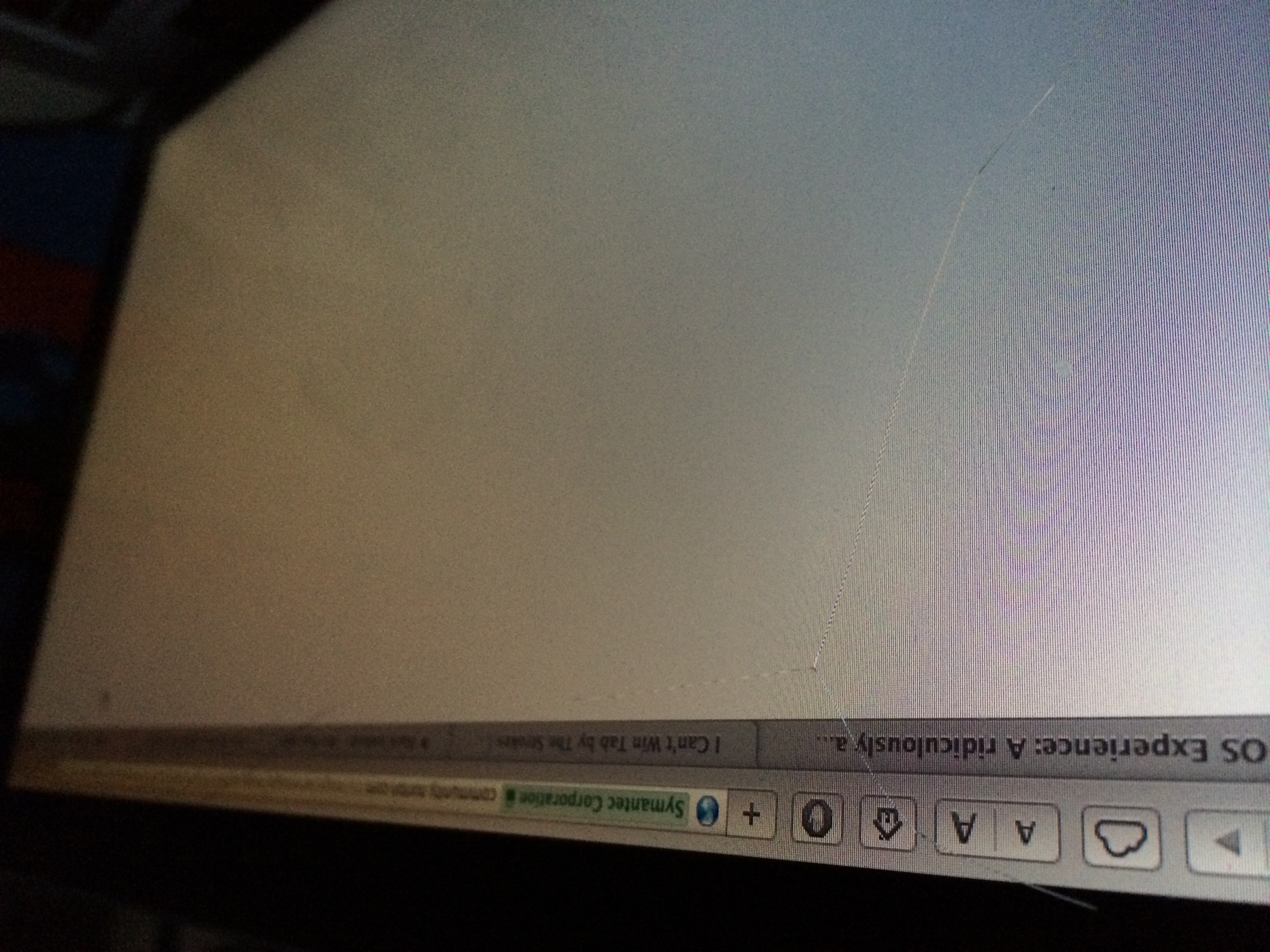

So my MBP has some issues but one of them is that it has a hairline crack going through the screen of my macbook pro 2013 (Non-Retina) . Don't know how it cracked but regardless of how has anyone had their MBP screen replaced before or recently? anyone know a estimate about how much it would cost to replace the screen?
Here I will attach a picture of the crack.

If the crack is just in the glass, the actual part isn't much, but replacing it is a pain. The whole LCD assembly must be removed, and then heated and the glass has to be separated. Then the LCD must be cleaned and the fresh glass must be applied. All in all about 1-2 hours of work. If it is both the LCD and glass, then just get a new assembly off eBay. Life is simple... That would be cheaper and cut labor costs by a lot.
As for the USB ports, try doing an SMC and a PRAM reset. Otherwise, do a Apple Hardware Test by holding D at boot.
