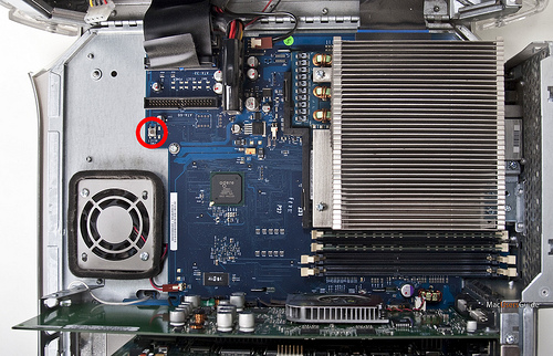

If the MDD has been unplugged for a while, press the CUDA button on the logic board.
Here's where it's located:
698217040

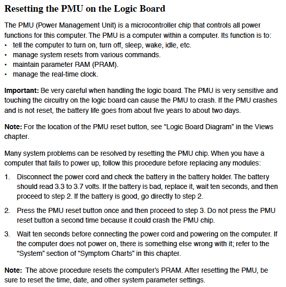

I think you would want to confirm good battery voltage before trying that. I think the procedure is to do this with the computer unplugged, press the PMU reset switch only ONCE, then wait 10s, and connect power.

For whatever it's worth, I was receiving the same behavior with my Quicksilver until I reset the PMU as @micahgartman now suggests. Once I did, it fired right up, good as new.
As I recall, I also believe my iMac G4 kept giving me the same behavior as well, sans power light. All that took was one PMU reset (each time it happened), and all was well again.
Needless to say, I think you should definitely first try that out before moving onto the PSU.
Good day everybody, I opened the PowerMac door and hit the button but behaviour remained the same, till I keep the switch button pressed I get the white led to lit up but computer won't start, am afraid it might be the power supply in whose case I won't bother fixing it but wondering what's the exact procedure to reset the PMU on the PowerMac, press and hold for a certain amount of time...? Gonna give it another try when I go back there, thank you everybody in the meantime
