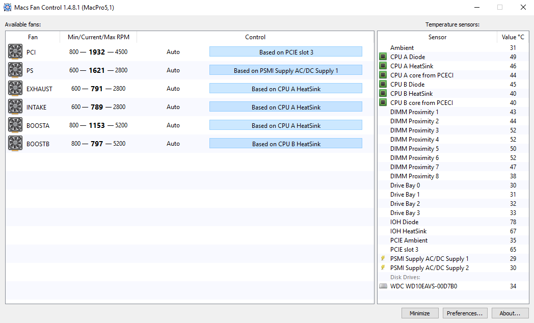

Hi,
plz some one can tell me if my mac pro temperature is normal?
IOH diode 77C, IOH heatsink 66C idle time, i read somewhere that's the northbridge and i could be maximum 125C but i'm still worry
My current setup/fanspeed is ok?
thank you guys

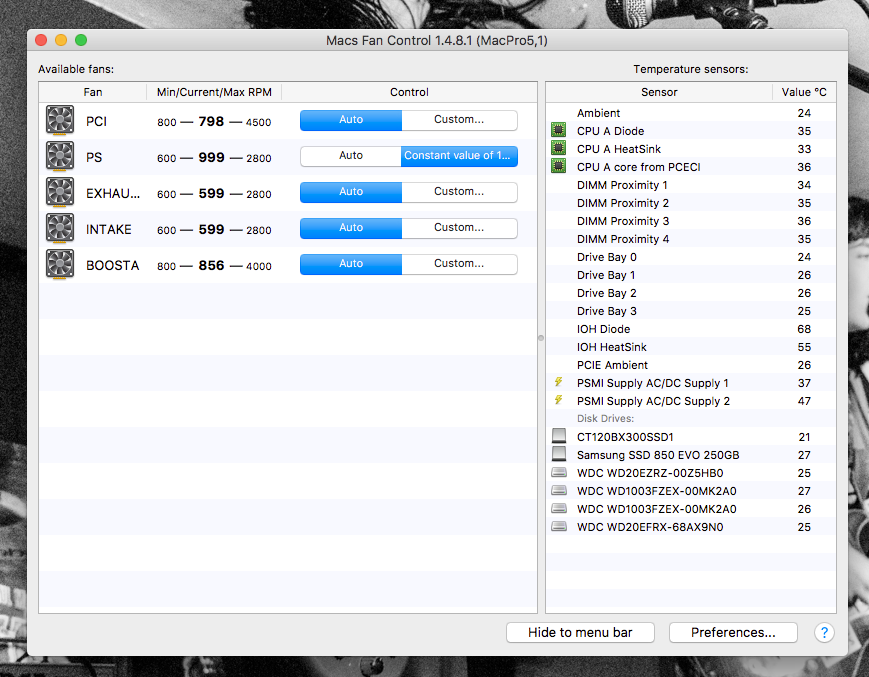

How come your BOOSTB is so low? Usually both BOOST fans idle at ~1115
It's normal for the IOH Diode to get that high if it's hot (Ambient 30C+) and you're stressing the machine a bit.
I'm also in Wales and it's about 17-18C in the room - my machine is doing web browsing/time wasting currently!
I set my Intake/Exhaust a little higher than default as I can't hear the difference, and it allows the BOOST fans to run a bit lower.

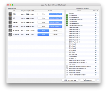

@ndt2011 well you have set your fans to much faster speeds thats why they spin so much.
my computer was almost at idle when i grabbed that screenshot in something like ambient 18-20c (id gess)
notice my pcie ambient reading is 9c colder than yours so i assume you live somewhere thats warm (id swap dang cold here)
@Sharky II wow wish my psu ran that cold idk why but PSMI 2 runs 10c hotter at leas for me idk why, it only cools down when my system is under load idk why
^^ nice to see some one in wales im in the south (the cpu fan at defult runs ,200rpm faster than the intake/outtake fans i think or something like that)
