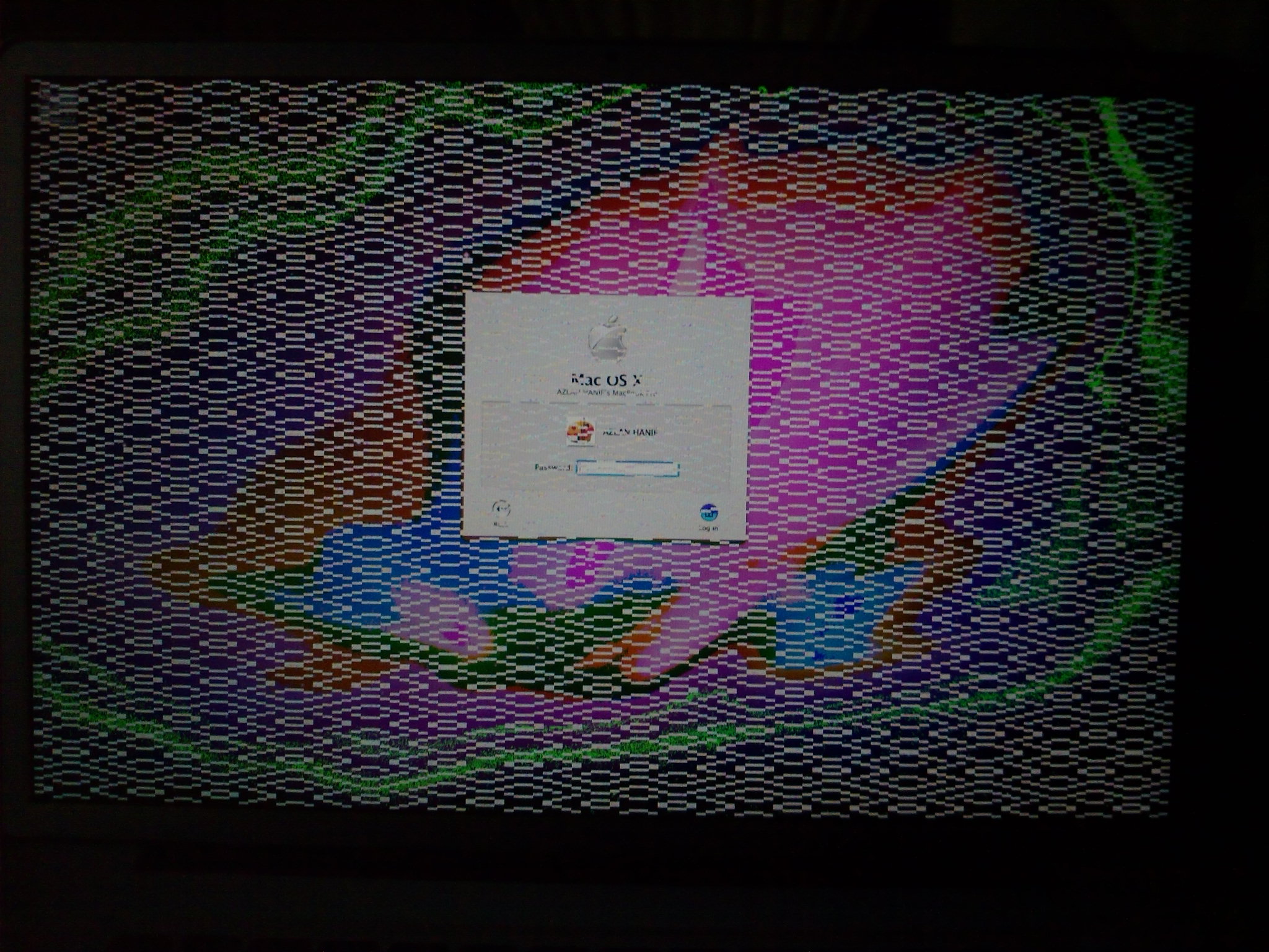

Hi guys.. I'm having a problem on my mbp screen, although it happened only once just an hour ago. The screen goes flickering magenta and white and some pixelated image. I needed to force shutdown using the power button because it seems to stalled. After restarting, it went to normal. I dunno if it has anything to do with the gfxstatus utility that i've installed the night before. I know it might be the nvidia graphic card itself but I just dont have a clue right now. My mbp is just 8 days old and my 1 to 1 exchange has expired since it covers the 1st 7 days only. Please someone help me 🙁
What should I do now? I had waited for around 3 months for my new i5 MBP since I sold my previous MBP. If i return this one, I dunno for how long I will have to wait again since I'm going to do my daily job on it. Please advice..
my mbp spec:
macbook pro 17" AG, i5 2.53 Ghz, 4gb RAM, 500gb Hitachi HD, 512mb nVidia GT330M video card, Mac OSX 10.6.3, with everything updated.
*the attached pic is not showing the exact image since the screen was flickering etc and I'm just using a camera phone
EDIT - I just noticed while I'm just surfing this forum + facebook, my temperature is at 67-70 degree celcius, which is high (normal around 38-45). I look at Activity Monitor and found that Kernel Task is using up to 80% of CPU. I have a feeling that this is not normal, and it had not happened before. Please help! I dont wanna toast my new MBP.

I'd run the Apple Hardware Test (think you have to hold down D on boot), and run an extended scan, if there's an issue with the GPU, Logic board etc you'll get an error code which you can google to find out what the problem is.
If no error code is returned and it passes I would reinstall OS X and see if the issue reoccurs.
I agree. This could solve your problem (hardware test - if no errors are returned, reinstall OS X). If problem persists, that's when I'd recommend booking a Genius appointment and stating on what you have done already.

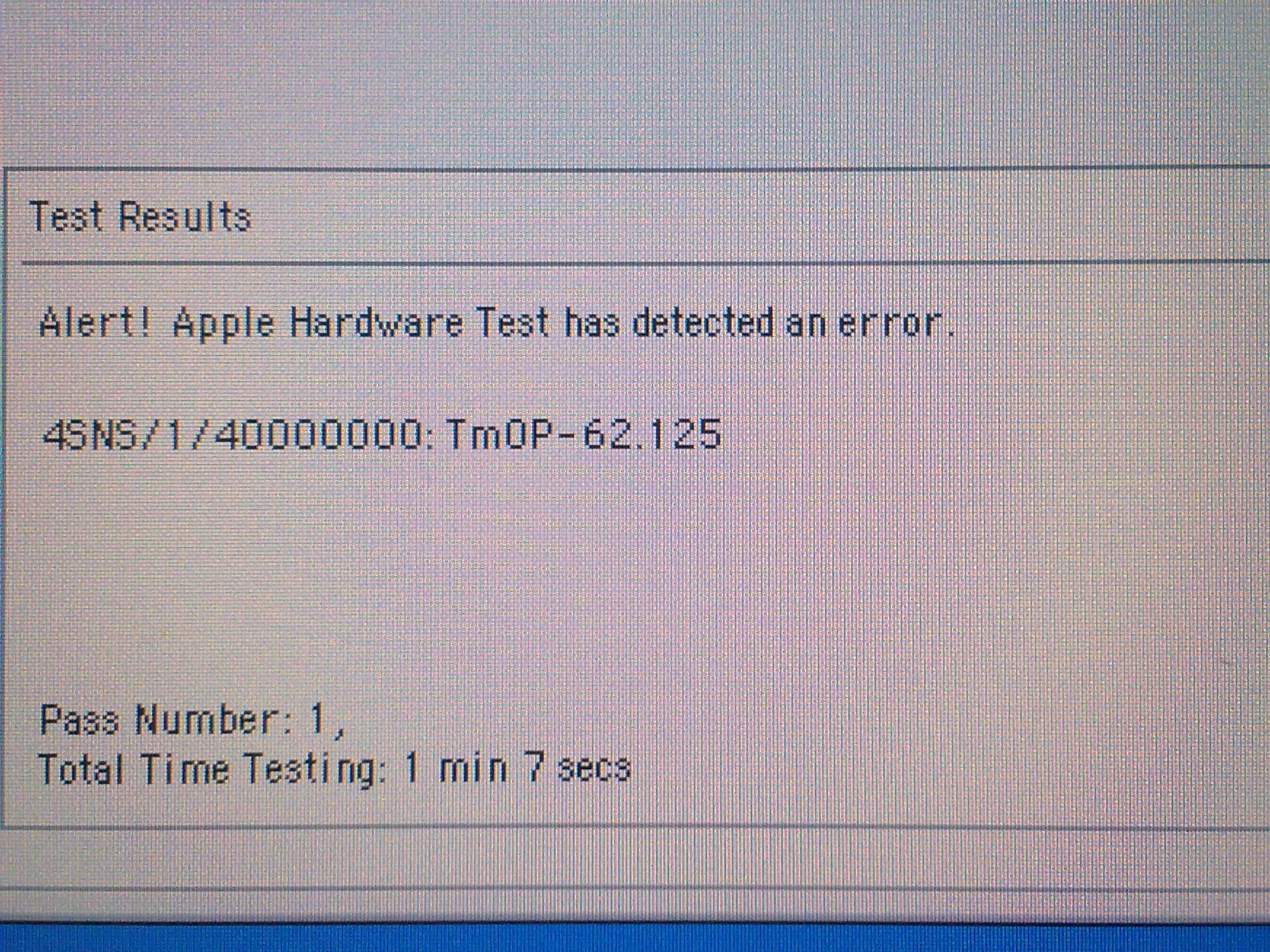

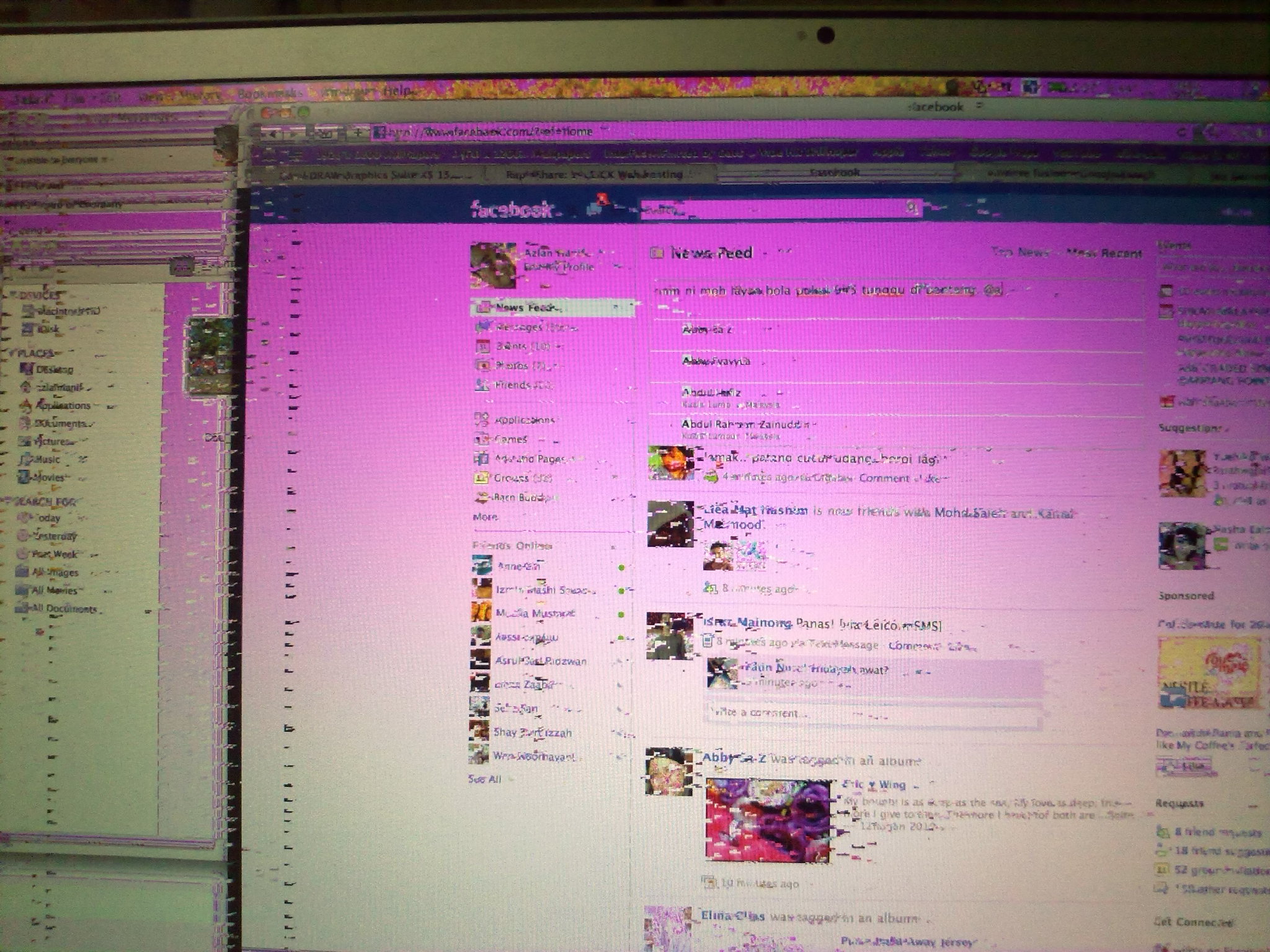

already ran the apple hardware test. it said there is hardware problem. and i'm so disappointed.will visit apple store tomorrow. Ironically, it looks like(the display'pattern) my previous MBP's problem(c2duo 2.16, 15" glossy, 2gb ram, 128mb ati x1600 gfx card, 128gb hitachi hd). I sold that one n wait more than 3 months to get a brand new mbp only to discover the same problem! I didn't even push the machine yet.only light browsing, IM, simple photoshop resizing n stuffs..

Thanks for the advice guys. I'm going to apple service today. Just now, i googled the error code i got from apple hardware test. Found some forum and the advice is to reset pram or something like that(holding command + option + p + r while booting). The guy with the exact error code problem suddenly found that step solved his problem with no more error code after resetting pram. i just decided to try it to see what will happen and to my surprise, no error code for me as well! I ran both normal + extensive test. Both showed no error found. How come a hardware problem can be solved by just a few key clicks or maybe it has not been solved just yet? 😕

But back to the original issue, I would do something sooner rather than later. Like I said you spent over 2k for a laptop which should be problem free for at least one year, get a replacement even if resetting PRAM worked initially.
The artifacts and discolouration are a good indication of bad video memory and you dont want to have the problem crop up 6 months to a year down the line and have to be without a computer when you could have just replaced it within the first two weeks of owning it. Just go into the store with a strong disposition, and dont take no for an answer. Be polite and dont cause a scene just dont back down and they should help you out.
