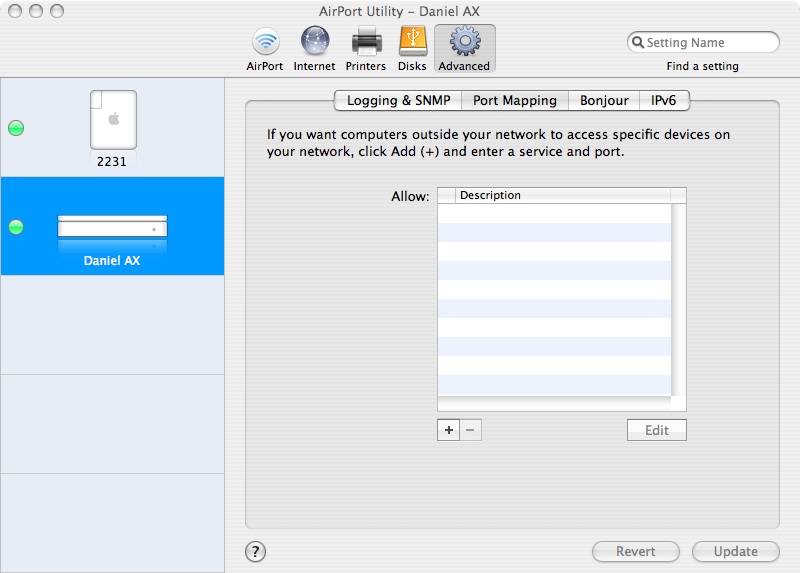

I was curious about that as well, and I found the answer on page 60 of the Designing Airport Extreme Networks manual (PDF). Looks pretty straightforward.
Thanks mrogers. It does look pretty easy, but unfortunately, it's just port forwarding and not triggering, which I've recently discovered is handy for BitTorrent and multiple machines on the network (it lets the BT incoming traffic go to the machine that is running BT instead of to a static IP set in the forwarding table). This alleviated my issues with having World of Warcraft on multiple machines, since it uses BT to patch.
Oh well - perhaps Apple will add "advanced" stuff like that to the Extreme at some point.

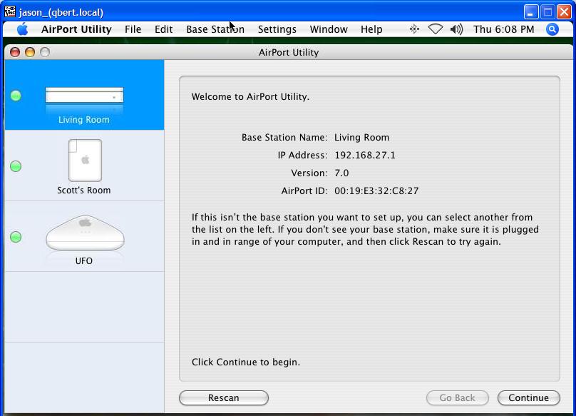

There is actually an entirely new airport management utility, but it effectively does the same thing....here is a screenshot of the desired setting screen:
are you using your express w/AT to send out the b/g signal and using the new airport to broadcast just N?

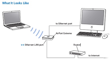

the similar thing can be done with the AEBS. so in case you already have a gigabit router, you can leave it as that, and add the n-capability by configuring the AEBS as a bridge. so the wired network is still gigabit, and the wireless is n-wireless (along side with the g-wireless or b-wireless of the, say, linksys wrt54g, if it was already there)
basically it looks like in the picture i attach (it's on the page 35 of the following document. so plz let me know if it's illegal to do this. i'll remove it at once)
http://manuals.info.apple.com/en/DesigningAirPortExtreme802.11nNetworks.pdf

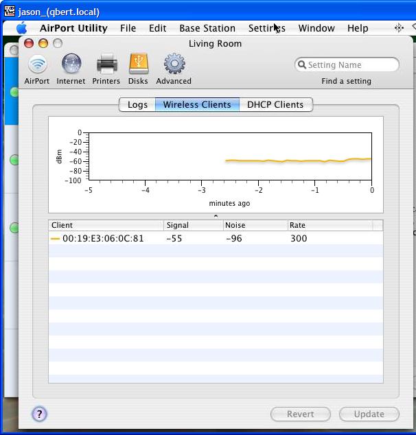

If GigE isn't a huge requirement for you, one other thing to consider (in the new Extremes favor, IMO) is the ease of setup.
The new AirPort Utility program that Apple ships with the Extreme makes it a piece of cake for novices and more advanced people to quickly setup their network and monitor its performance.
If you're only going to have one wireless router in the house, this probably isn't a huge deal for you, but my wireless network's a bit odd, and I really appreciate being able to see how every access point is doing (and the connection speed/strength/noise of each of the wireless devices in the house). It makes troubleshooting issues a lot easier.

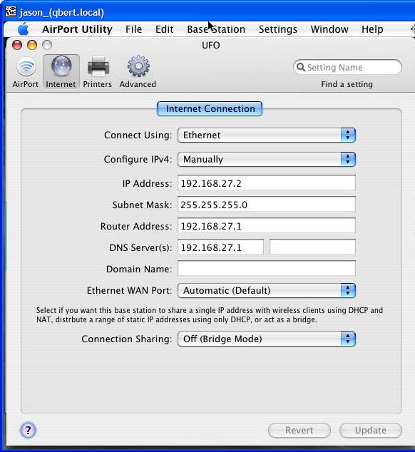

awesome night storm appericiate the heads up by anychance do you have the link to do this?
I think you're looking for the part about "Dual Band" networks, on page 47.
If you're going to have your 802.11b/g router hanging off of your new Airport Extreme, remember to set the slower 802.11b/g router's "Connection Sharing" setting (which is on the Internet tab) to "Off (Bridge Mode)" if you want the devices on the two different wireless networks to be able to talk to each other. That lets whatever's distributing DHCP on your network to give addresses to your b/g devices.
