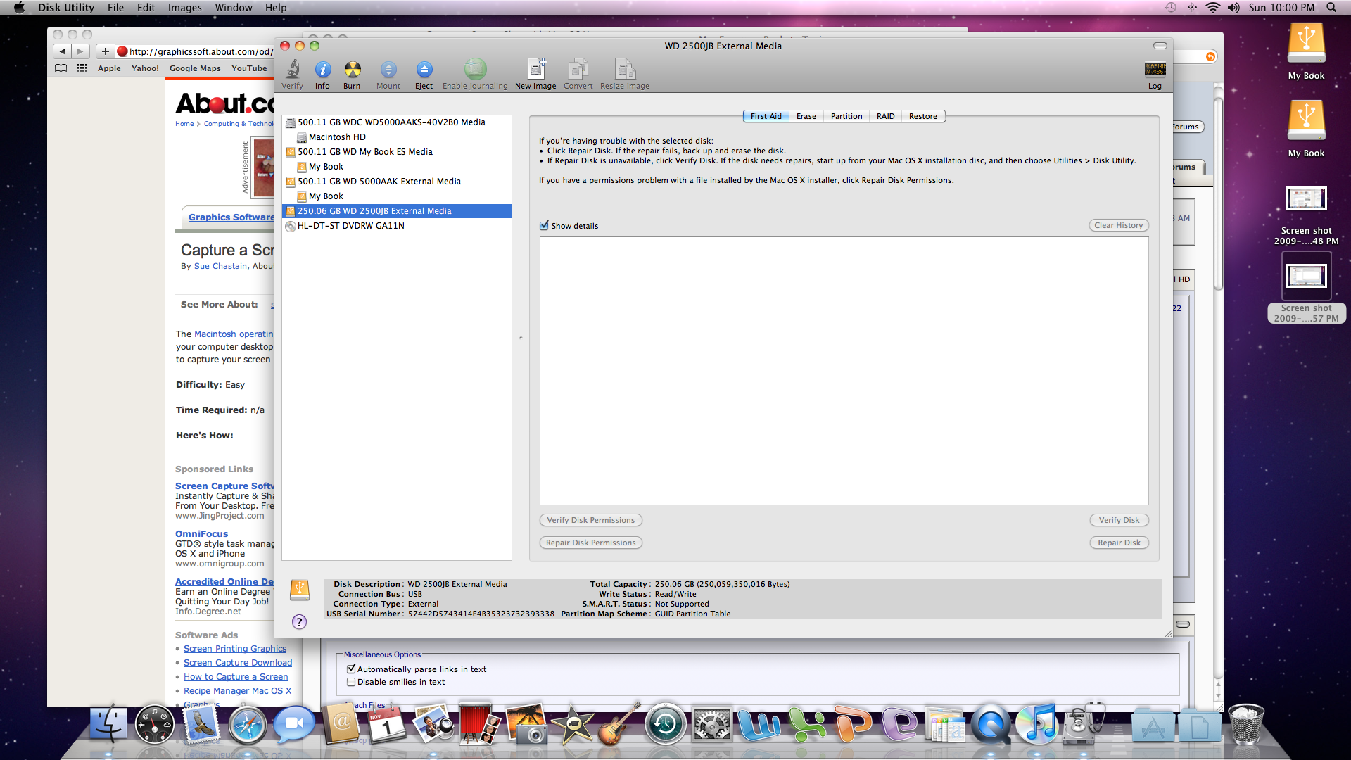

Can you post a screenshot of disk utility with the HD turned on and connected to your iMac?

New to mac so I really do not know how to do that yet. What information are you looking for exactly?

/Users/z_w_binkley/Desktop/Screen shot 2009-11-01 at 10.00.41 PM.png
Applications > Utilities > Disk Utility.
You can do a screen grab by using the grab utility located in the same directory Disk Utility is in.

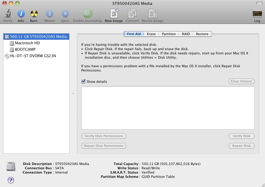

This : With the external Disks attached and turned on.
That work?
Now see if you can "repair disk". Also does it show up on the side in Finder? If so select "get info"
What does that mean ? You couldn't repair disk ?
Nope I couldn't. The other hard drives have a sub menu to click on. This one doesn't. It reads that it's plugged in but there when I click on it, I can't click anything else
That hard drive still has stuff on it. It does sound like it just died though.

Can you do anything to it under disk utility? Do not try to format it. I'm quit sure theres still info on it.
Does it make any sounds ? Like clicking or whirring?
