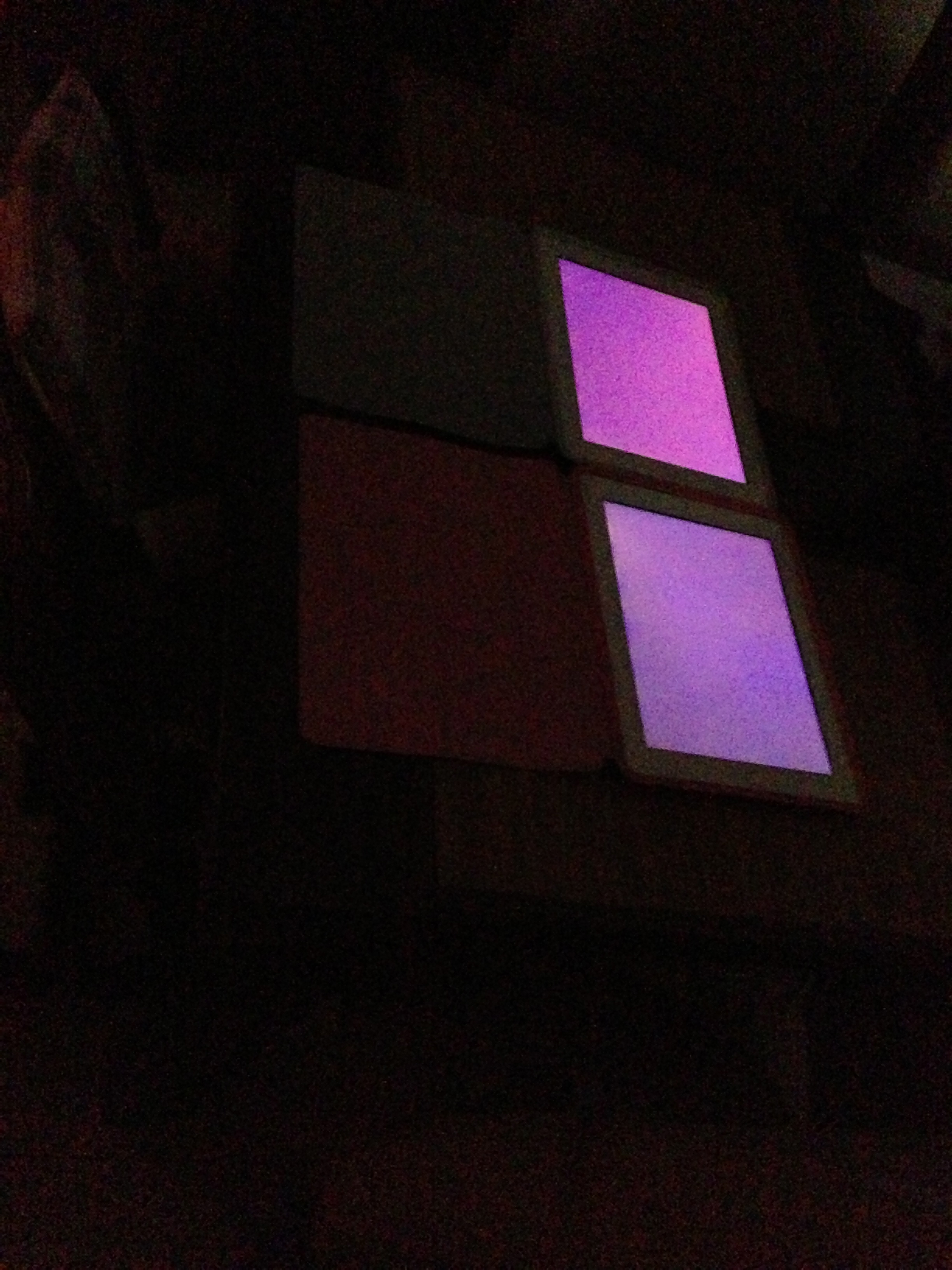

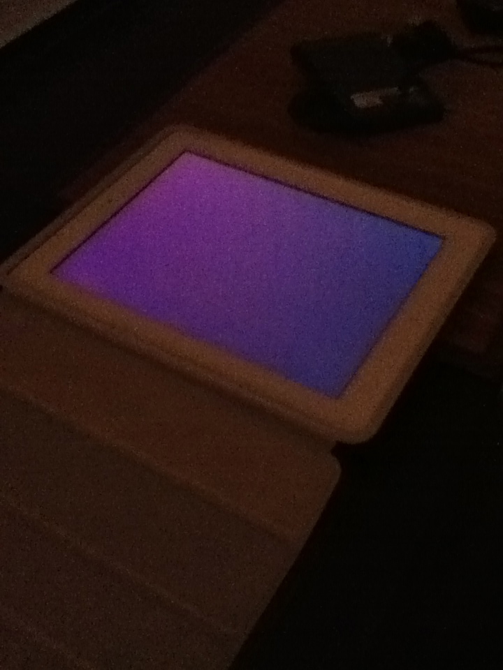

I posted that picture at an "extreme" angle. What I meant was that the screen gets gradually purple.. In normal use circumstances, what happens is that my screen is never all white (actually yellow), no sweet spot, half of the screen is always slightly tinted.

I use my iPad to read, and at night the white page looks sepia. It bothers me, and at the smallest tilt the farther part of the screen gets red tint.. so I end up with half yellow, half reddish screen.. it bothers me so much
This is actually normal for IPS displays.

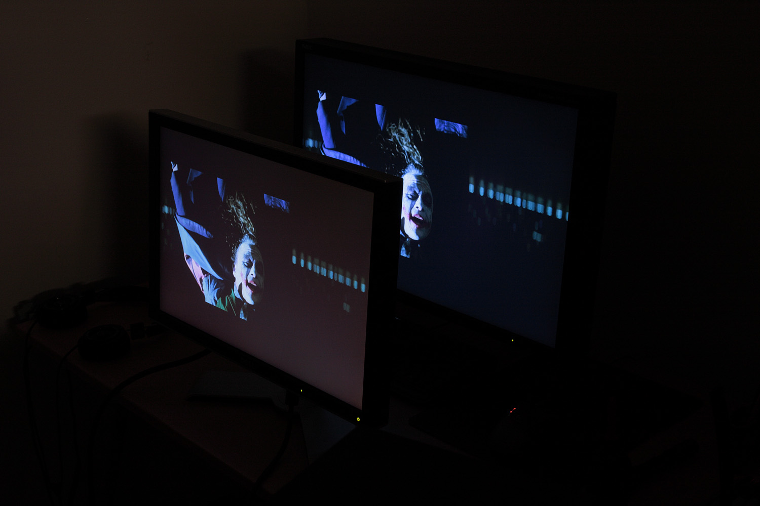

The "purple haze" is because no-one has been making IPS panels with A-TW polarizers for a number of years now.
The panel in front does not have an A-TW polarizer (as with all modern IPS panels) whereas the panel behind is an older high-end NEC that does.
(source: google images)

I bought my iPad 3 this week and the screen brightness is uniform, but I do notice the pink tinting when watching movies in bed, which I thought was a form of backlight bleed. Thanks to this post I am more aware of the iPad panel's...characteristics...and will stop worrying about a defective screen.
