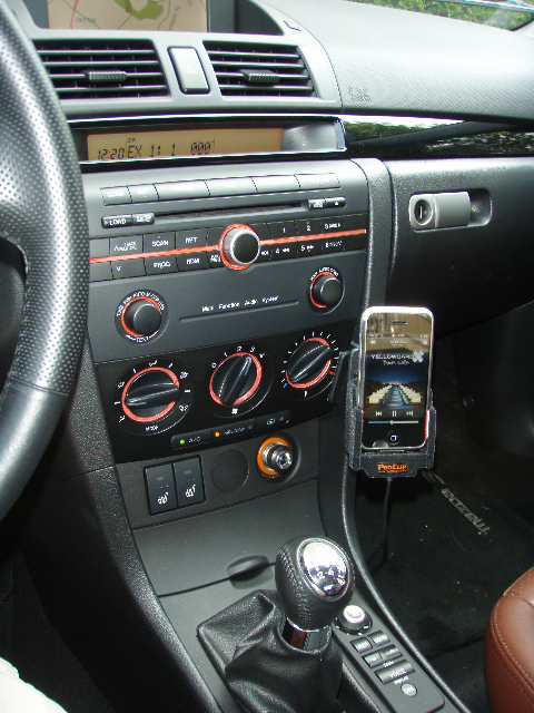

So after searching and searching for the perfect iPhone car solution, here's what I came up with...
I purchased a Dice Electronics iPod Car Stereo interface which lets me interface my iPhone with my factory car stereo via it's iPod connector. My stereo treats the iPhone as if it's a CD Changer. It also charges the iphone and lets me change tracks via the car stereo's controls.
Then I purchased an Pro Clip 30GB iPod Swivel Dock (with connector). I purchased the iPod dock because Pro Clip doesn't carry an iPhone dock with connector and the 30GB iPod has roughly the same dimentions.
I also purchased Motorola's T305 Bluetooth visor mount speaker phone.
It works great! It holds the iPhone quite well and seemlessly intergrates my phone with the car. Now I can listen to music and answer calls without ever touching the iPhone.
For more info on the parts, I listed the product links below...

How well does it fit with bumps and stuff? Is it easily docked or do you have to wiggle the iPhone to make it fit down on the plug?

It's very solid. Doesn't move at all. I wish I could lock the swivel in one position because even at it's tightest, it still moves with a GOOD push. But bumps don't bother it at all.
As for the bluetooth speakerphone, it works great. I just with it had a little more volume.
No interferance. But that will vary from car to car. Where my phone is located, it doesn't cause any problems.

I purchased the one for the 30GB video (the latest) with the standard iPod connector slot. I had to file the connector slot on the dock just a little to make the Dice connector fit and then it fit pretty snug.

I really hope that Pro Clip produces one made for the iPhone with a connector slot. The ones they have now for the iPhone are slimmer and are probably a nicer fit. I had to go with the iPod model because it had the slot for the connector. But it does work really well.
