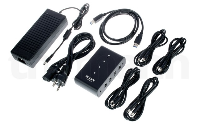

I dropped the cash on an Icon OneHub several weeks ago, and it arrived yesterday. The OneHub is both a 3A power supply which can power all four units instead of the four separate PSUs, and a four-port USB 3 hub, to which a Pro X master controller and three XS slave controllers can be connected. Plugging the OneHub into one of my Studio Max’s USB A sockets and connecting the powerleads and USB cables from it to all all four QCon devices, the OneHub seems to have completely solved my issues of the units freezing and losing connection to the computer, which was just about an everyday occurrence when they were connected to the computer via either a regular passive USB A or USB C hub, or via the master unit's built-in USB A hub.
Last night I tried a variety of Logic projects of between 10 and 50 tracks over a period of several hours and everything has fully worked as it should.
M1 MBA and MPB users looking to adopt this solution will still need to use some kind of dongle or adaptor to connect the OneHub to their computers, because the OneHub only comes with a USB A to USB B Type 3 cable (see image below). I am unsure if you can source a USB C to USB B Type 3 cable? Though technically you don't need to use this hub at all because these control surfaces work just fine with your machines: just use any random USB C hub with four USB A ports that you probably have floating around your bag of wires (we all have a bag of wires, right?).
With computers, things can change by the hour, so I’ll give it a few days before ripping out all four disconnected original PSUs from behind the units and calling it a success. But so far I am cautiously positive.

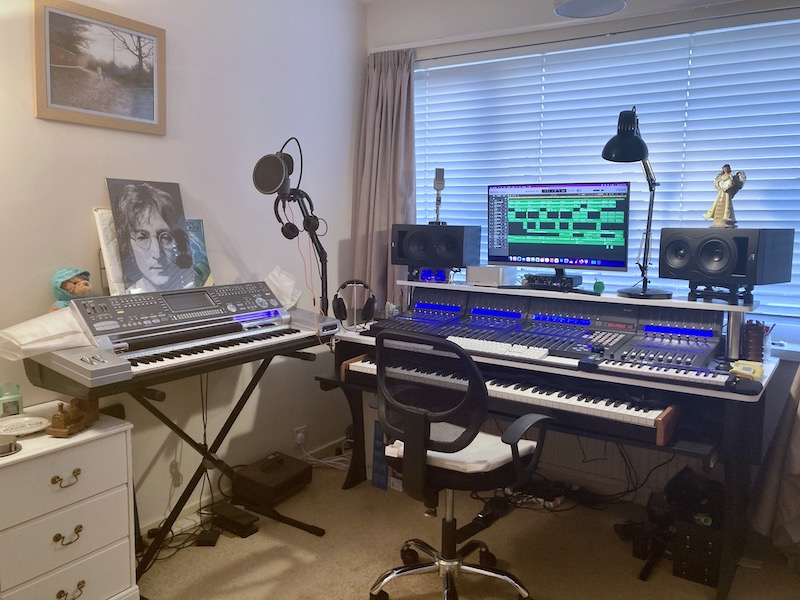

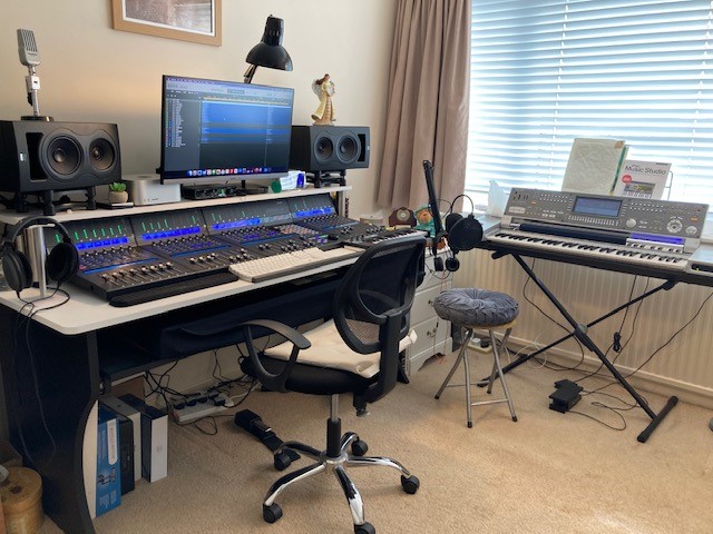

Yesterday (30th May) on a damp and dreary day off from work I decided to shuffle the studio around, firstly because of low sunlight coming through the window in the evening making it difficult to view the screen, and secondly because of the distance between me and the screen. I solved both of these issues by moving the desk to the adjacent wall (basically swapping over my desk and my Technics workstation keyboard) and fitting my monitor with a gas-sprung monitor-arm.
An expected complication is I had to cut a notch in the top shelf so that I could continue to push it back far enough to allow sufficient space for the Icon control surfaces:

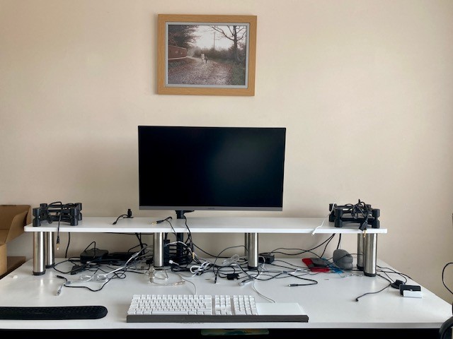

Rare BTS photo of all the cables, PSUs and docks in place before bringing in the hardware. It looked way worse than this until I bought my Icon One Hub which replaced all the separate PSUs for the control surfaces with one PSU.
I use foldback clips, clipped to the back of the upper shelf, to hold the cables in place for the speakers and the computer:

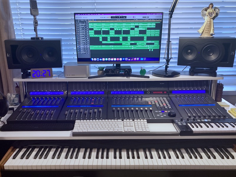

Done, after about 5 hours all-in:
Being able to easily lower the monitor to a better level is game changing when I'm on SM, writing on forums, watching YouTube, or anything basically not involving the control surfaces:

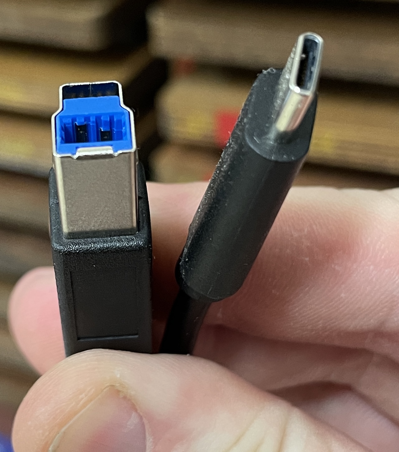

Do you mean a USB 3 cable with a type B connector on one end and USB-C on the other like the one in the picture? I don't know the brand of this particular one, but looks like you can a similar one on Amazon: https://www.amazon.com/Cable-Matters-Type-C-USB-C-Black/dp/B00UXKTJE0?th=1

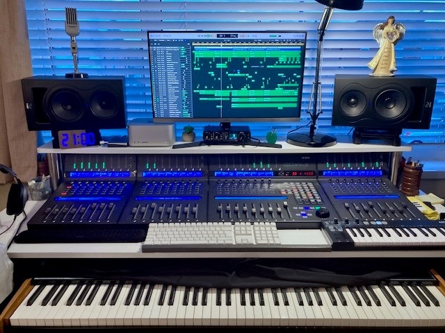

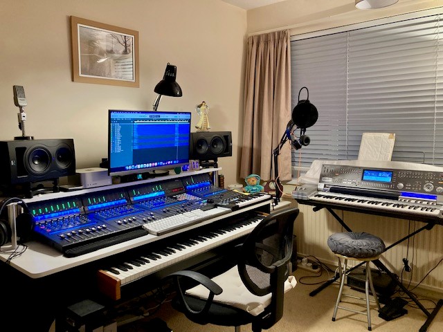

I was working on a mix late last night and decided I'd take another photo of the place while it was lit just by a couple of spot lamps and it looked warm and cosy. Retrospect is a wonderful thing, I should probably have shut the curtains for a better shot, but ah well.
