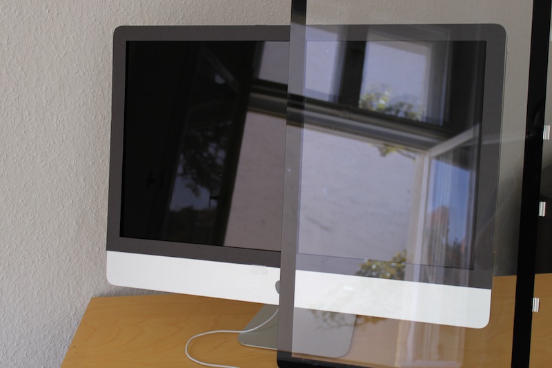

Everything is up and running, so you should be able to see it. I attached a picture for you here. It shows the iMac with a prototype of the GlassFree with the original glass on the right side. You can see how reflections are minimized.

I guess the big difference is that our frame will be made out of plastic instead of metal. We tried that too some time ago but found out that the WLAN and bluetooth signals are shielded then. Also, a plastic frame can be designed more precise around the webcam, LED and ambient light sensor.
We like to provide an alternative made out of high quality plastic - like the black parts on the MacBook Pro or iPad.
I also wondered about the bluetooth and WLAN. My testing showed no problems with the WLAN and the bluetooth signal strength stays at 100%.
The webcam, LED and ambient light sensor are available through a small laser cut window at the top.
