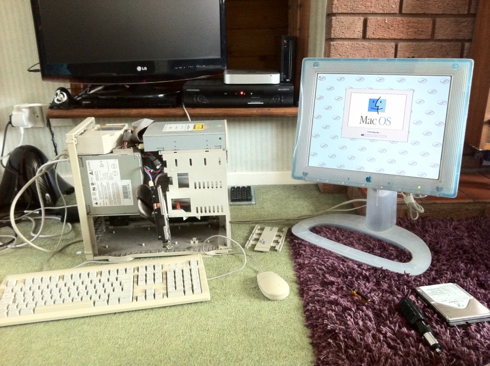

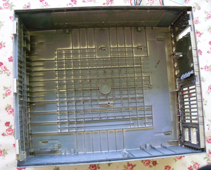

Hi all,
I spent the morning taking the Quadra apart and cleaning it up.
I removed the PRAM battery, which was dead.
I also attempted the floppy drive cleanup and lubrication thing. Since ALL of the floppies I have seen have had crunched gears in the drive motor, I took this apart first and cleaned and greased the inside.
THe result is that now, with the motor removed, I can insert and remove a diskette very freely. However, with the motor installed, it won't go all the way in.
Is this normal? As I understand it, this type of drive is supposed to draw the diskette in with the motor, so it makes sense that I can't push it in, but it might also mean that I've misaligned something, and I don't want to hear the sweet sound of crunching gears again 🙂
Thanks,
Daniel
PS: Pictures coming up later.

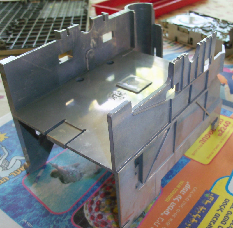

Here are some pictures from my work:
I took everything out of the box:

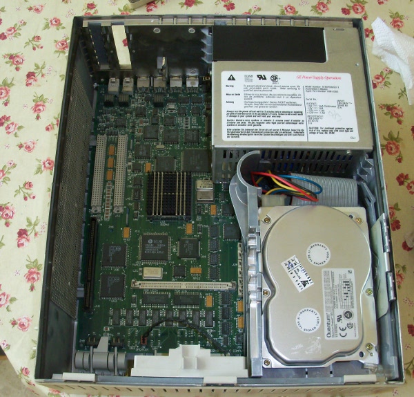

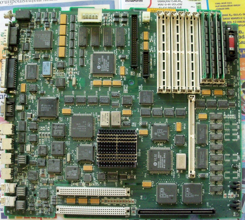

Motherboard:
I removed the battery:

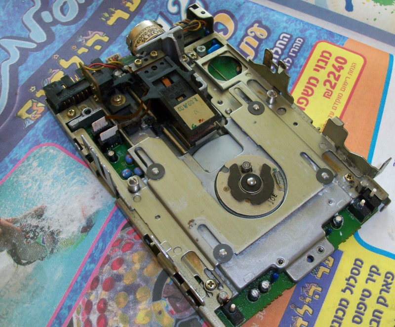

I washed the drive cradle:

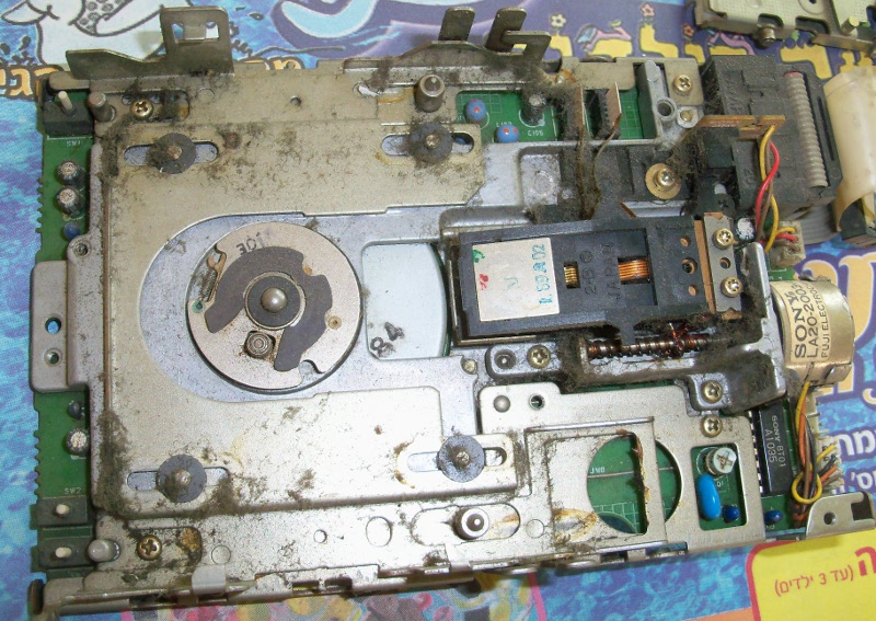

This is the inside of the floppy when I opened it. I had literally been packed with dirt:
And after I cleaned it:

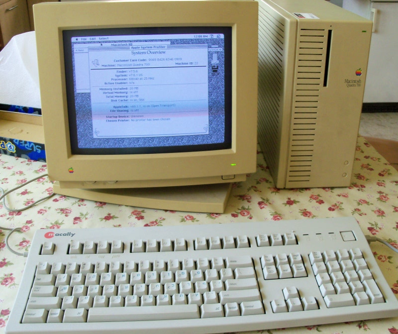

Everything back together:
And working (note the floppy icon):

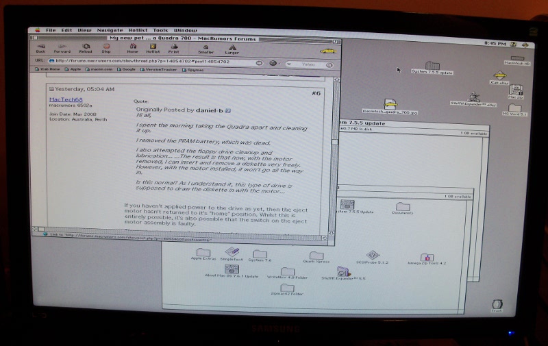

Hi all,
I thought I'd post one final picture to this thread.
This is the display of the Quadra 700 on my 24" Samsung monitor. It's really nice, although a little stretched. The resolution is 1152x870, at a stunning 16 colors. The Quadra 650 produces exactly the same display.

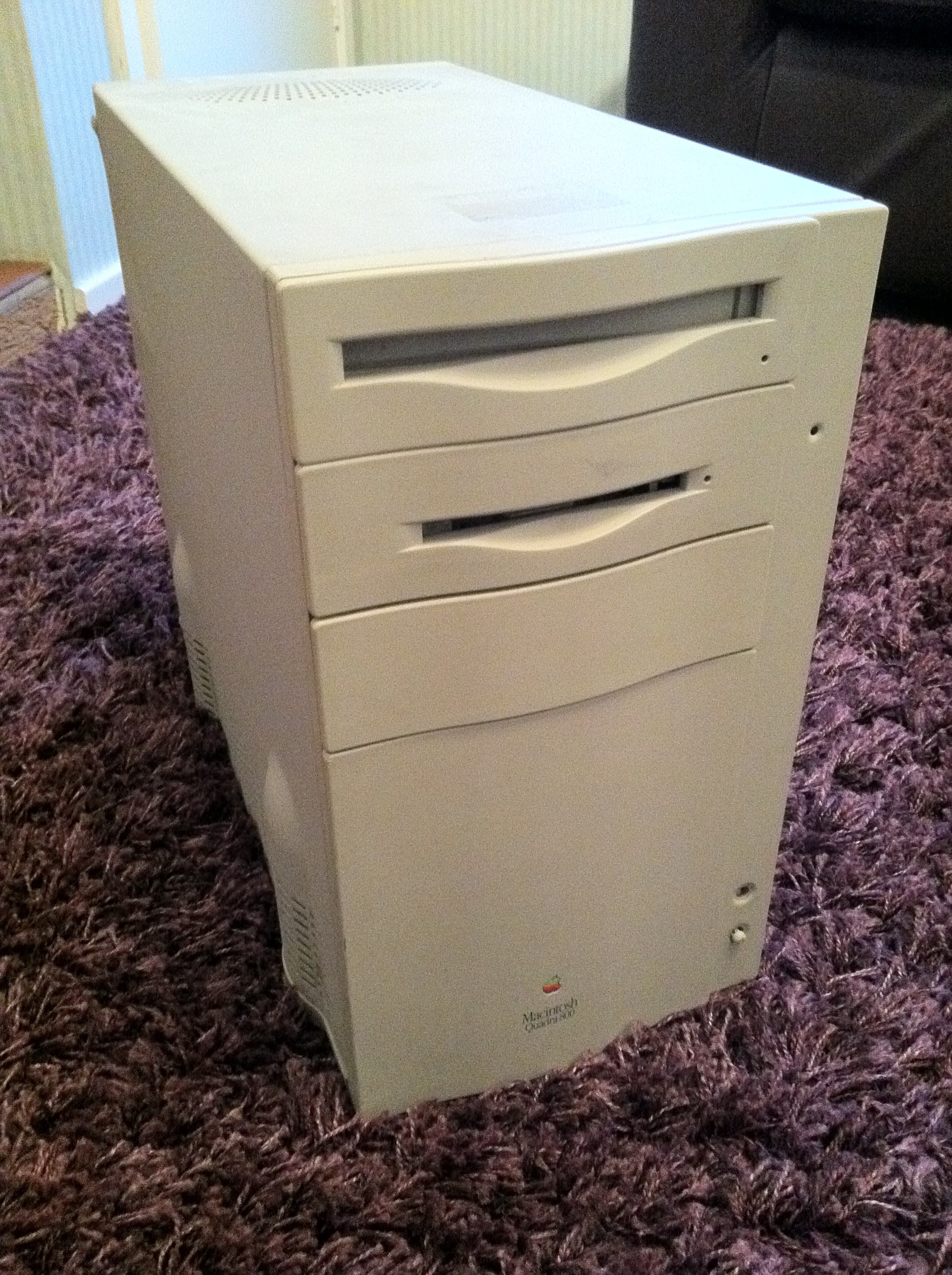

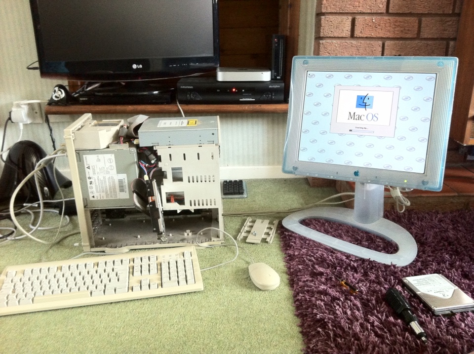

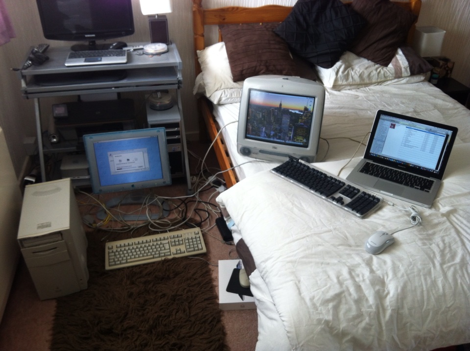

I know its not a Quadra 700, but here's my Quadra 800. I got an ethernet transceiver thru the mail, so I put it all together and tried to get it online, but the original 540MB HDD died. Luckily I had two in my Umax SuperMac S900 clone. I took one out and reinstalled 8.1 from an install CD I bought years ago. I could never bare to throw it out.
I used firewire to transfer some stuff from the MacBook Pro over to the iMac, and then used AppleTalk over TCP/IP to transfer to the Quadra. Also using AppleTalk, I can take files off it including some screenshots 😉
