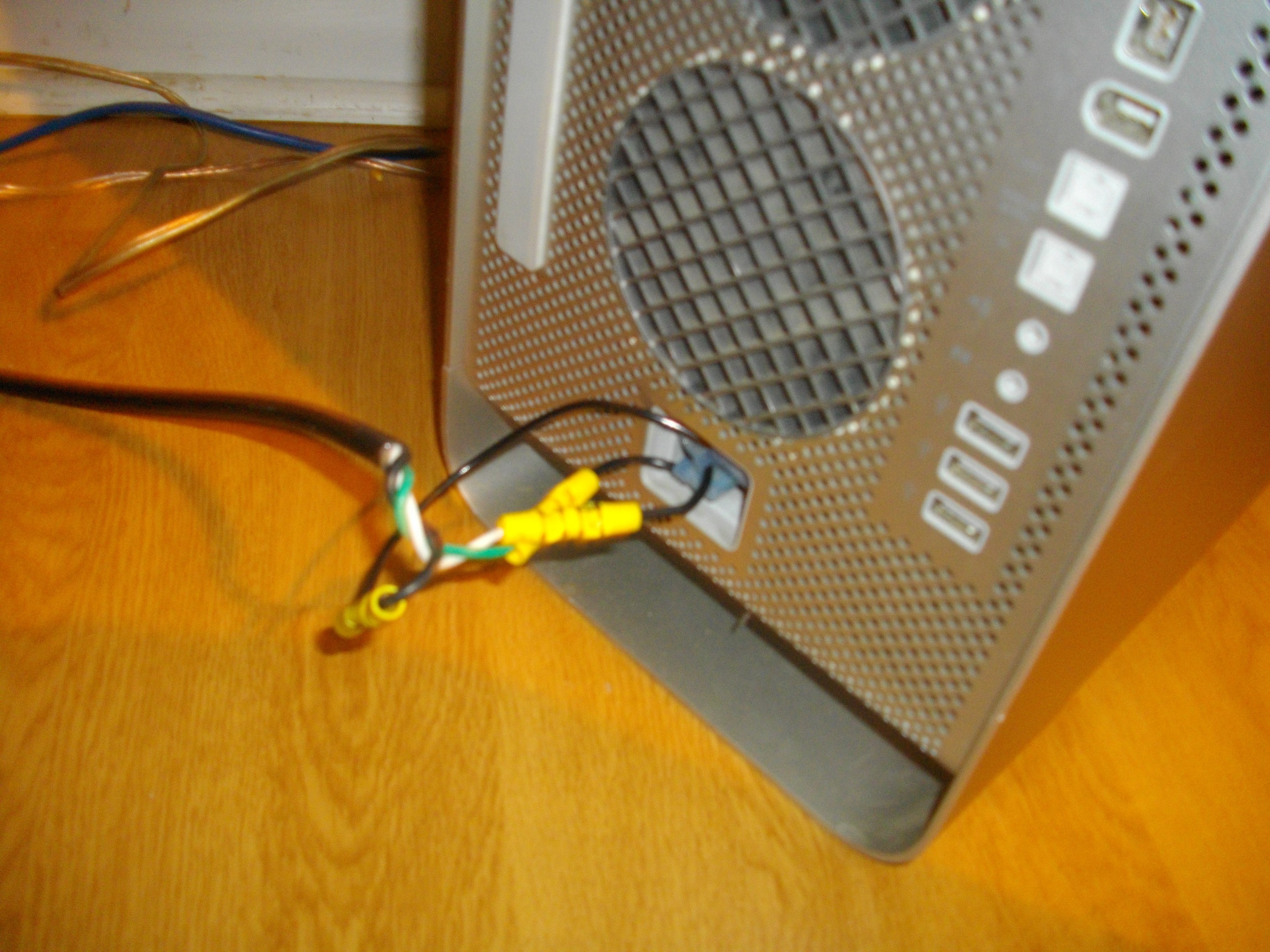

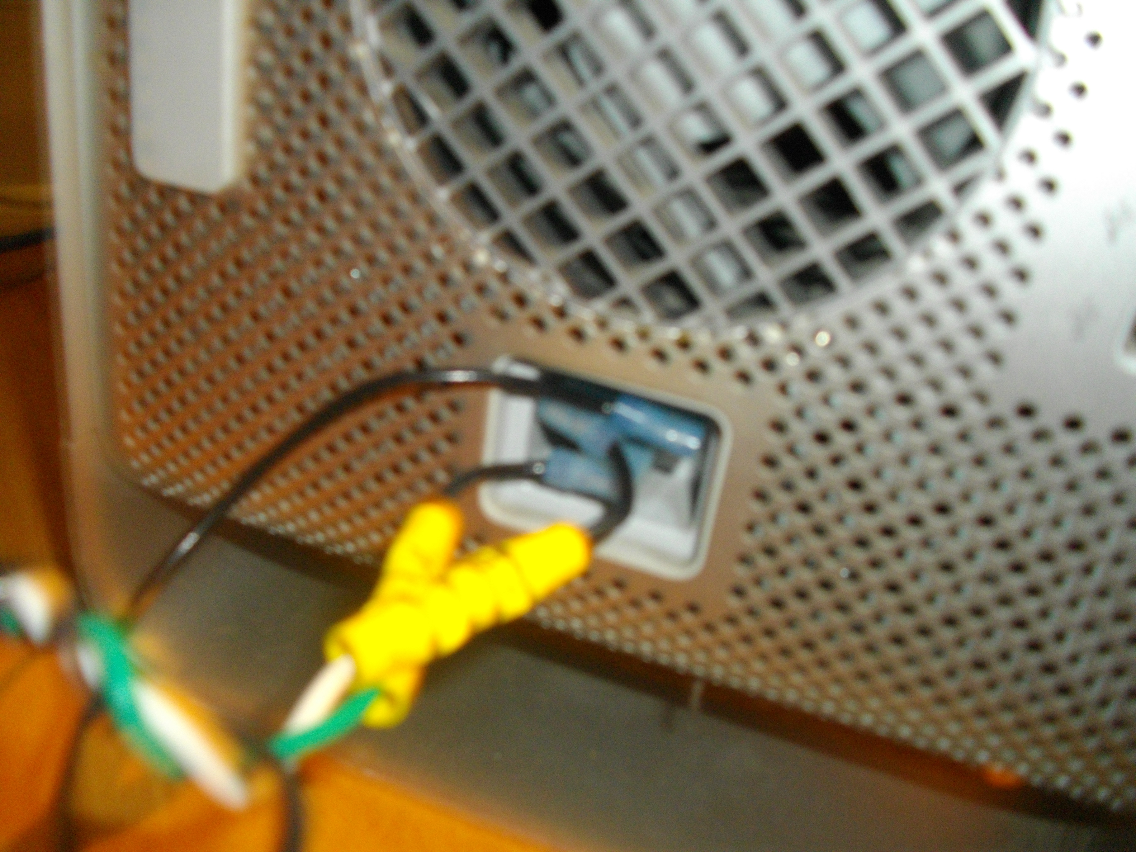

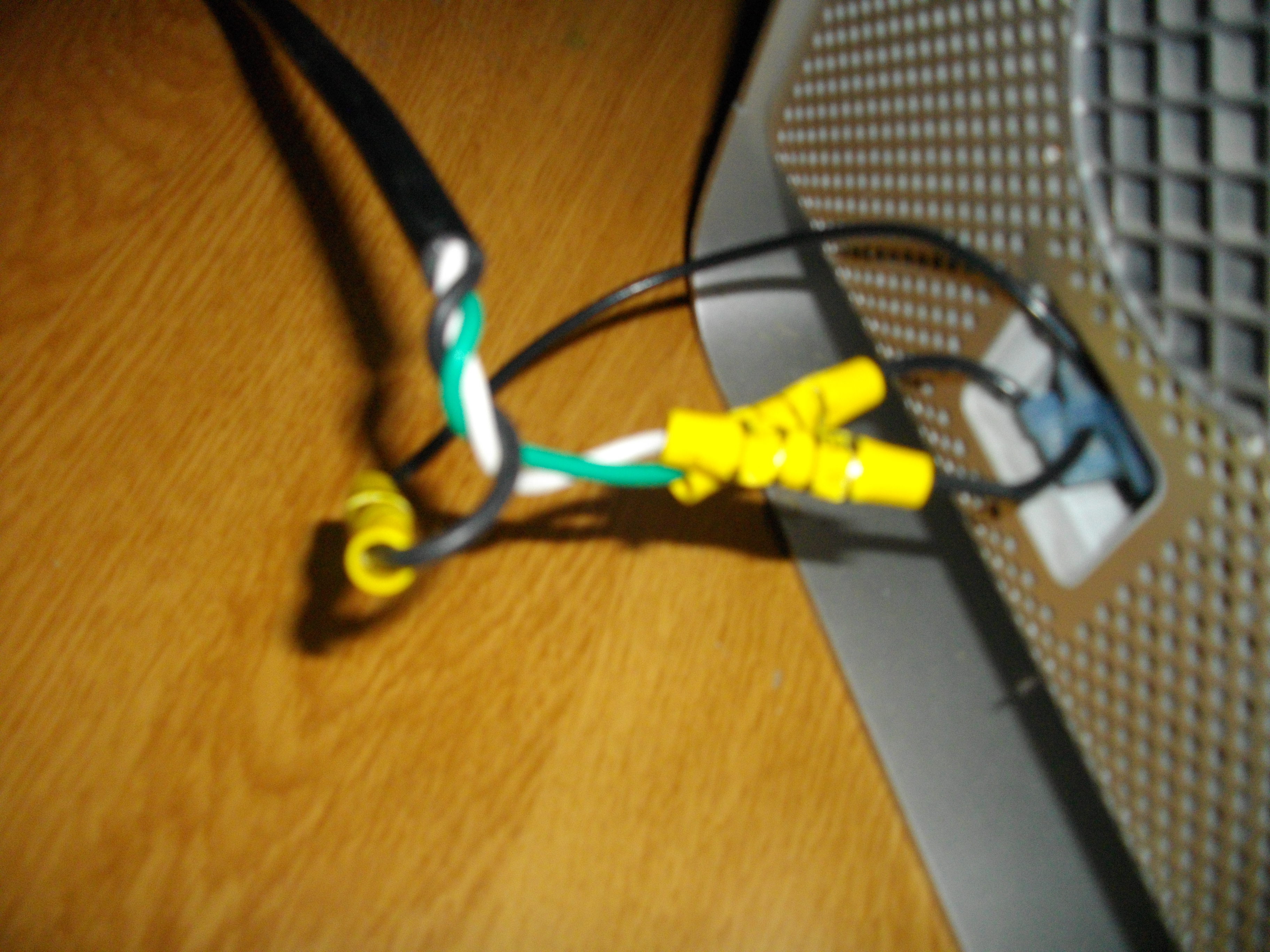

Well here is the pictures of the cord I had to rig up 😛

Just as a caution, it looks like you used fairly small gauge wire from the cord to your connections. I can't see for sure, but it looks like 20 gauge or smaller.
Depending on the G5 model, it will have either a 600W or 710W PSU. Assuming you are in the US and are on 120V, this is around 5-6A of current. I'd feel a lot safer using 16AWG at a minimum, and probably larger if possible.

I am in the process of getting an actual c19 power cable, but I have to wait until payday. This is a quite temporary solution, I don't really remember the gauge of the wire but my Dad said it was suitable for the time being (as he was the one who got the connectors from his work, and he is an electrician so ill take his word) 😛
But yes it is a pretty thin gauge of wire, I just don't think its thinner than 18 gauge... (also it doesn't look any thinner than the gauge of wire inside the c14 cord i butchered for it)
