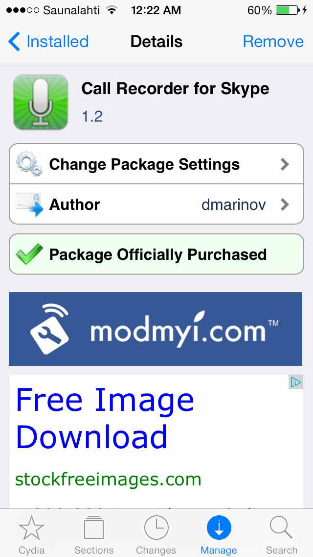

If you were lucky to purchase the $7 Call Recorder for Skype before its removal from the Cydia Store, you know it doesn't support the iPad version of Skype, only the iPhone one.
(Cydia main page, also showing I've indeed purchased the tweak)

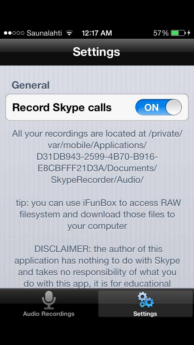

2, after the above hack, if you make a call in Skype for iPad, the usual SkypeRecorder directory will be created in the Documents folder of Skype for iPad. However, the /SkypeRecorder/Audio folder won't contain anything. The reason for this is, if it's a fresh install, it won't have recording enabled.
You can't enable it by just starting the Springboard icon of SkypeRecorder – after applying the hack, all you'll see is a black screen (and the subsequent exit after a while). This also means you won't have access to the usual Enable switch either:

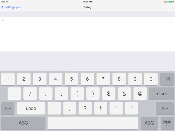

Fortunately, it's very easy to enable recording. For example, you can just install the iPhone version and, before doing the above hack, just enabling recording. You can also change this value right in the DEB file, before installing (this is what I've done, along with the first tweak explained in Bullet 1.) Alternatively, if you don't want to do this, you can directly edit /var/stash/Applications<postfix>/SkypeRecorder.app/Settings.plist and change the value of the (only) “e” ("enabled") key from 0 to 1, as is shown here:
After this, all (except for your first one) your calls will be recorded just fine.

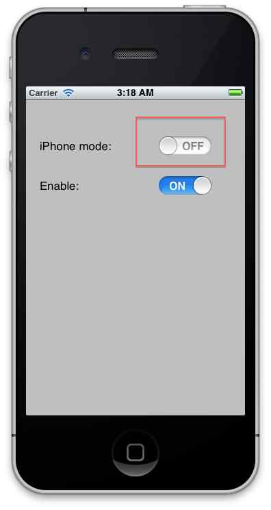

I've quickly coded an iOS app that allows for quickly changing between the iPhone and iPad version. As usual, the sources are open: https://dl.dropboxusercontent.com/u...kype ipad rec/SkypeRecorderSourceSwitcher.zip . They can be directly compiled and deployed from Xcode. As no scripting is needed to grant access / permission to anything, it'll work just fine without being installed from a DEB file, the pre/postinst scripts of which doing the root-userlevel stuff not available from "mobile"-userlevel Xcode apps.
The DEB file, should you want to prefer DEB files and/or lack having Xcode, is here: https://dl.dropboxusercontent.com/u....changeipadskyperecorder_1.0_iphoneos-arm.deb
Currently, only the uppermost switch (annotated below) works:
Later, I'll also wire in the lowermost, allowing for enabling recording from this app. Before that, enable recording using other means - for example, by installing the iPhone-specific client as well, starting it and flipping the switch on the second tab, before hacking the recorder to record from the iPad version. As I've explained in my original post, the latter makes the app useless.

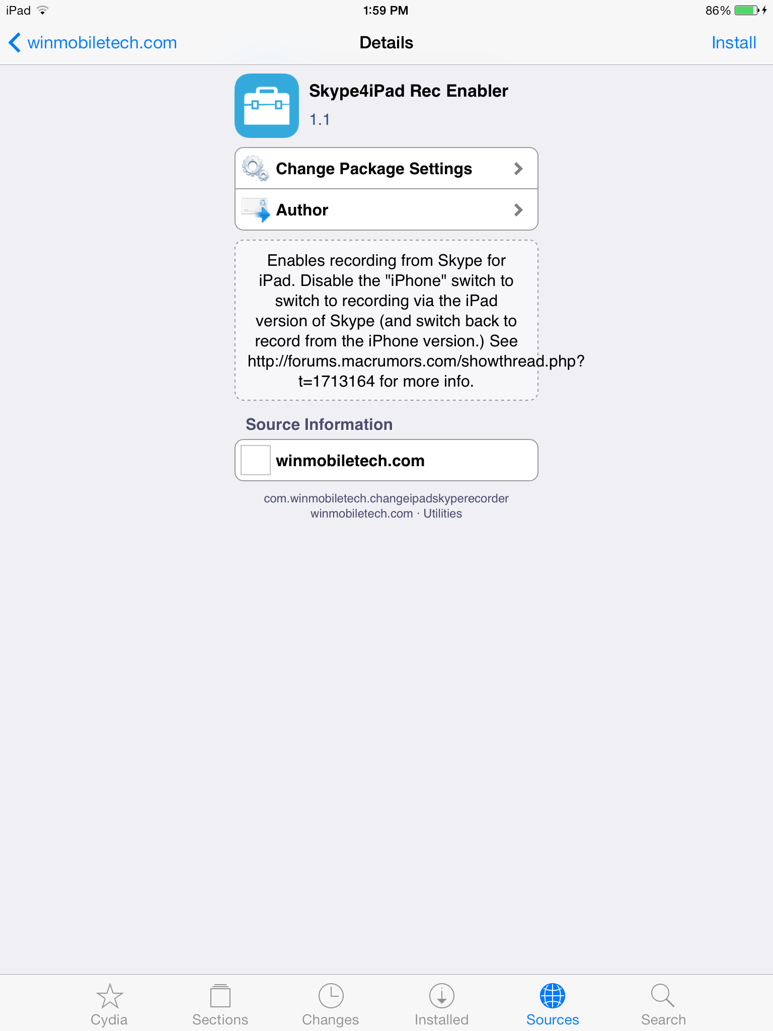

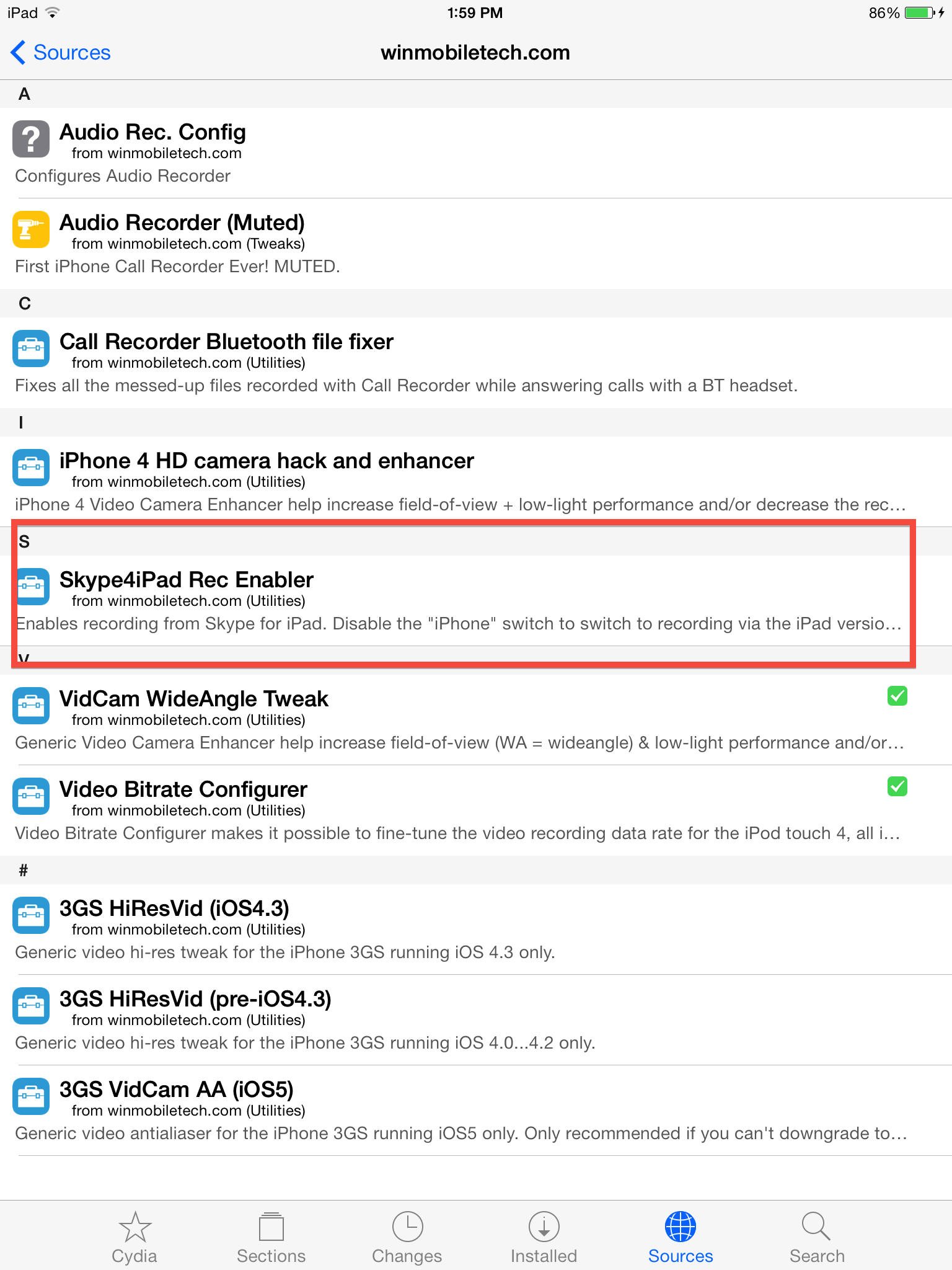

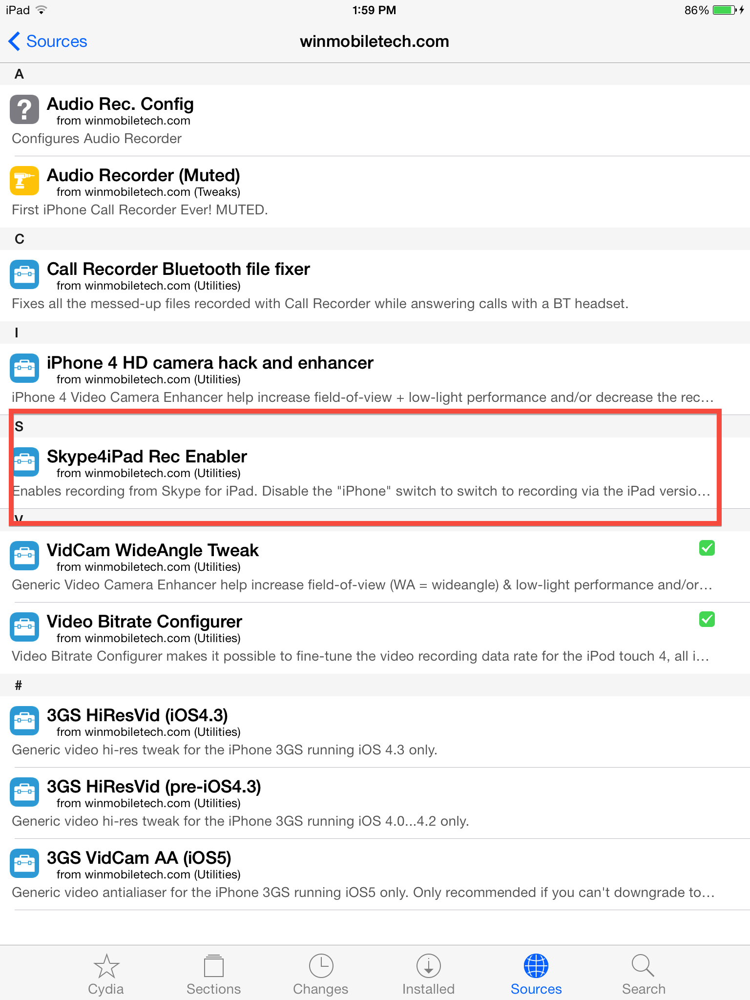

Final version released, with working lower switch to en/disable recording. This means, with fresh installs, you no longer need to manually edit /Applications/SkypeRecorder.app/Settings.plist or install the iPhone version of Skype to be able to access the switch on the second tab of the standard recorder.
It's also in my Cydia repo at http://winmobiletech.com/cy/ under the name "Skype4iPad Rec Enabler". (See the two attached images.)
The new DEB file link, should you want to install it directly: http://www.winmobiletech.com/cy/debs/com.winmobiletech.changeipadskyperecorder_1.1_iphoneos-arm.deb
and the source code link is the same as before. ( https://dl.dropboxusercontent.com/u...kype ipad rec/SkypeRecorderSourceSwitcher.zip )

1
, remember to respring after flipping both switches
2, on iOS5 and iOS7, do remember to make a bogus recording after any(!) kind of reboot / respring. Otherwise, your first call won't be recorded. This doesn't seem to apply to iOS6.

- install the stock Skype for iPad, the stock Call Recorder for Skype DEB file and my tweak (the order is unimportant - just don't start my tweak before installing Call Recorder for Skype. Otherwise, my tweak will immediately exit and will keep doing until you install Call Recorder for Skype.)
- start my tweak and make sure you disable the upper (iPhone mode) and enable the lower (Enable) switch. Respring.
After this, you can safely uninstall my tweak - it won't ever be needed (unless, again, you want to disable automatic recording).
