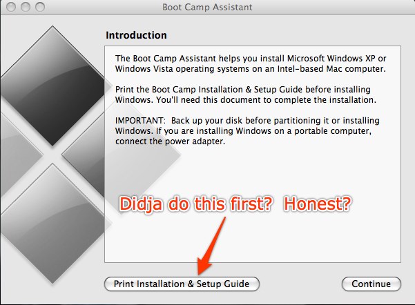

As for Boot Camp...

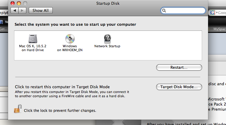

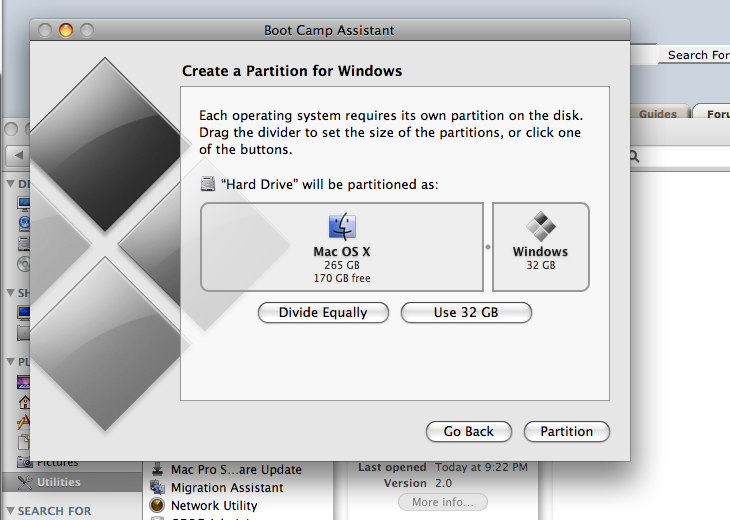

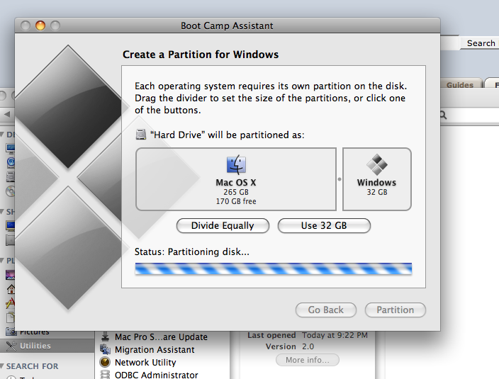

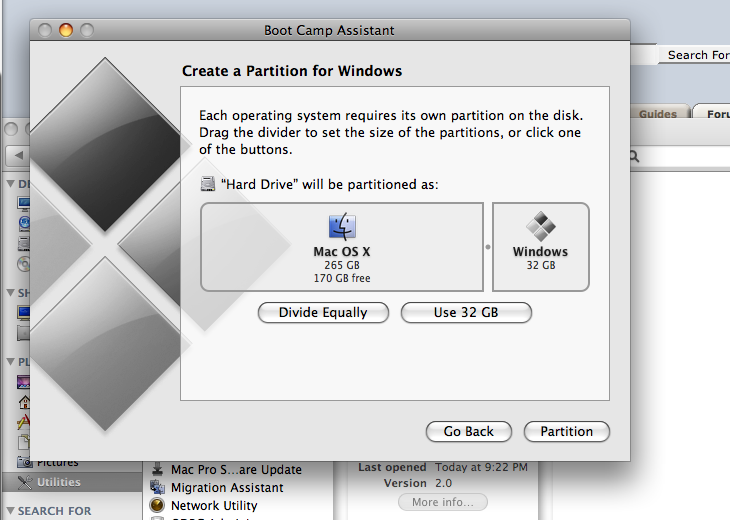

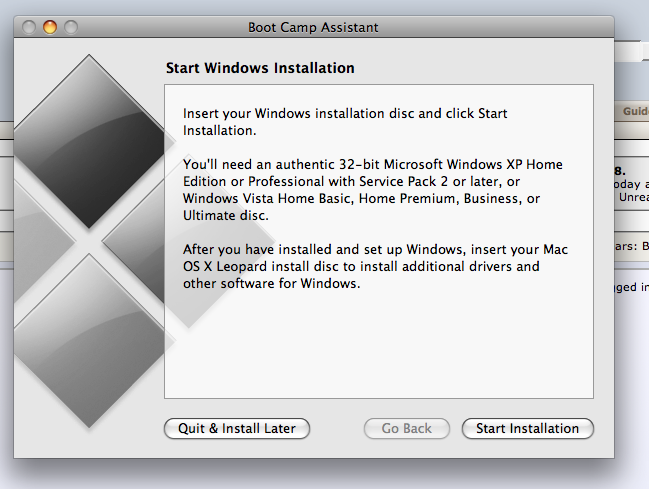

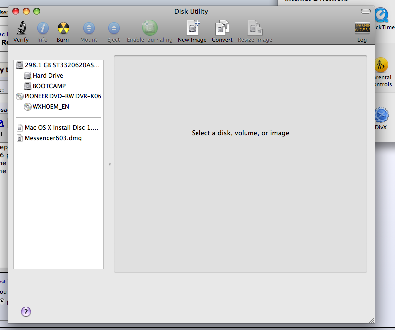

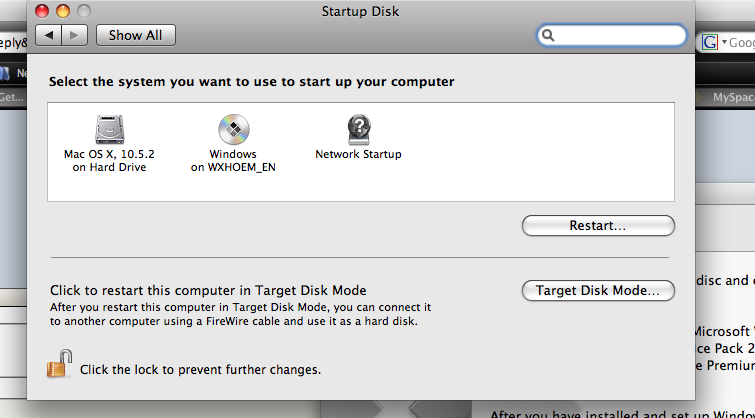

First of bootcamp, second of bootcamp partitioning, third of it finished partitioning, forth of disk utilities - where the partition can be seen, and last of startup disk of only one partition, couldn't be bothered restarting my computer to get the last image of the one "unknown" partition, known as my hard drive, called c, which i have formatted so many times now...

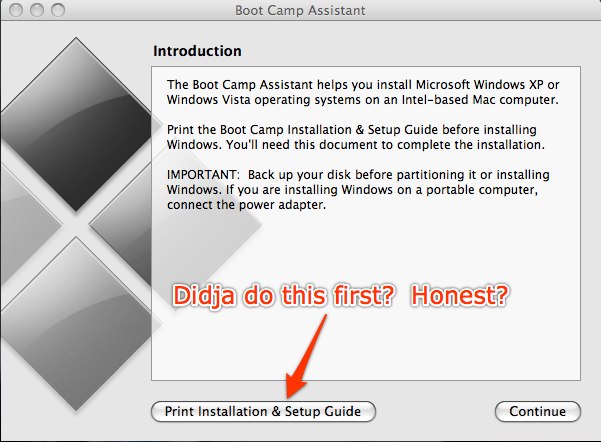

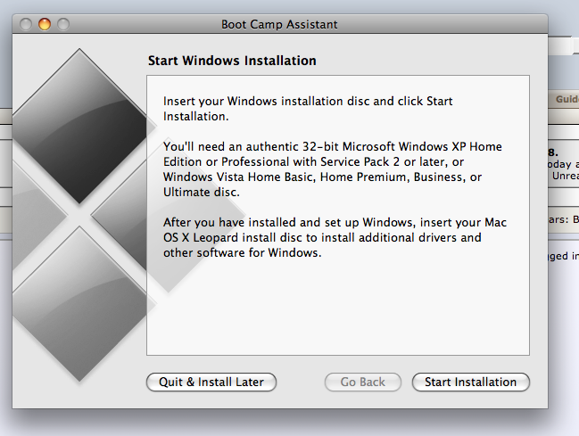

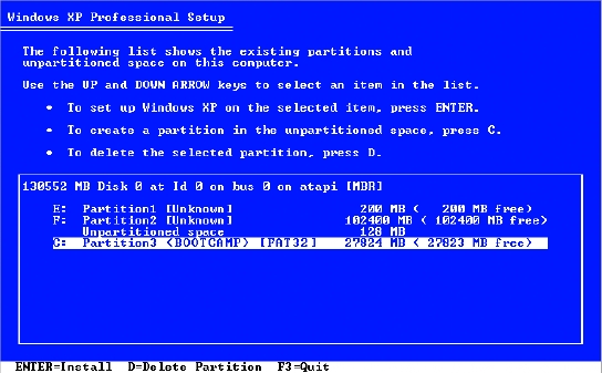

Everything looks normal thus far... when you go into Windows, and select a partition to install Windows on, select the one called BOOTCAMP. Remember to start the Windows installation by clicking the relevant button on the Boot Camp Assistant, and not by trying to tell your Mac to boot from the BOOTCAMP drive - that won't work.

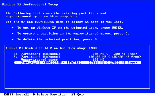

I know this is gonna be a pain in the ass to do, but could you take a picture of the Windows XP partition screen when your in the process of installing?
Dont expect to see the Bootcamp partition in the Startup Disc selection window until AFTER windows has formatted the Bootcamp partition and made it bootable.

yep, there is no other partition!! see how you have E, F and C with unpartitioned space, i only have one, called Partition One "UNKNOWN", like the top one of yours, but no others, so if i continue with the formatting - cause i only have one option, i clear my hard drive which i have done, twice... and i really can't be bothered doing it a third time, but yes, its being a bastard...
