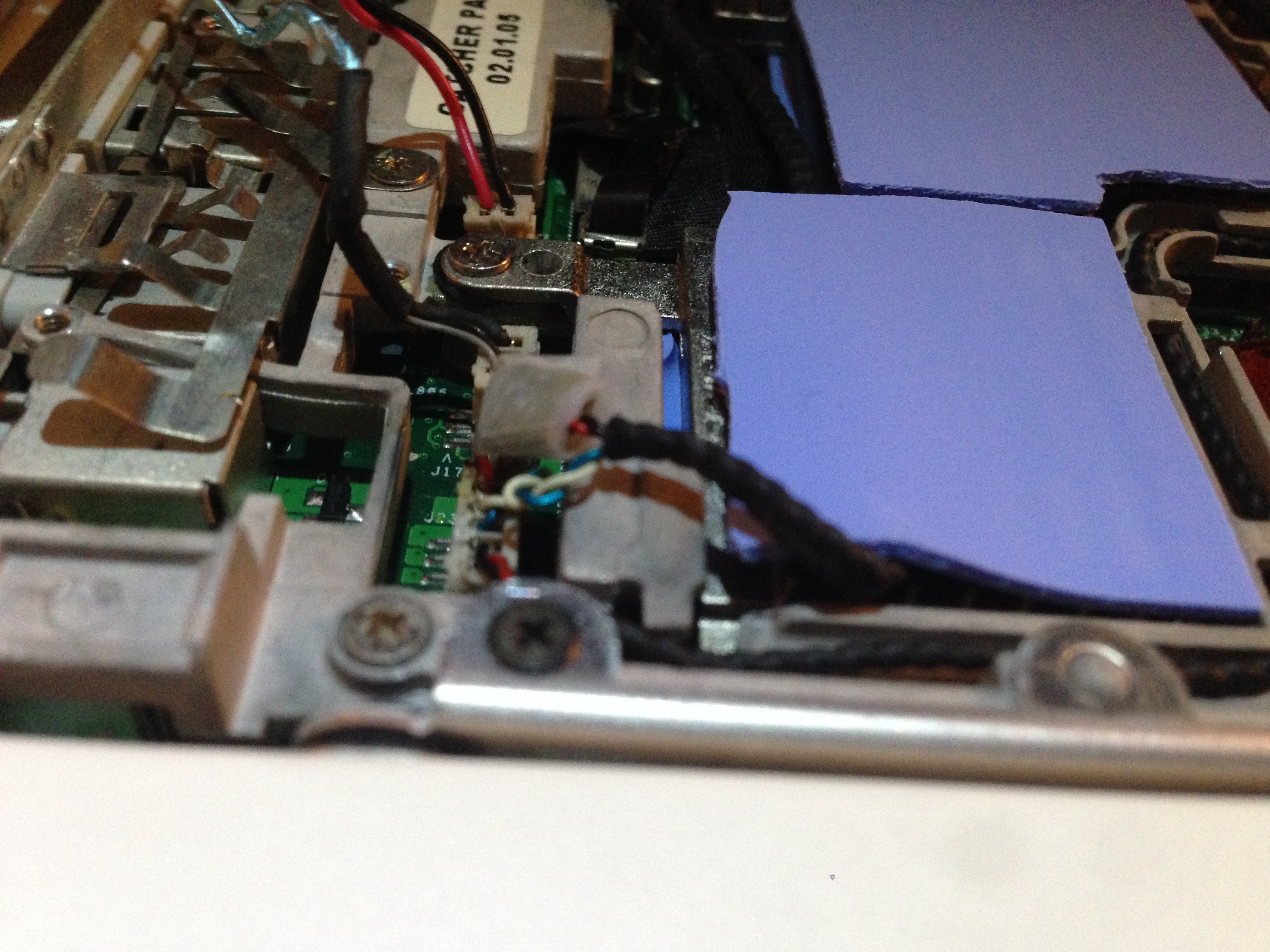

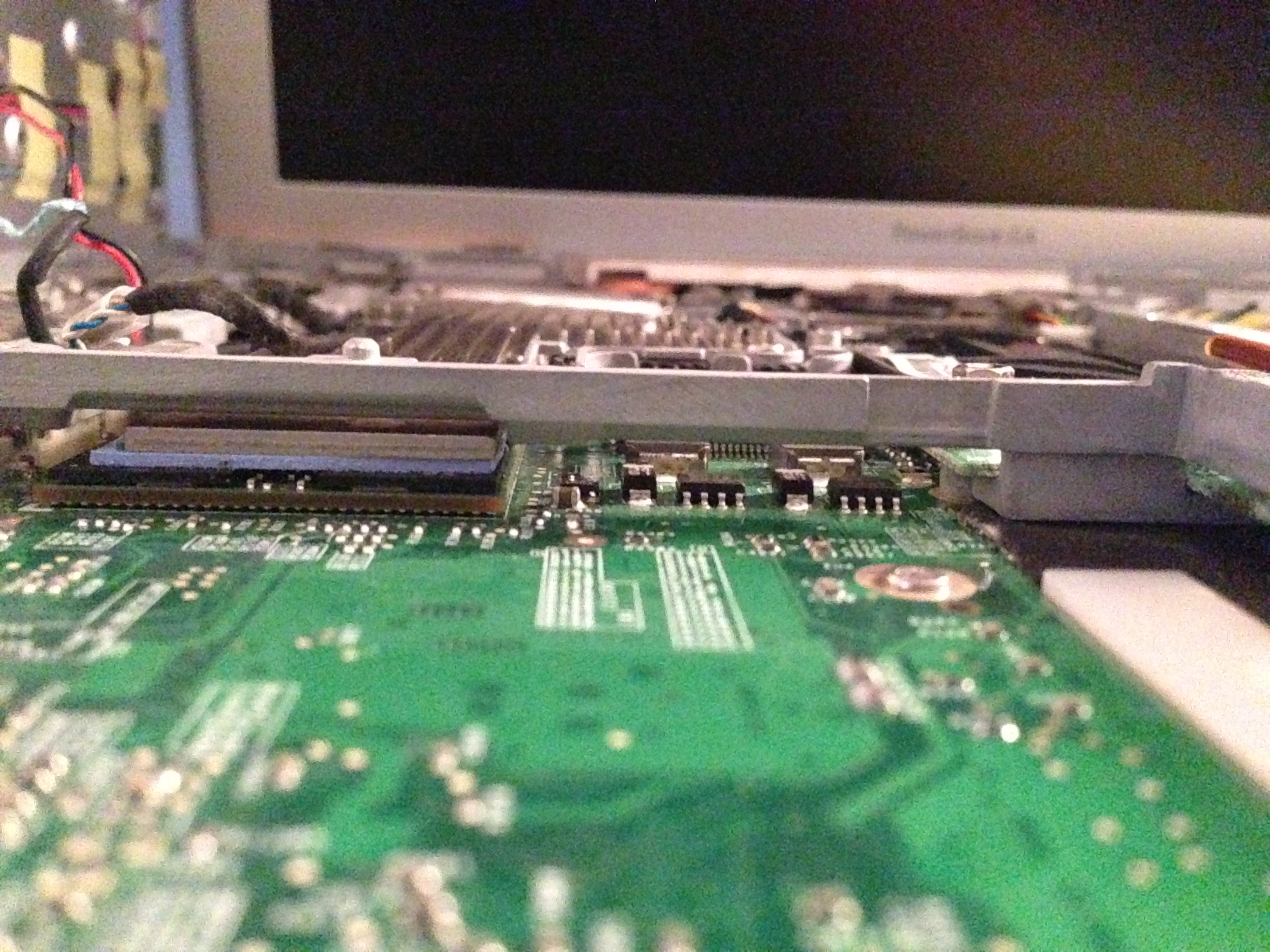

Figured I'd post several photos from my recent expedition into my PowerBook.
Here's the empty hard drive slot, finally dust-free. You can see the new thermal padding positioned under the heatsink.

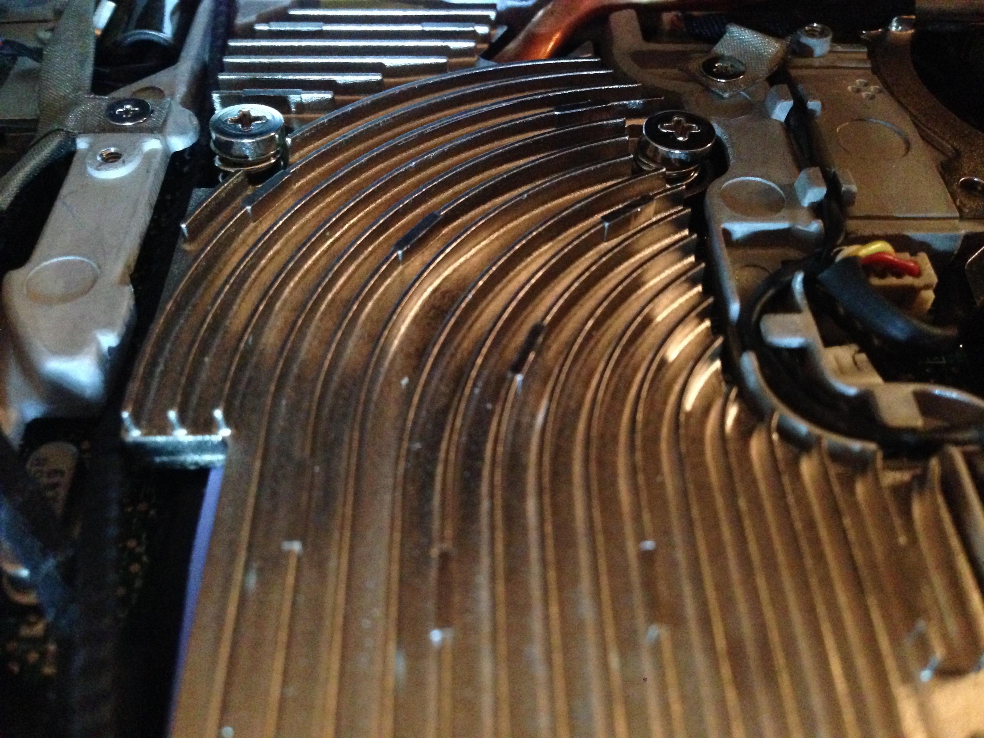

The hypnotic curved grooves of the heatsink. I thought this could potentially make a good background.
And as you can see, I tried Aphotic's method of placing thermal pads on top of the heatsink. (Which worked quite well. Idle CPU/GPU temperatures are reliably at or below 40 degrees Celsius and quickly return to manageable levels after intensive work.) Quite prominently, you can see part of the problematic wire I was going on about. I cut the loose wire piece off a little more, then wrapped adhesive + scotch tape around it to keep from interfering with anything. The actual microphone wires are located just above it, under the power wires. (My mic actually does work.) In the cable routing in the middle of the heatsink grooves back to the motherboard, on the right most side, there is a tangle of red/black wires looped around each other. The one broken off from the connector is the black one, which you can see just a little bit of before the makeshift guard covers it up. If anyone knows what that black wire, once looped around a red one both sourcing back to the black cable is, I'd be much appreciative.

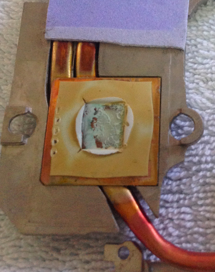

Hi everyone, I'm about to reapply thermal pads and paste to my G4 12" PB. Disassembly went just fine but now I'm clueless about what to do with the area shown on the picture.
The white stuff in the middle is thermal paste, but what's the flat brownish stuff around it? Should I scrape it off? Is that thermal paste as well?

Yes, that is the old thermal pad. You'll want to scrape it all off first. Best of luck!
