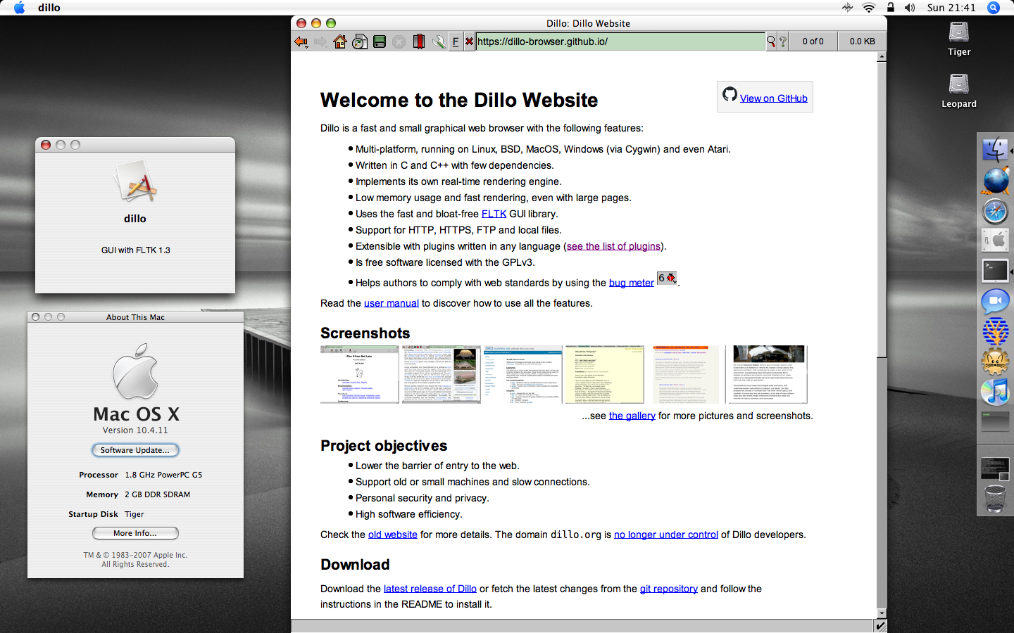

  • Next is building the Dillo web browser for PPC OS X. I know that Dillo is far less-capable than TFF-derivatives like Aquafox, however it should be faster for really basic tasks like browsing files on the Garden or reading static web pages. As I'm writing this, I've built one release using GCC7 but any with TLS have failed to build (OpenSSL1.1.1t from Leopard.sh, 1.1.1w from doctor_dog's MacPorts, OpenSSL3 from MacPorts, LibreSSL 3.4.2 from Leopard.sh...) - the tls-disabled build crashes when searching Google, so this may be a fool's errand.

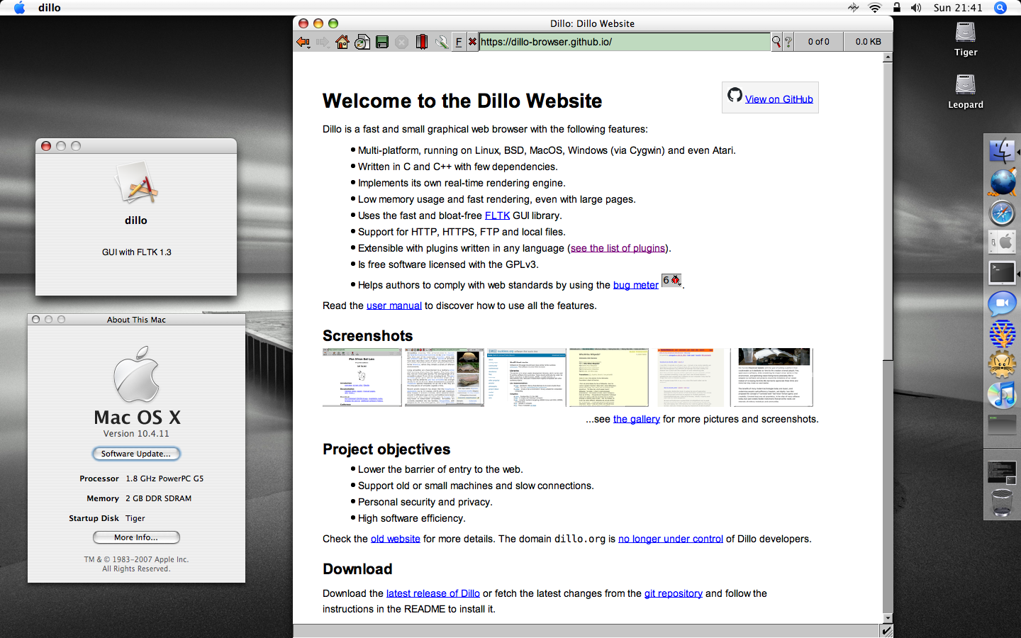

We've already got Dillo 0.3.1 built against openssl 3.2, zlib, libpng, libjpeg on tiger could use help on netsurf to be honest a few of us are struggling and I'm still working on arcticfox when I get free time. Here's a screenshot of Dillo built on tiger also has been built against leopard and I do not use SL Dps so untested
We've already got Dillo 0.3.1 built against openssl 3.2, zlib, libpng, libjpeg on tiger could use help on netsurf to be honest a few of us are struggling and I'm still working on arcticfox when I get free time. Here's a screenshot of Dillo built on tiger also has been built against leopard and I do not use SL Dps so untestedView attachment 2414110
