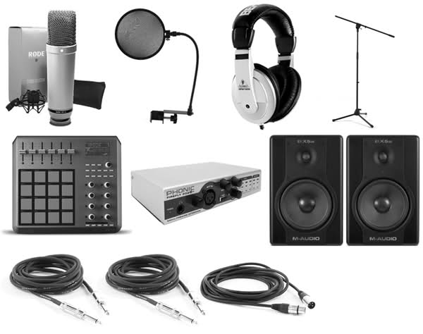

Pretty new to this all coming from a design background. Always
Wanted to get into music, so plan on giving it a shot. I hope to
make electronic sounding beats and rap over them ‘m.i.a’ sort of
vibe.
This is what I am thinking:
Rode NT1A Studio Condenser Microphone
Not the cheapest or most expensive I have seen, about £130
good reviews from what I have seen, claims to be the quietest,
not sure what that means exactly guess it is a good thing
Microphone Pop Filter for mic Stand
One thats cheap £10
Behringer HPM 1000 Headphones
These are really cheap £12 but they have gotten good reviews
M-Audio Studiophile BX5A Deluxe Monitors
Was initially looking at the Fostex PM04, but seems like M-audio
is a better brand, these speakers basically the same price
around the £150 mark and a little bit bigger
Akai MPD24 Pad Controller
I was initially going to get the Korg padkontrol, but saw a review
Comparing it to the Akai and the Trigger something by M-audio.
Basically the Akai won most of the categories and overall. £150
Phonic Firefly 302 Plus Portable Firewire Interface
Seems ok for what I want to do it cheapest fire interface I
have Seen about £130. I was considering a usb one but
heard Firewire Is better. I was considering the Focusrite Saffire
but its £60 more and seems like it does the same thing with
one extra mic input.
Boom Mic Stand
One that is cheap, but I am hearing the Rode mic is pretty
heavy so I may get a slightly more expensive one £10
Speaker Cable, Jack To Jack x2
Cheap ones £10
XLR - XLR Microphone Cable
Cheap one £5
I will be connecting this to my white 20’ imac 2.16GHz C2D 3gb
running leopard
This all costs just over £600, was looking to spend under £500.
Is there anything else you think I will/might need. Also are there
any cheaper or similar priced alternatives that will do a better/
similar job.
Any other tip or suggestions welcome
Thanks
Looks decent enough, comparable to the MXL V63M I just bought and the mic performs quite well.
The most important thing here is that it has phantom power, otherwise your mic is useless. It has that so I'll speak to why I went with a mixer over an interface. They both do virtually the same thing but the interface is FW or USB and requires software to run. You could run into latency issues more than you could run into them if you used a mixer with a direct audio-in input. My mixer (which I just bought) is a direct audio in. I was catching latency issues with a 1/4" standard guitar cable of all things but I've since fixed that. There is zero latency with the mic I use. Using FW will cut down on some potential latency issues. Your key would be to ensure you're using the latest drivers and such. I will also say that I was using a Tascam interface (USB) and the second I went to Snow Leopard it was useless. I am sure Tascam will fix it, but since it was a loaner I did not care.
Mic Stand
I am using a table top one, there are stands that are better but for me this is perfect. I assume you'll be fine with whatever you have chosen.
XLR - XLR Mic Cable
Be careful here as with cables you kind of get what you pay for or don't pay for in this case. Just keep in mind if you're having issues replace the cheap cables before you blame the rest of the hardware.
Yeah it'll be fine.
Again, you get what you pay for or don't pay for. I'm sure for basic recording you'll survive but you need to make sure you have highs and lows if you're going to monitor through headphones.
Similar to headphones you need to be able to hear all ranges. These are well regarded monitors as far as I know.
Same thing as the mic cable
I know little about these so I went with the review and it looks great.
You should be fine with this setup. It looks like the Rode has a shock mount, that is really to reduce noise from the vibration. I do not have one but I'm sure it couldn't hurt.
Overall I think you've chosen some decent starter equipment. Are you going to use Garage Band or Logic?
First, welcome to the world of home recording!
It seems like a decent setup to me. If you need to cut the price down, hold off on the controller for a little bit. A controller isn't essential, it's basically just a faster and more intuitive way to enter notes, create fades, etc. in your software. But that brings up the question: what software are you using? GarageBand is decent, but you might find yourself limited by the drum samples and instruments available.
it is popular, but i've little idea why. i think it's boring and too sizzly. in that price range, i prefer the AT2020.
neither mic is particularly heavy, even a a cheapo stand should do fine.
That is a good point, the pad is completely unnecessary for starting out as far as I'm concerned. It must be because I completely disregarded a need for it and I'm "just starting out".
Well, if he/she is going to be inputting any drums, I bet it would be a much easier workflow to play it in with a drum controller than to draw in the notes with a mouse. I would still recommend it.
I have the Korg padKontrol, and it works very well, but I usually end up playing drums with a normal MIDI keyboard because it is usually already out in the open ready for use.
Ok cool, 'zimv20' i did look at the AT2020 but wasn't sure if the shape
made it more suitable for other stuff rather than vocals? It is cheaper
but hasn’t got a shock mount.
I was thinking the headphones where just for listening to music while
rapping or singing. But yea £12 is on the cheap side. Could you
recommend any others?
I like the tactility of it I was planning on getting a cheaper controller
but this one seems to have the right balance. I tried musical typing and
making tunes normally but feel this would help me out as well as
make the process more fun/experimental.
'jessica.' I am not sure what your saying here, is there a mixer that's
a similar price? If I keep it all up to date will it be fine? I was planning
on upgrading to 'Snow Leopard' but I remember when I upgraded
from 'Panther' to 'Leopard' I had small issues with some other stuff so
I might avoid snowy, well for now.
XLR - XLR Mic Cable/Speaker Cable, Jack To Jack
Is there a way I can tell good cables, besides the price as I don't really
want to pay more than I need to.
Software I was thinking of logic, but I need to look into it a bit more,
'reason' and 'fruity loops' are also options, but I know even less about
them.

The shape won't make a difference. Both the Rode NT1 and the AT2020 are side-address microphones. The Rode just doesn't have more metal at the top of the mic.

Is the shock mount important? i read somewhere
that the AT2020 is noisy not sure what they meant
by that thou.

You're not getting far with a condenser mic and no shock mount... also (now this came up just recently in another thread...) how quiet is your room? Is this stuff living in a room with any kind of sound insulation, or is it just in a bedroom or spare room or somesuch? The condenser might be really important to capture the vocal subtleties for this kind of music, but you're probably going to be dealing with a lot of noise elimination.
Also as far as the pad goes, it's probably a good place to look for something used if you're on a budget. But I'd guess that for doing beats and rap, it'll be really nice to have one.
yes. it isolates the mic from room vibrations that would otherwise translate into sound in your recording.
i read somewhere
by that thou.
it probably meant they don't know how to properly gain stage (youch!).
try both and keep the one you like.

all the studio video/pictures ive seen from pro's and people doing
what i want to do ive mostly seen large diaphram studio condenser
'Liquorpuki' Ok cool, i'ts a toss between this mic and the AT2020
it is cheaper but doesnt have shock mount. Yea i guess it will be
Hip-Hop as i'm plan to rap over beats. I am rather new to the MPC/D
world i saw a guy make a some on youtube it sounded good so that
was part of my inspiration, i have tried keyboards in the past but
i think i would prefer pads.
Mic location: If i make the booth it is going t be risght next to the desk
with all my other stuff on
Thanks Again for the replies

'zimv20' ok cool thanks for letting me know, the guy i spoke
two seemed to think it was a great idea, but he was just random
dude from the net so its cool. Actually saved me alot of time and
money as im not greatest at D.i.y. I will look into traps but will
probabily leave this till im all set up and running, or maybe not
bother due to lack or wall space and money.
