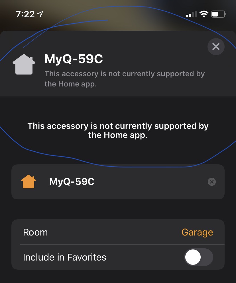

So frustrated with My Q. I’ve had to reset the hub several times over the past few months. Now it won’t pair with my garage door motor (made by chamberlain by the way) and on top of that Home now says that the “HomeKit” hub is not supported?!?
Any one have tips or tricks to get these set up? My Q is by far the worst HomeKit accessory I’ve ever owned.

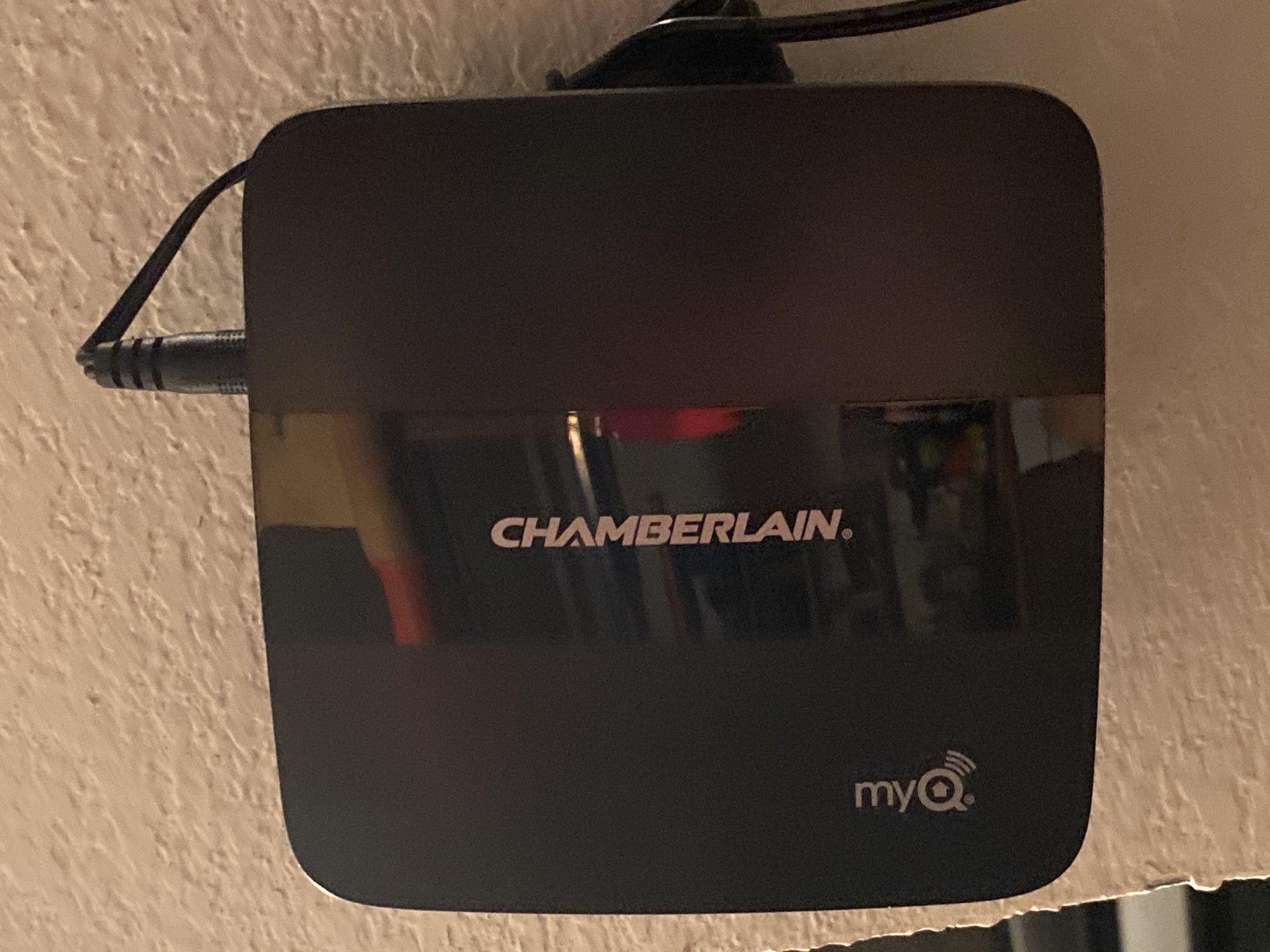

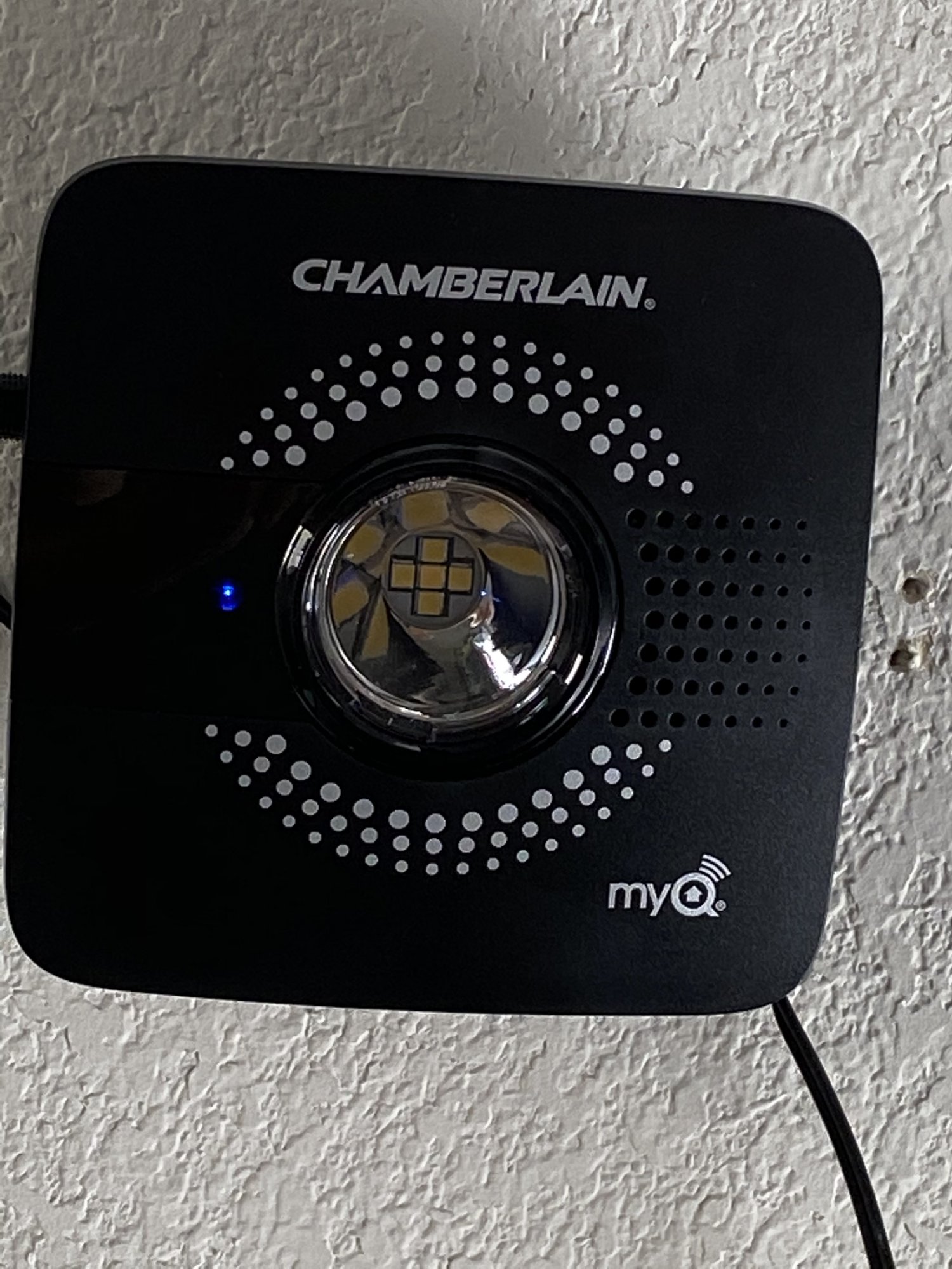

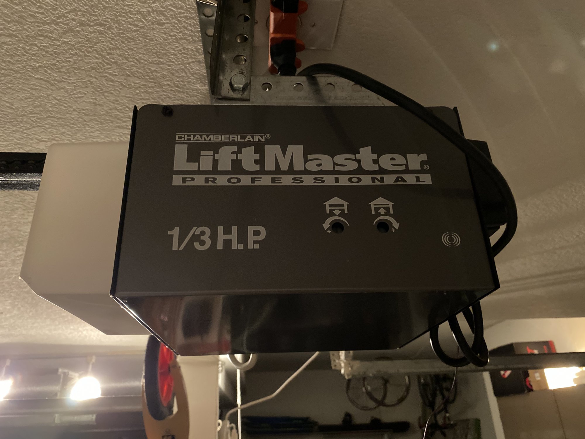

Lol. Ok here goes. First photo is the garage door opener. Regular dumb Chamberlain Liftmaster garage door opener (not WiFi, not smart, not MyQ). Second photo is the MyQ hub. That’s needed to make the garage door opener smart. Third photo is the Chamberlin HomeKit hub. That’s needed so MyQ talks to Homekit.
The issue I’m having is that the MyQ hub (second photo) won’t pair with the garage door opener (first photo).

So, update. I got it working but I still hate MyQ.
I ended up buying a new MyQ hub. Figured maybe mine went bad. Got home, started the set up process ... same let down. Won’t connect. Over and over again. I must have spent an hour up and down the ladder trying to get the MyQ hub to pair with my garage door opener but no go. I was ready to give up but noticed that the MyQ app has an option to search for codes for none supported brands of openers (reminder that my opener is supported - It’s made by Chamberlin). Fired that up and it connected within 30 seconds 😵! Seriously WTF!
Anyway, it’s up and running. Set up the HomeKit hub and all is right in the world again.
