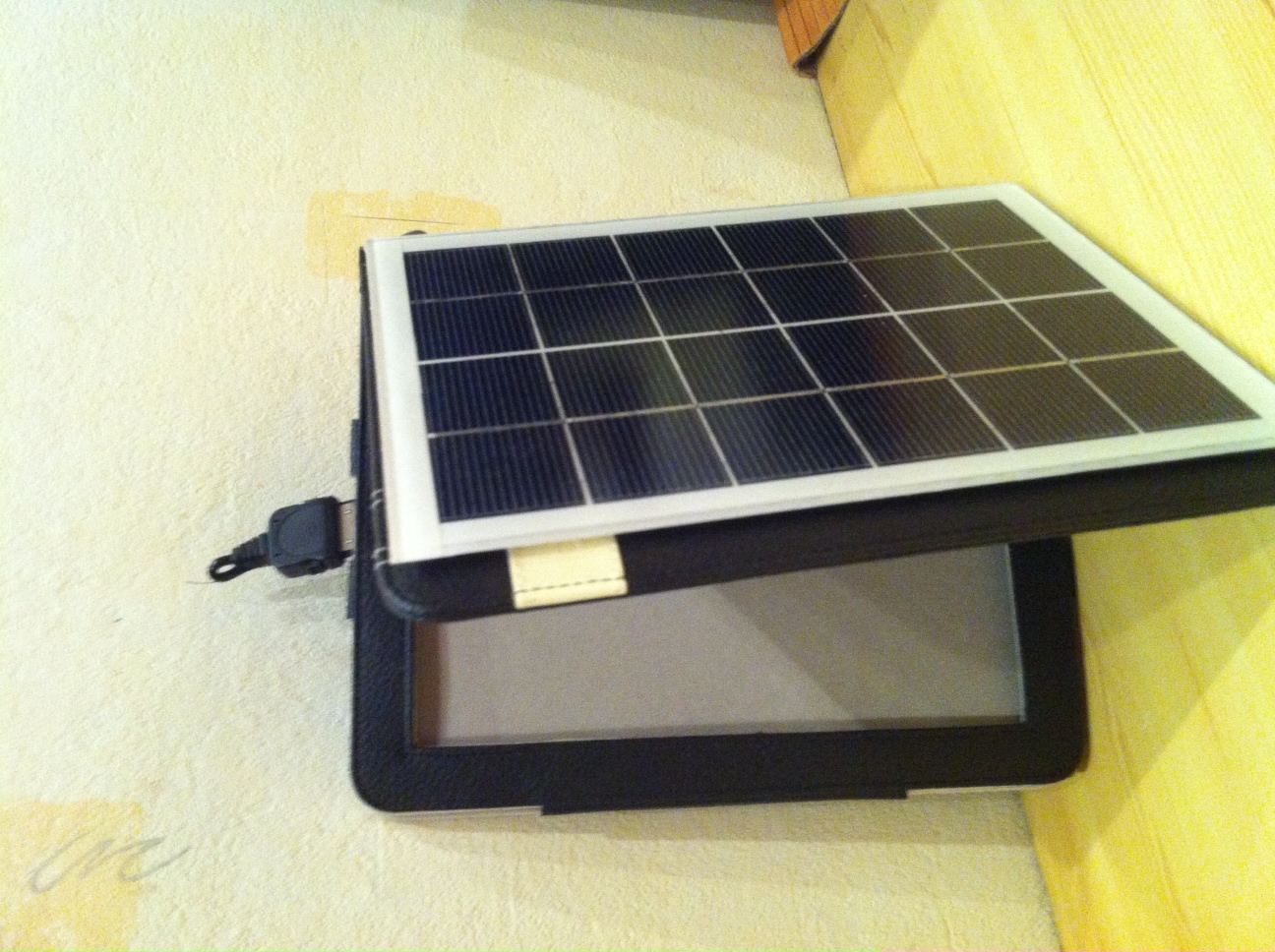

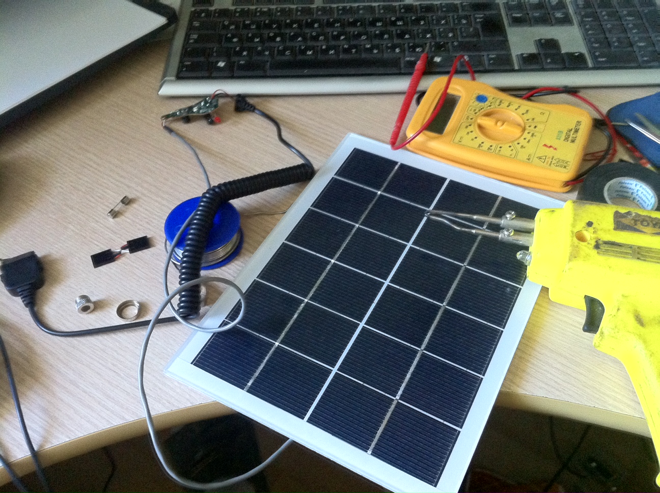

Recently I've been thinking of what king of interesting accessory for iPad I can make myself. And I have come up with a leather case with solar panel in it. I have made a prototype - it works fine. And I'm thinking of making that kind of cases for other people too. 😀
Anyway, after careful studies of the market I'm having now a good supplier of solar panels that are thin, light and powerful. A good supplier of leather, and a person who can put it together. The only thing that I'm missing - funds. 😀😀

I actually kind of like it but do have a few concerns.
1: the size of the case. Obviously you need a 30-pin connector at the base so you're looking at something a bit larger than average.
2: keeping the ipad "plugged in" to the case. Leather is pliable so I could see issues with it being able to keep the ipad plugged in to the 30-pin connector so that there's always a solid connection
3: fragility. You're putting a fairly large solar panel on the front of a case. That basically removes all of the protective properties of the case since you now have a fragile panel on the front that also needs protection. You can extend this into the 30-pin connector. Since leather is not stiff, the possibility of a short seems greater.
4: heat. Solar panels get pretty hot in the sun. Is the case going to be useable after the ipad has been sitting there charging for an hour? What about transferring that heat to the ipad since they are in such close proximity? iPads have been known to overheat in direct sunlight before. I could see the panel causing the same issue.
I hope you don't take offense to my list. I really do think it's a great idea that has a lot of potential. I just see several areas where pretty substantial issues could effectively ruin you. Hopefully you've already considered all of these and have some ideas. You've actually rekindled the similar idea that I had back when the original ipad came out.
