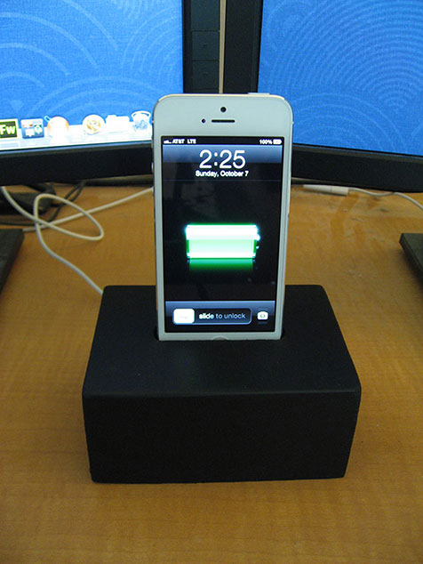

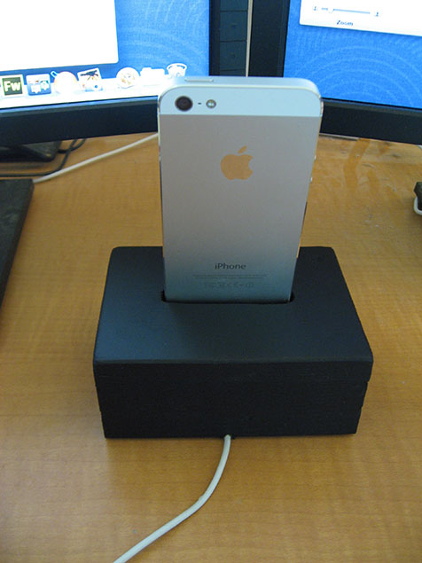

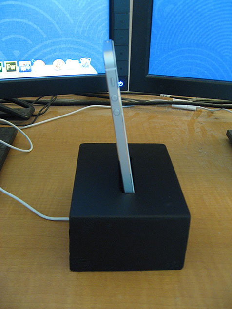

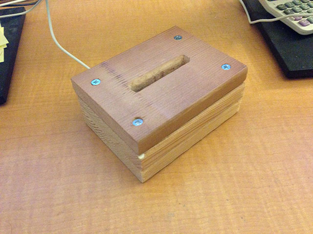

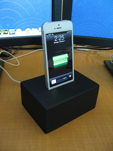

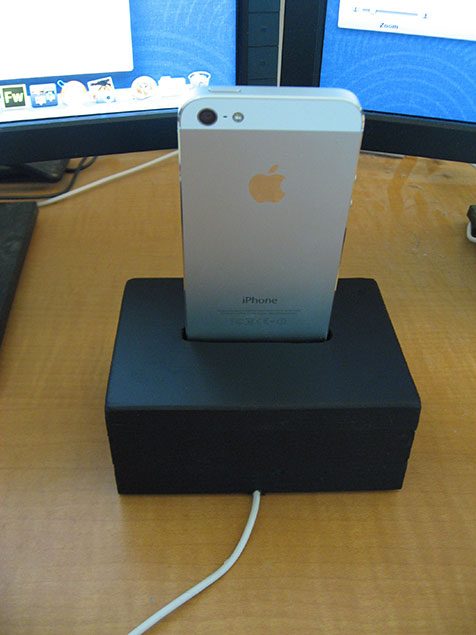

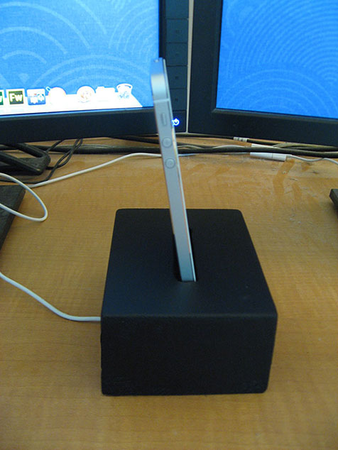

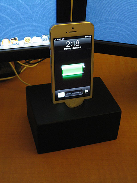

But that means instead of sliding it on my table, I'm going to need a dock. Since Apple has no plans as of yet to make an iPhone 5 dock, I just converted the USB lightening cable into a charging dock with some crap wood, screws, sandpaper, and paint:
attachment.php
attachment.php
attachment.php
attachment.php
I purposely made it a bit taller/deeper than most for stability, and I admit, it's kind of ugly, but hey, it does the job until a real dock is made available.
I suck at woodworking, and it took about an hour and a half. I snapped some pics during the process is anyone is interested.
All in all, I'm pretty happy with it until someone better comes along!

Good job you did there and very well put together!
My iPhone 5's just lying on the table atm haha 😛
Thanks!
haha I know, I was going to just leave mine on the table too, but going naked with no case/bumper, it just didn't feel right.
Very nicely done!! 😀
I'm assuming you really don't need the functionality of the home button on the dock correct? 😕
Yeah, I don't need the home button in the dock.
I can always just drill out that area if I do, but I really don't.

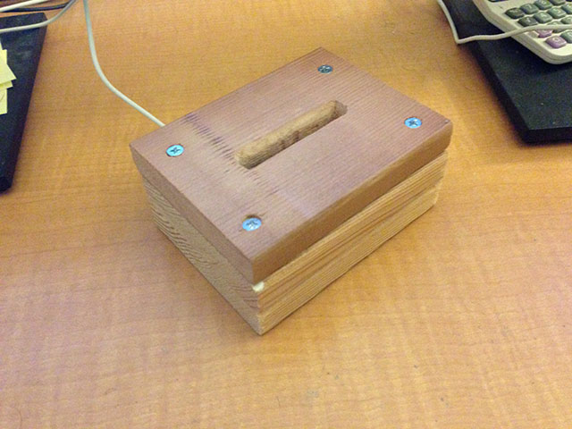

That looks nice. can you post some pictures of it with out the phone? can you pull it out without bringing the cable with you? pictures of the bottom? i guess i want to see how it;s made see if i can make one too 🙂😱
Sure, no problem.

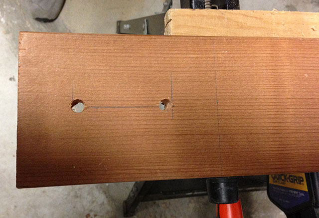

Here are some construction pics. Again, I really don't know wood working at all.

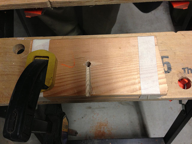

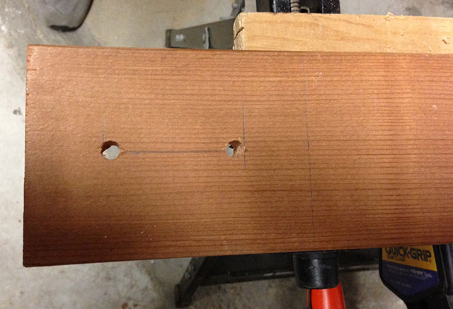

At first I just grabbed a piece of scrap and then measured the width of the phone. Drilled a hole at each end of the scrap using a 19/64" drill bit:
attachment.php

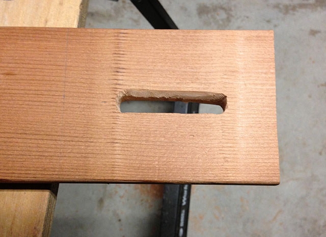

Then just kept drilling along the line connecting the two holes.
Then filed it down a bit with a slight bevel on one side so it leaned back.
attachment.php
On the bottom I just filed a groove for the cord:
attachment.php

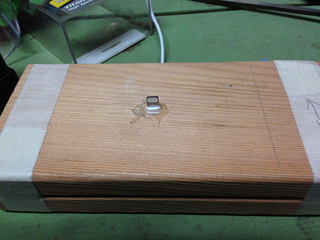

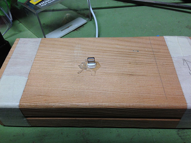

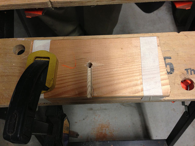

Took two more pieces of scrap wood and taped them together.
Drilled a hole through each of them with a 5/16" drill bit for the lightening connector, and stuck it in place by filling the entire hole with a glue gun:
attachment.php
Screwed all the pieces together in the corners and then cut off the trim:
attachment.php

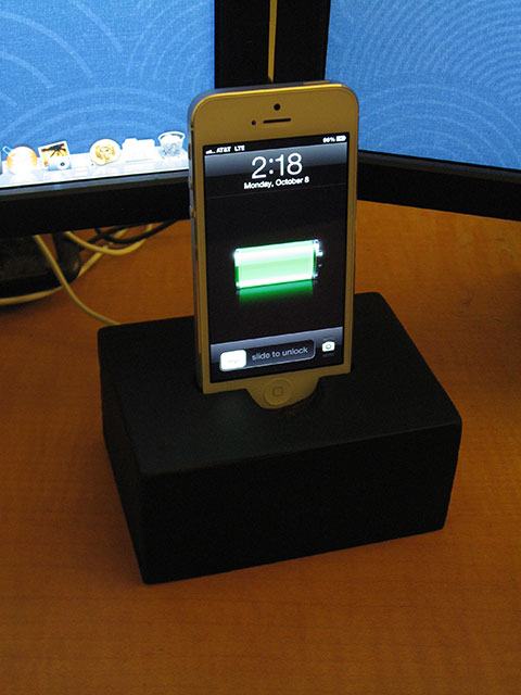

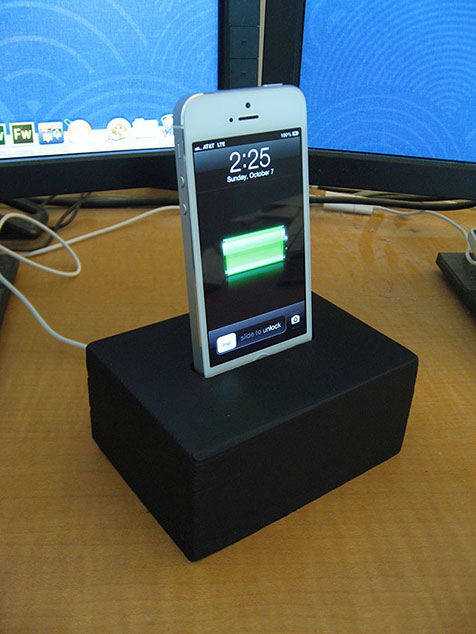

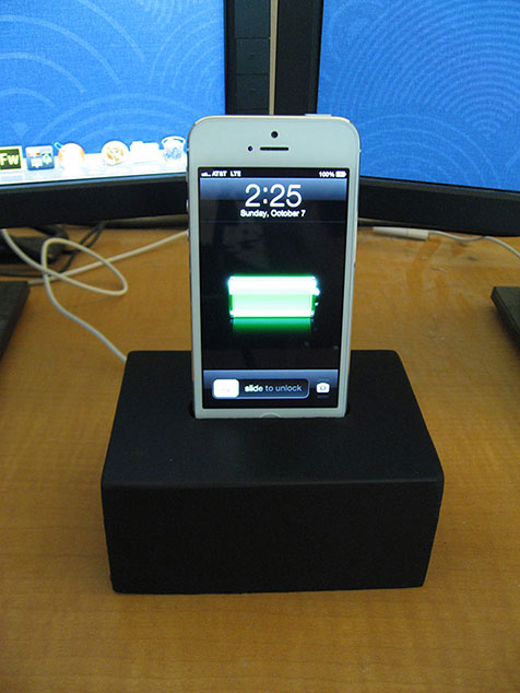

Sanded and painted it. Then after the Saints/Chargers game tonight, thanks to the idea from this thread, just in case I used a Dremel to notch out a smooth groove for the home button just in case I want to use the phone which is locked in the dock:
attachment.php
Again, it's kind of ugly, but it fits like a glove and really locks into place.
Should hold me over for quite a few months until a better option is available.
If anyone wants to make a similar one and has scrap wood lying around, it's a nice cheap option. Works great!
