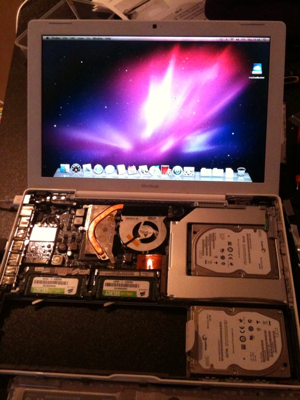

I had set up a RAID 0 in my MacBook in order to squeeze some extra life into Aperture. This was with 2 Seagate 500GB 7200rpm drives.
Seems that the idea was a good one but didn't take into account the processor overhead needed for the software RAID. The performance of my system actually decreased even though disk activity increased.
I ran GeekBench and XBench. The GeekBench tool gave me 1507 with the RAID, and 2768 without it.
Xbench was 113.97 without the RAID, and 83.84 with the RAID.
Uncached Write/Read scores were all higher because of the RAID but like I said overall system performance took a hit.
I did this because I didn't want to buy an SSD at the moment. Was wondering if I would get any gains from the RAID 0.
The upside to all this is that I have a backup drive in my laptop next to the main drive, and when I do get the SSD, the secondary drive is already in there waiting for when I transfer my image and music libraries.
Anyway just thought I would let everyone know. Enjoy the picture.

what connector is your optical bay ? is it also sata? if not that would be why your speed is dropping.
otherwise your speed should only increase even with the overhead, i have run dual 80's , 160's ssd's and dual 500gb 5400's and they always consistantly operate 30-40% better in striped array's.
maybe we can figure this out, there must be an issue somewhere with the setup.
can you post your full xbench.....thanks

Looks like his MacBook is a whitebook. I think that makes the optical bay a PATA connection.
Okay here are the full results that I have written down for XBench as a single drive:
Sequential
UW 80.27MB/s - 4K blocks
UW 78.93MB/s - 256K blocks
UR 16.84MB/s - 4K blocks
UR 80.19MB/s - 256K blocks
Random
UW 0.79MB/s - 4K
UW 38.61MB/s - 256K
UR 0.58MB/s - 4K
UR 25.62MB/s - 256K
In the RAID 0:
Sequential
UW 77.38MB/s - 4K blocks
UW 53.61MB/s - 256K blocks
UR 8.19MB/s - 4K blocks
UR 99.71MB/s - 256K blocks
Random
UW 2.70MB/s - 4K
UW 46.23MB/s - 256K
UR 0.69MB/s - 4K
UR 27.77MB/s - 256K
I will say that during the setup process for the RAID 0, I selected the 256K block option when accessing the drives instead of 4K. Like I said above, I wanted to speed up Aperture.
I also have 3 GB of RAM in this system, its a 2007 MB and the system profiler says the second drive is ATA. Would the shape of the connector indicate whether the second drive is PATA or SATA?
At least for the moment the system doesn't hang anymore because of the lack of optical drive. I've noticed the system is snappier because of the lack of it.
The Graphics card btw is an Intel GMA 950.

128kb is ideal for speed, either way with 950GMA your optical drive is OBHD type connector, thus it is PATA and will slow your stripe down to that speed.
other tips are make sure you reinstall osx and do not restore from backups, this seems to run into issues with striped software array's in osx.

Pre 9400M MacBooks have SATA for the hard drive, but PATA for the optical drive.
Thanks for the input, i did do a full install when setting up the RAID0.
The PATA connection shouldn't be an issue for the HD anyway because those drives still don't saturate the PATA bus right?
indeed, but i believe the cpu cost for pata is greater then sata
PATA interface on the macbook may be slowed to ata66 also, im not sure though.
try xbench on just the optical drive hdd
Yeah about that... I kinda broke it.
Xbench score is now 121, instead of before with 113 including optical drive.
