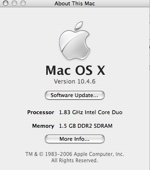

alrigh ti took both ram out of the slots, i put the 512 in the top and pushed in as far as possible, then i put the gig in the bottom and pushed it in as far as possible. and it read both of them [: thank you.
Good just go in SP a bit farther and make sure both slots say the RAM is okay (just to double check 😉 ) as it looks good so far 🙂
i went in and everythign sais ok 😀
