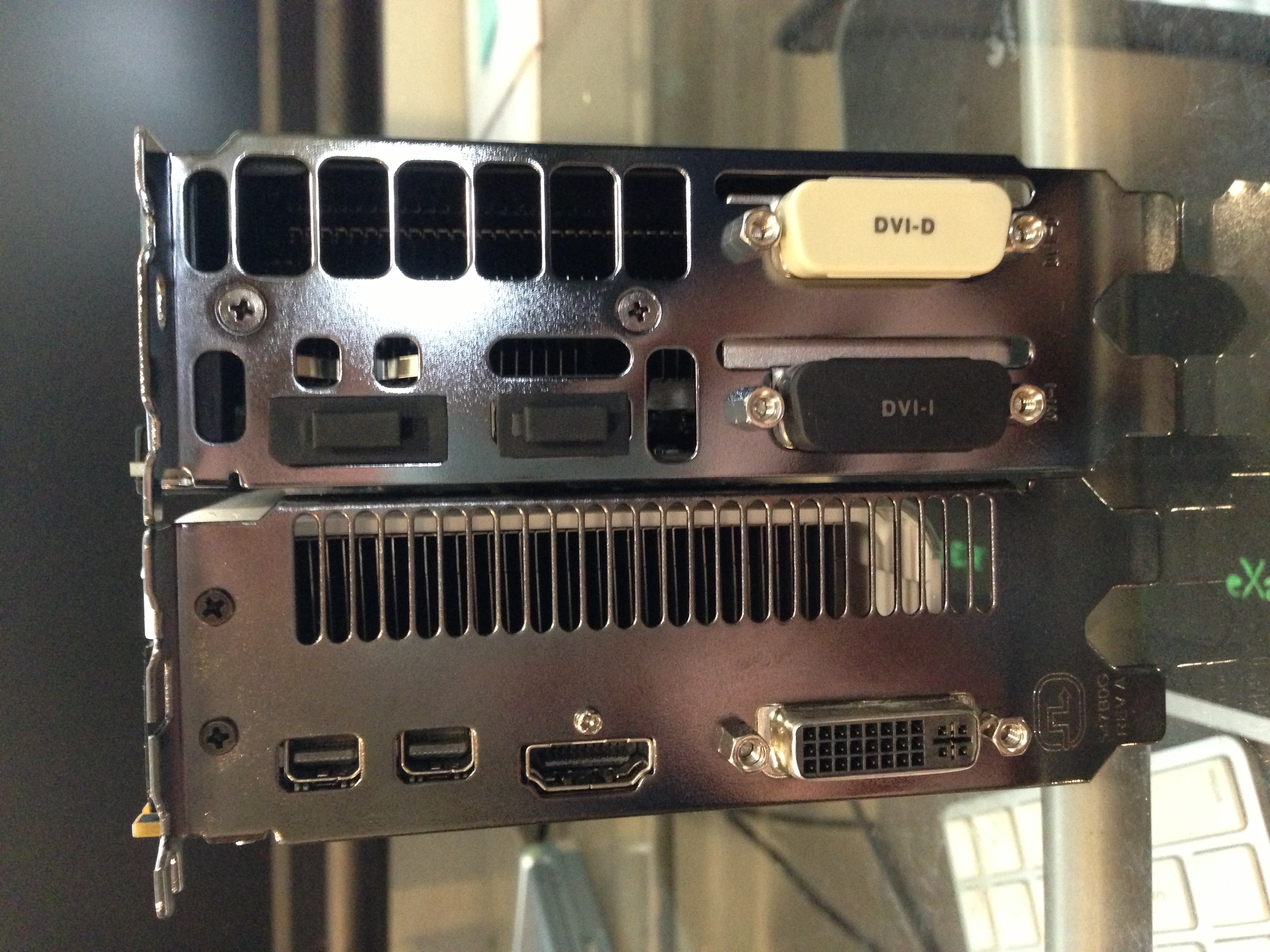

This is after just a day of usage.
Pros: Very fast and very quiet. Amazing performance compared to the old mac 5870 and the 7950 for gaming. A very worthy upgrade specially for starcraft 2 and diablo
Cons: Price. It is pricey but cheaper then the mac 5870 considering performance. Unless you need OpenCL
Other thoughts, I havent noticed any stutter like I did with the AMD cards.
Also it shows video in 10.6 but no drivers so you cant switch resolutions and screen capture does not work just like the 7950.
I think this card is nicer to install then the Mac 5870 since it does not have the bracket on it. Since thats not there you do not have to shoe horn it in like the 5870.
I have a Mac Pro 5,1 2.8ghz single quad, with an OWC accelsior SSD. I have had a 5870 pretty much since it first came out for the Mac. I have also had the 5770 as well so I know what im talking about with all 4 cards.
The 5770 is a good card but if you game you wanted the 5870 it was double the performance.
The 7950 while is not the same placeholder in the current lineup as the 5870 was in the 5XXX series of cards, it is a close contender.
The 680 is the top end single GPU card from nvidia unless you want to the titan.
Another thing I want to mention is that I really like having a boot screen. So that was another reason I chose the GTX 680 mac edition.
