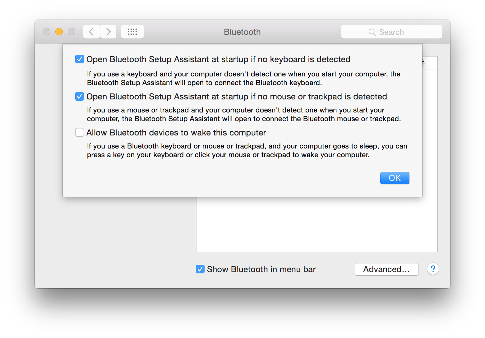

Can also go to Bluetooth advanced setting and turn off "Allow Bluetooth devices to wake this computer"

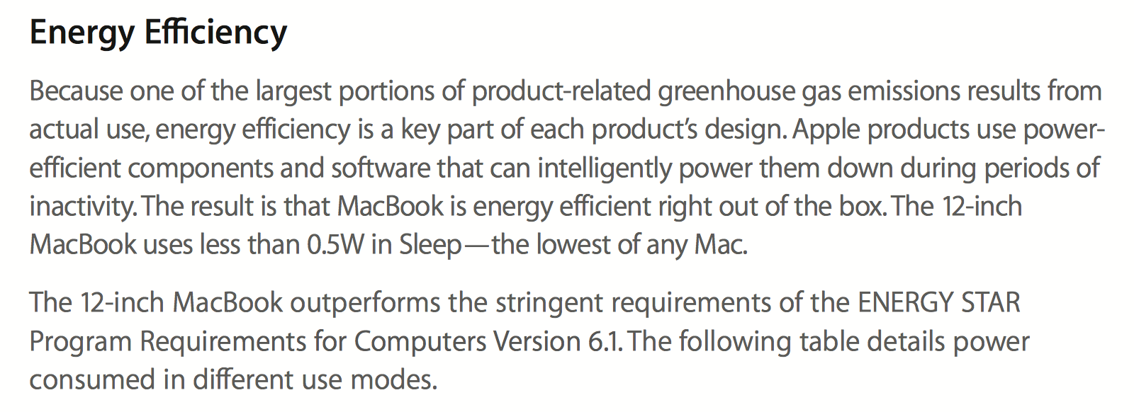

As Apple don't openly publish the wake up codes, it`s not straightforward to point in a specific direction;
RTC (Alarm) is generally related to either predetermined wake/sleep or more likely the transitioning from one sleep state to another (system was probably on mains supply at the time). It can also be from a launchd setting, user applications, backups, and other scheduled events.
EC.ACDetach (Maintenance) is related to the mains power supply state changing
Apple`s sleep profiles are rather complex with two differing regimes dependent on if the system is on main supply, each with multiple levels of sleep/hibernation. On battery the function is obvious to conserve battery power. On mains mains supply less so, as the behaviour is a component of Apples portables complying to an EU directive for energy efficiency for compliance to apply for certification etc (I believe).
The way OS X handles all this can be tailored, equally Apple have obviously put a lot of thought to ensure the best performance across all usage scenarios. Any changes require knowledge of Terminal & the pmset command.
