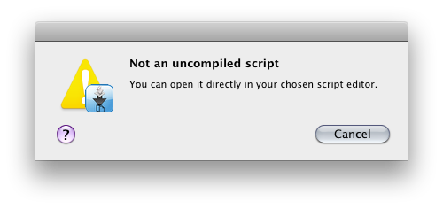

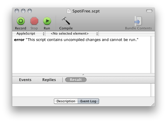

Post the code of your script. I get an error eg error "This script contains uncompiled changes and cannot be run." when trying to open it. I'm running Snow Leopard. The Read My Scripts utility found at this link http://www.macosxautomation.com/applescript/apps/readmyscripts.html says it's Not an uncompiled script.
